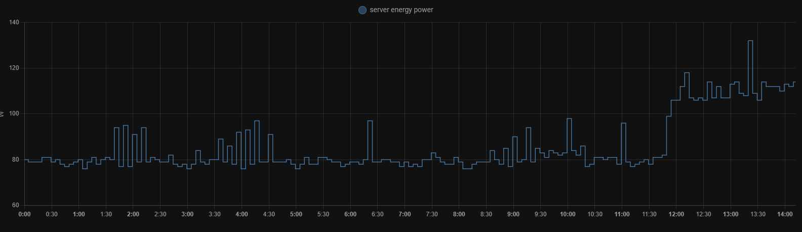

I can see that the server has a peak at power consumption in that time it happened. It "frozen" at 13:25 - 13:30

I checked the settings and changed from "Auto" to "typical current idle". After using a VM for several hours, unraid "freezes" again.

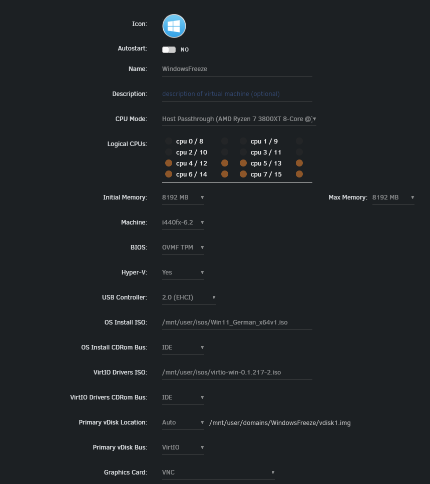

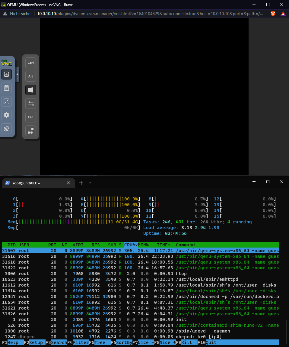

This time I see the VM (newly created Windows 11, nothing changed but windows updates) is not responsive after est. 2 hours idling.
image.thumb.png.d720905274e8ccf9122834db6a2e5b12.pngimage.png.6efee86aec4026e9f0937e621f03e8cf.png

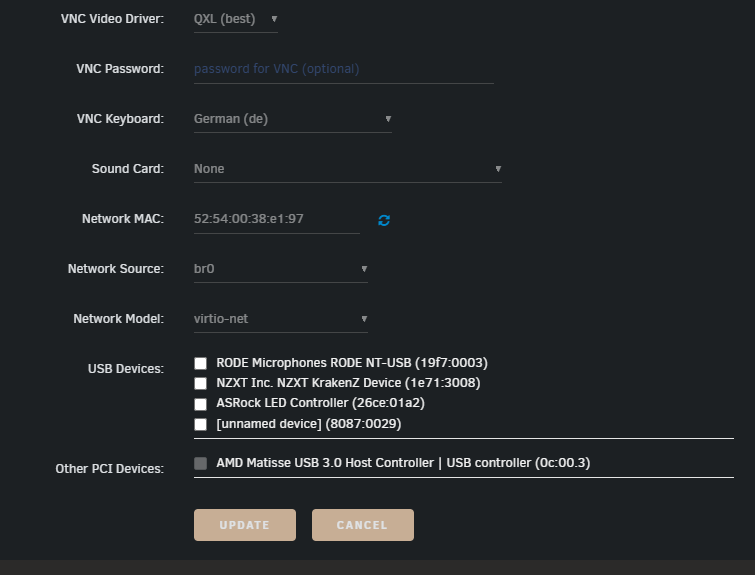

Settings VM:
image.thumb.png.95b66e6b28cdd2112e273cc1cf33aa08.pngimage.png.48e11c8b0fc0ecce61e309e0e3bb80cd.png
Now I'm pretty sure, that this problem does only occurs using a VM. Unraid was running for 3 days without using a VM and nothing bad happened. Every time I start a machine, after 1 or 2 hours the server is not responsive. Just pingable.

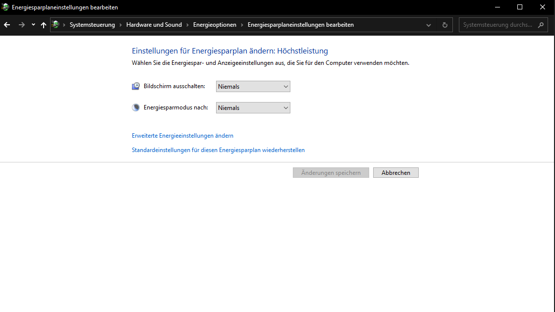

Do I have to check the "Energy saving" options from Windows? (Both options are on "never")

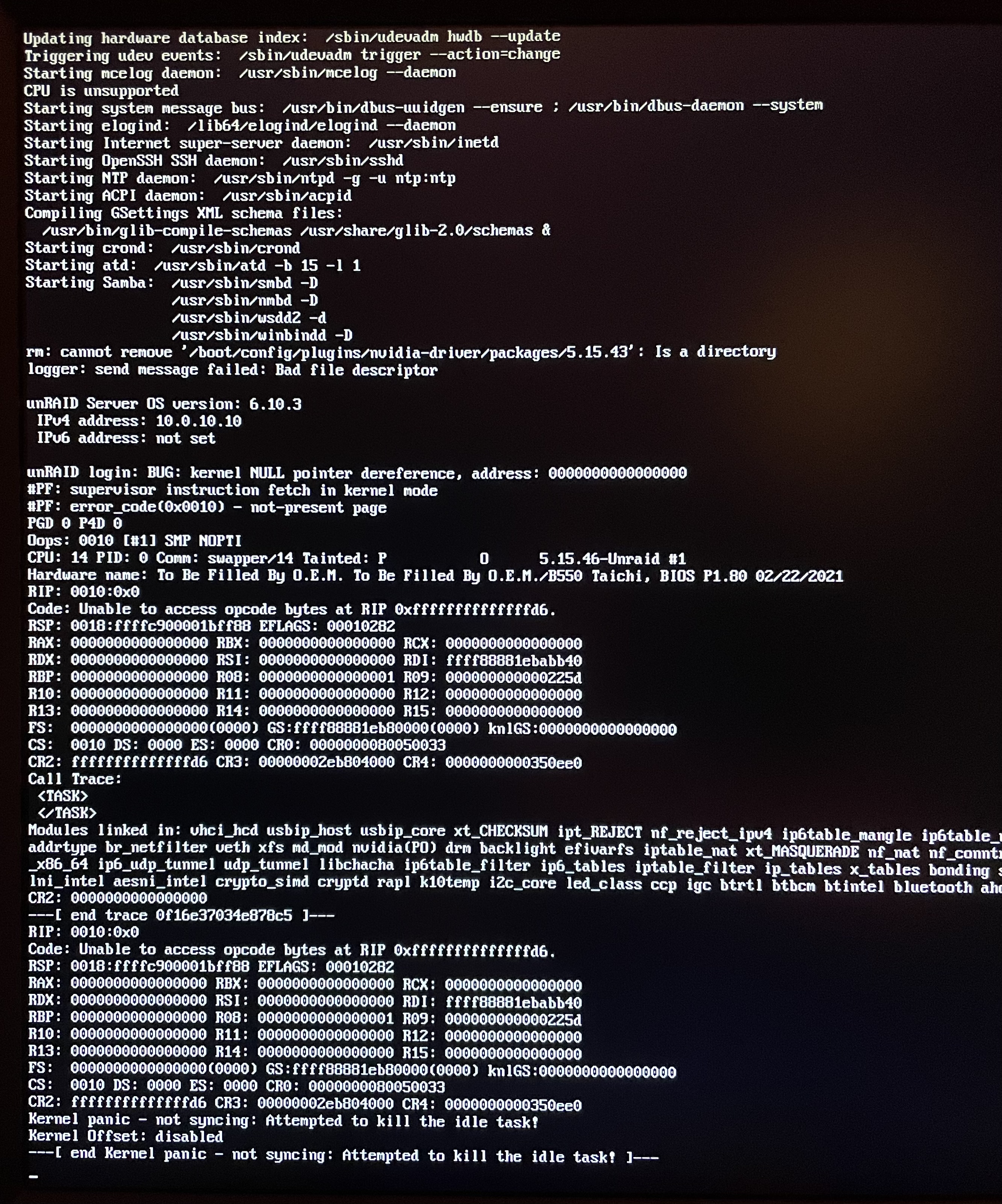

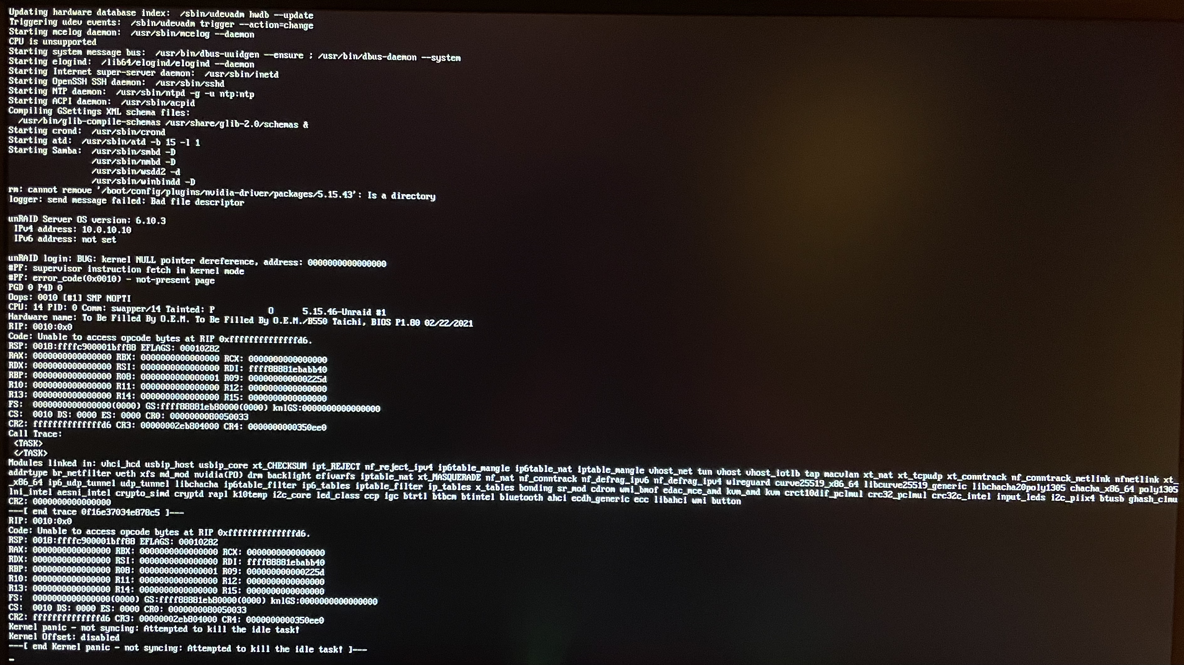

So I updated to 6.10.3 again, took the IOMMU Groups back to Unraid, started a VM without any connected hardware device and it froze again.
After checking the monitor I saw a Kernel Panic happened. So I couldn't check the diagnostics or "disk free" (df -h).

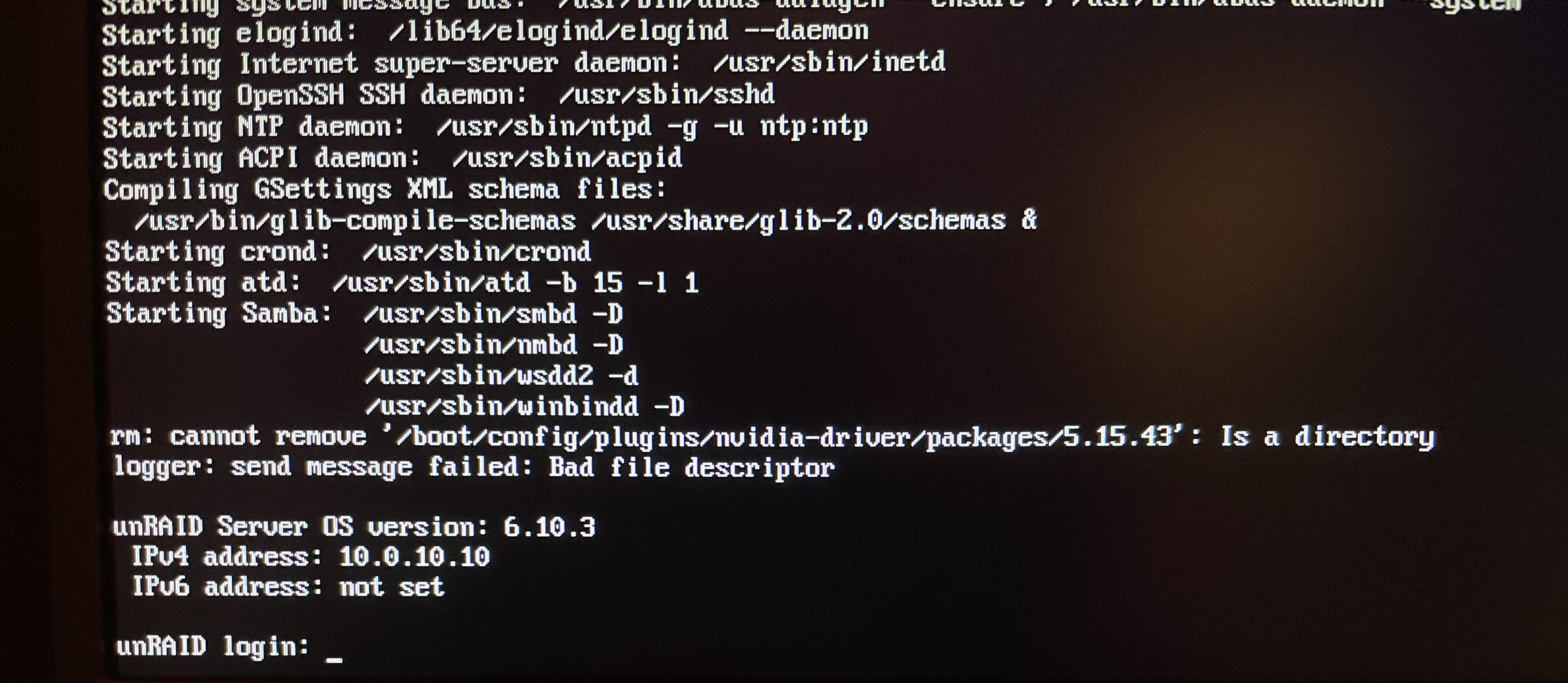

After starting Unraid, this messages showed up:

Everytime I use the VM for an hour, happens a kernel panic in unraid. So there is no chance to check anything after that.

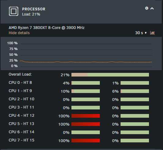

After disabling Docker and starting the VM the CPU goes on some CPU Threads on 100 %. (Windows 11 fresh install)

Sep  7 15:08:57 unRAID kernel: BUG: kernel NULL pointer dereference, address: 000000000000009c
Sep  7 15:08:57 unRAID kernel: #PF: supervisor read access in kernel mode
Sep  7 15:08:57 unRAID kernel: #PF: error_code(0x0000) - not-present page
Sep  7 15:08:57 unRAID kernel: PGD 0 P4D 0
Sep  7 15:08:57 unRAID kernel: Oops: 0000 [#1] PREEMPT SMP NOPTI
Sep  7 15:08:57 unRAID kernel: CPU: 6 PID: 0 Comm: swapper/6 Tainted: P        W  O      5.19.3-Unraid #1
Sep  7 15:08:57 unRAID kernel: Hardware name: To Be Filled By O.E.M. To Be Filled By O.E.M./B550 Taichi, BIOS P1.80 02/22/2021
Sep  7 15:08:57 unRAID kernel: RIP: 0010:update_cfs_rq_load_avg+0x22/0x189
Sep  7 15:08:57 unRAID kernel: Code: 43 80 5b e9 c2 b3 96 00 41 57 41 56 41 55 41 54 55 48 89 fd 53 48 89 f3 41 51 44 8b a6 c4 00 00 00 45 85 e4 0f 84 49 01 00 00 <8b> 86 9c 00 00 00 48 8d be c0 00 00 00 48 89 3c 24 44 8d a8 7e b6
Sep  7 15:08:57 unRAID kernel: RSP: 0018:ffffc90000187e90 EFLAGS: 00010006
Sep  7 15:08:57 unRAID kernel: RAX: ffff8881022c4f0f RBX: ffff88881e9abfc0 RCX: ffff88881e9aca28
Sep  7 15:08:57 unRAID kernel: RDX: ffff88881e9aca28 RSI: 0000000000000000 RDI: ffff88881e9abfc0
Sep  7 15:08:57 unRAID kernel: RBP: ffff8881022c4ec0 R08: 0000000000000000 R09: ffff88881e99f0e0
Sep  7 15:08:57 unRAID kernel: R10: 0000000000000003 R11: 0000000000000000 R12: ffff888100906e40
Sep  7 15:08:57 unRAID kernel: R13: 0000000000000000 R14: 0000000000000000 R15: ffffc90000187ed8
Sep  7 15:08:57 unRAID kernel: FS:  0000000000000000(0000) GS:ffff88881e980000(0000) knlGS:0000000000000000
Sep  7 15:08:57 unRAID kernel: CS:  0010 DS: 0000 ES: 0000 CR0: 0000000080050033
Sep  7 15:08:57 unRAID kernel: CR2: 000000000000009c CR3: 00000004b0bb8000 CR4: 0000000000350ee0
Sep  7 15:08:57 unRAID kernel: Call Trace:
Sep  7 15:08:57 unRAID kernel: <TASK>
Sep  7 15:08:57 unRAID kernel: ? __schedule+0x1ba/0x5f6
Sep  7 15:08:57 unRAID kernel: ? schedule_idle+0x27/0x34
Sep  7 15:08:57 unRAID kernel: ? cpu_startup_entry+0x1d/0x1f
Sep  7 15:08:57 unRAID kernel: ? start_secondary+0xeb/0xeb
Sep  7 15:08:57 unRAID kernel: ? secondary_startup_64_no_verify+0xce/0xdb
Sep  7 15:08:57 unRAID kernel: </TASK>
Sep  7 15:08:57 unRAID kernel: Modules linked in: xt_CHECKSUM xt_conntrack ipt_REJECT nf_reject_ipv4 xt_tcpudp ip6table_mangle ip6table_nat iptable_mangle vhost_net tun vhost vhost_iotlb tap vhci_hcd usbip_host usbip_core xfs md_mod efivarfs iptable_nat xt_MASQUERADE nf_nat nf_conntrack nf_defrag_ipv6 nf_defrag_ipv4 wireguard curve25519_x86_64 libcurve25519_generic libchacha20poly1305 chacha_x86_64 poly1305_x86_64 ip6_udp_tunnel udp_tunnel libchacha ip6table_filter ip6_tables iptable_filter ip_tables x_tables af_packet 8021q garp mrp bridge stp llc bonding tls ipv6 nvidia_drm(PO) nvidia_modeset(PO) nvidia(PO) drm_kms_helper drm btusb sr_mod btrtl cdrom btbcm kvm_amd kvm crct10dif_pclmul crc32_pclmul crc32c_intel wmi_bmof ghash_clmulni_intel aesni_intel crypto_simd btintel cryptd i2c_piix4 backlight rapl bluetooth ccp k10temp i2c_core igc syscopyarea sysfillrect ahci sysimgblt fb_sys_fops joydev libahci ecdh_generic ecc wmi button unix
Sep  7 15:08:57 unRAID kernel: ---[ end trace 0000000000000000 ]---
Sep  7 15:08:57 unRAID kernel: xhci_hcd 0000:01:00.0: xHCI host not responding to stop endpoint command
Sep  7 15:08:57 unRAID kernel: xhci_hcd 0000:01:00.0: xHCI host controller not responding, assume dead
Sep  7 15:08:57 unRAID kernel: xhci_hcd 0000:01:00.0: HC died; cleaning up
Sep  7 15:08:57 unRAID kernel: usb 1-3: USB disconnect, device number 2
Sep  7 15:08:57 unRAID kernel: usb 1-5: USB disconnect, device number 3
Sep  7 15:08:57 unRAID kernel: sd 0:0:0:0: [sda] tag#0 UNKNOWN(0x2003) Result: hostbyte=0x07 driverbyte=DRIVER_OK cmd_age=0s
Sep  7 15:08:57 unRAID kernel: sd 0:0:0:0: [sda] tag#0 CDB: opcode=0x2a 2a 00 01 3d 9c 92 00 00 01 00
Sep  7 15:08:57 unRAID kernel: I/O error, dev sda, sector 20814994 op 0x1:(WRITE) flags 0x800 phys_seg 1 prio class 0
Sep  7 15:08:58 unRAID kernel: sd 0:0:0:0: [sda] tag#0 UNKNOWN(0x2003) Result: hostbyte=0x07 driverbyte=DRIVER_OK cmd_age=0s
Sep  7 15:08:58 unRAID kernel: sd 0:0:0:0: [sda] tag#0 CDB: opcode=0x2a 2a 00 00 00 08 01 00 00 01 00
Sep  7 15:08:58 unRAID kernel: I/O error, dev sda, sector 2049 op 0x1:(WRITE) flags 0x0 phys_seg 1 prio class 0

I am thinking of creating a backup and reinstalling Unraid on the stick...
Is there anything to consider before I do this? For example, the layout of the hard drives or saving the docker templates?
syslog unraid-diagnostics-20220907-1336.zip
I suspect that the problem is with the array itself.
The system does not freeze when docker is completely off. The system freezes depending on which container is on.
Using the VM under /mnt/user/domains/ causes problems, freezes the VM or Unraid itself. Under /mnt/cache/domains/ I have not noticed any of the mentioned problems.
I have performed a RAM check again which was successful. Also a Read-Check. I also checked the S.M.A.R.T. values and everything looks fine there. Do I have to rsync all the data and move it back or is there an easy way to solve the problem?
1 hard disk for cache (pool) and one disk 1 (array).
And one of my windows disks the partition layout is broken. It is only recognized as RAW. Does anyone know how I can fix this?
Try testdisk in Windows.
After creating a Windows 11 VM and attaching the corrupted Harddrive it detected, the Problem was found during boot by the OS and repaired it.
Now I only have to get the persmissions for my Harddrive. I only can list the files in powershell as a administrator. Explorer says the permissions are missing. Using explorer as admin doesnt change anything.
Still, I have to repair the array. Is there something that I can use in Unraid to fix this problem. Setting permissions or moving the files? Or do I have delete everything and building up the array from beginning?
