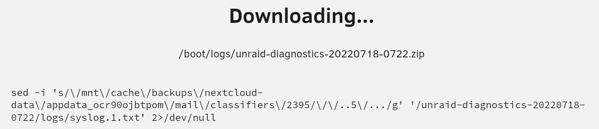

July 18, 20224 yr Community Expert Diagnostics attached. - I had my first parity check scheduled to run during the night, starting at 1am and running for 6 hours, then continuing over the next days (mostly to check the scheduling function). It started at 1am as intended, at 7am the log contains a Jul 18 07:00:01 Unraid kernel: mdcmd (162): cmdCheckPause but this had no effect, the check went on until I paused it myself half an hour later, the command in the log is different: Jul 18 07:27:13 Unraid kernel: mdcmd (163): nocheck pause - The syslog is full of lsof segfaults every 20 seconds last night. The period during which this happens seems to conincide with the machine providing the "KILRAH_unraidbackup" smb mount in unassigned devices being unavailable. Hasn't been a problem before, and a segfault seems like an issue that shouldn't happen regardless... Jul 18 07:22:09 Unraid kernel: traps: lsof[2641] general protection fault ip:14e6681a66ae sp:24782f2d8f6e5f77 error:0 in libc-2.33.so[14e66818d000+15e000] Jul 18 07:22:29 Unraid kernel: traps: lsof[3152] general protection fault ip:146379ec66ae sp:a2ecf1f39630b6e6 error:0 in libc-2.33.so[146379ead000+15e000] Jul 18 07:22:49 Unraid kernel: traps: lsof[3981] general protection fault ip:151f2c46a6ae sp:f5db90ca427d645b error:0 in libc-2.33.so[151f2c451000+15e000] Jul 18 07:23:09 Unraid kernel: traps: lsof[4867] general protection fault ip:14c2c62b26ae sp:dc115d8693ddf67e error:0 in libc-2.33.so[14c2c6299000+15e000] - When downloading diagnostics it is for quite a while going over a list of files that don't exist, they used to but were deleted a few days ago. How would it still know about them? The only thing that's in this folder is a tar right now, and it doesn't even contain such files. Edited June 7, 20242 yr by Kilrah
