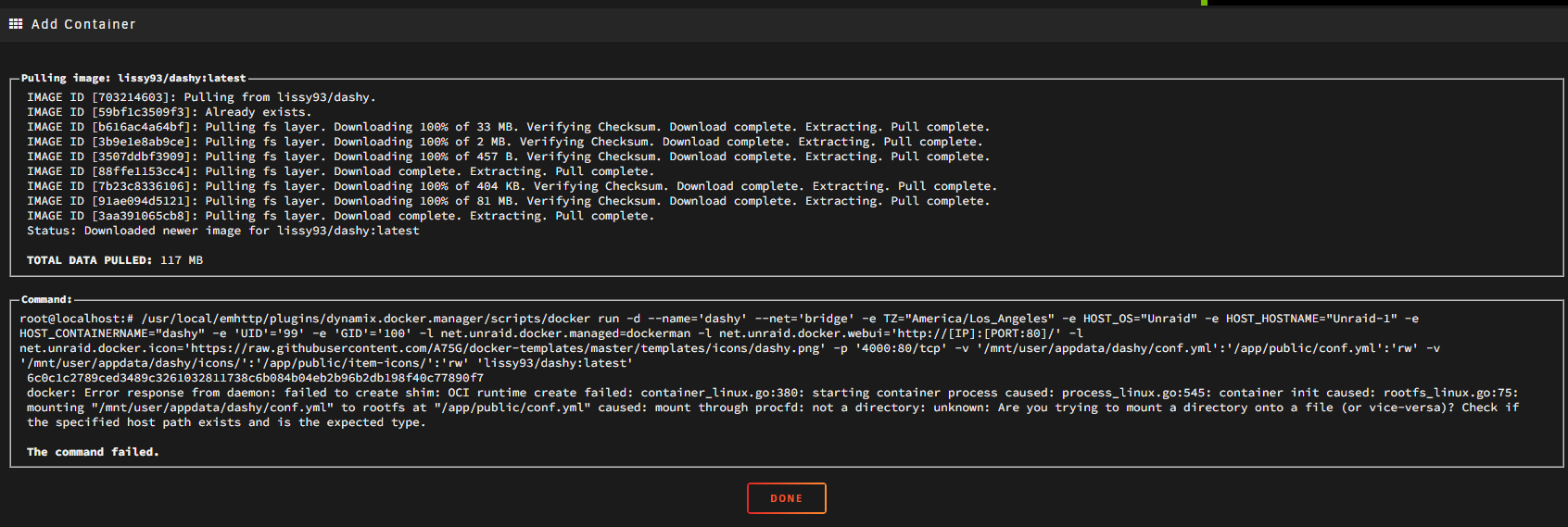

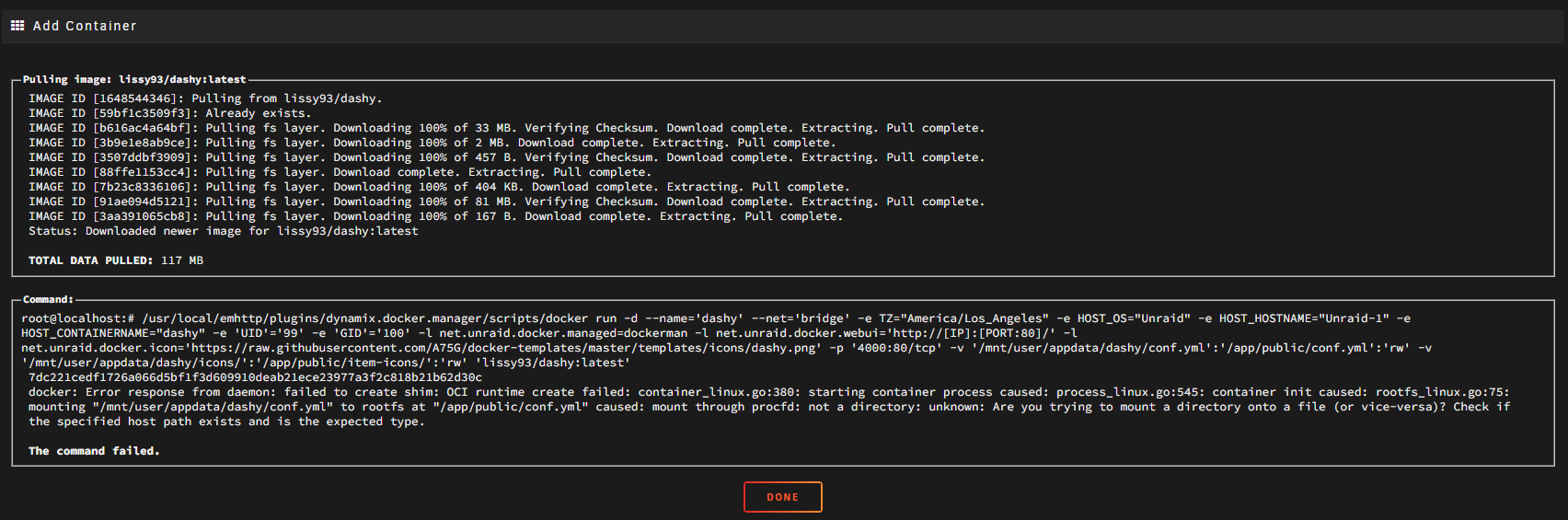

July 22, 20224 yr I recently had Dashy installed as a Docker container and all was well. I messed with it for a couple of days until it was all dorked up. I then decided to start over and remove it and the re-install it. Now, every time I try to install it, I get this error: docker: Error response from daemon: failed to create shim: OCI runtime create failed: container_linux.go:380: starting container process caused: process_linux.go:545: container init caused: rootfs_linux.go:75: mounting "/mnt/user/appdata/dashy/conf.yml" to rootfs at "/app/public/conf.yml" caused: mount through procfd: not a directory: unknown: Are you trying to mount a directory onto a file (or vice-versa)? Check if the specified host path exists and is the expected type. I have tried every Google hit I got on this topic to no avail. Can some one please point me in the right direction to fix this? v/r Jon

July 24, 20224 yr Community Expert Looks like you are trying to map a container file to a host file and that seems to be what the error is telling you. You need to map the folders the file is in.

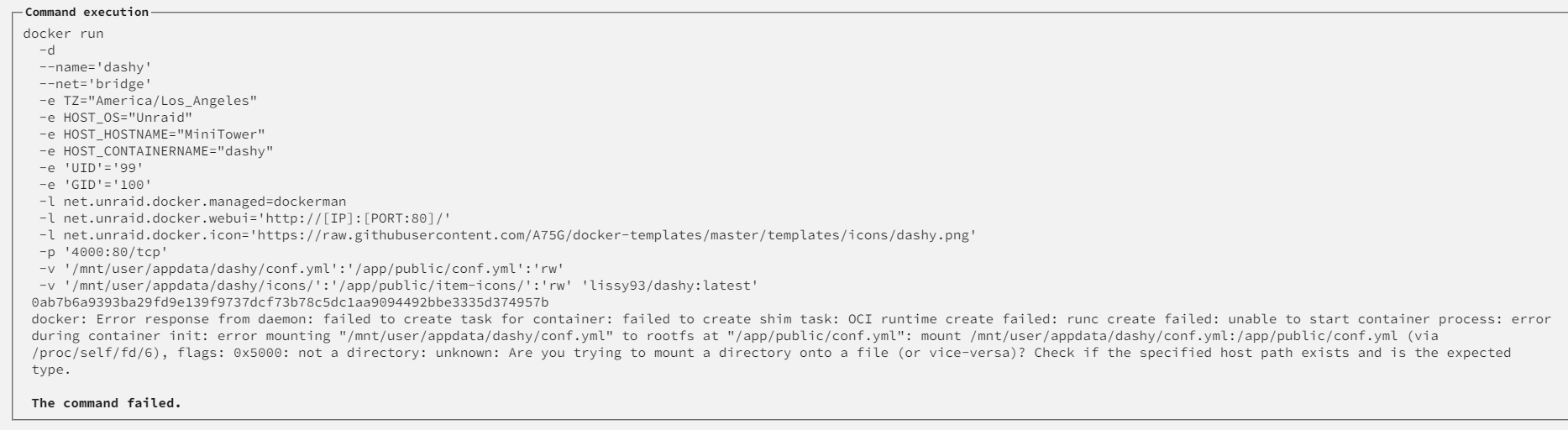

July 25, 20224 yr Author So I deleted my-dashy.xml from /boot/config/plugins/dockerMan/templates-user, verified that the app was unistalled, manually deleted user/appdata/dashy, ran the Appdata Cleanup utility, and tried to install dashy again, only to get the same error:
July 25, 20224 yr Community Expert Solution Just had a look at that particular container and it seems you simply didn't follow the instructions in the app description. Quote Dashy helps you organize your self-hosted services, by making them all accessible from a single place. -Before you start CLI unraid mkdir /mnt/user/appdata/dashy/ wget -O /mnt/user/appdata/dashy/conf.yml https://raw.githubusercontent.com/Lissy93/dashy/master/public/conf.yml -Edit conf.yml Edited July 25, 20224 yr by Kilrah
July 25, 20224 yr Author Ahh... RTFM bites me again So it appears the biggest issue is that when the package gets installed it creates a directory name conf.yml instead of a file names conf.yml. I had to remove that directory and then wget thew conf.yml from the URL in the notes.
July 25, 20224 yr Community Expert Correct, when you specify a mount point in Docker it assumes it's a directory and will create it if it doesn't exist, if you want it to point to a file it has to be there first.
