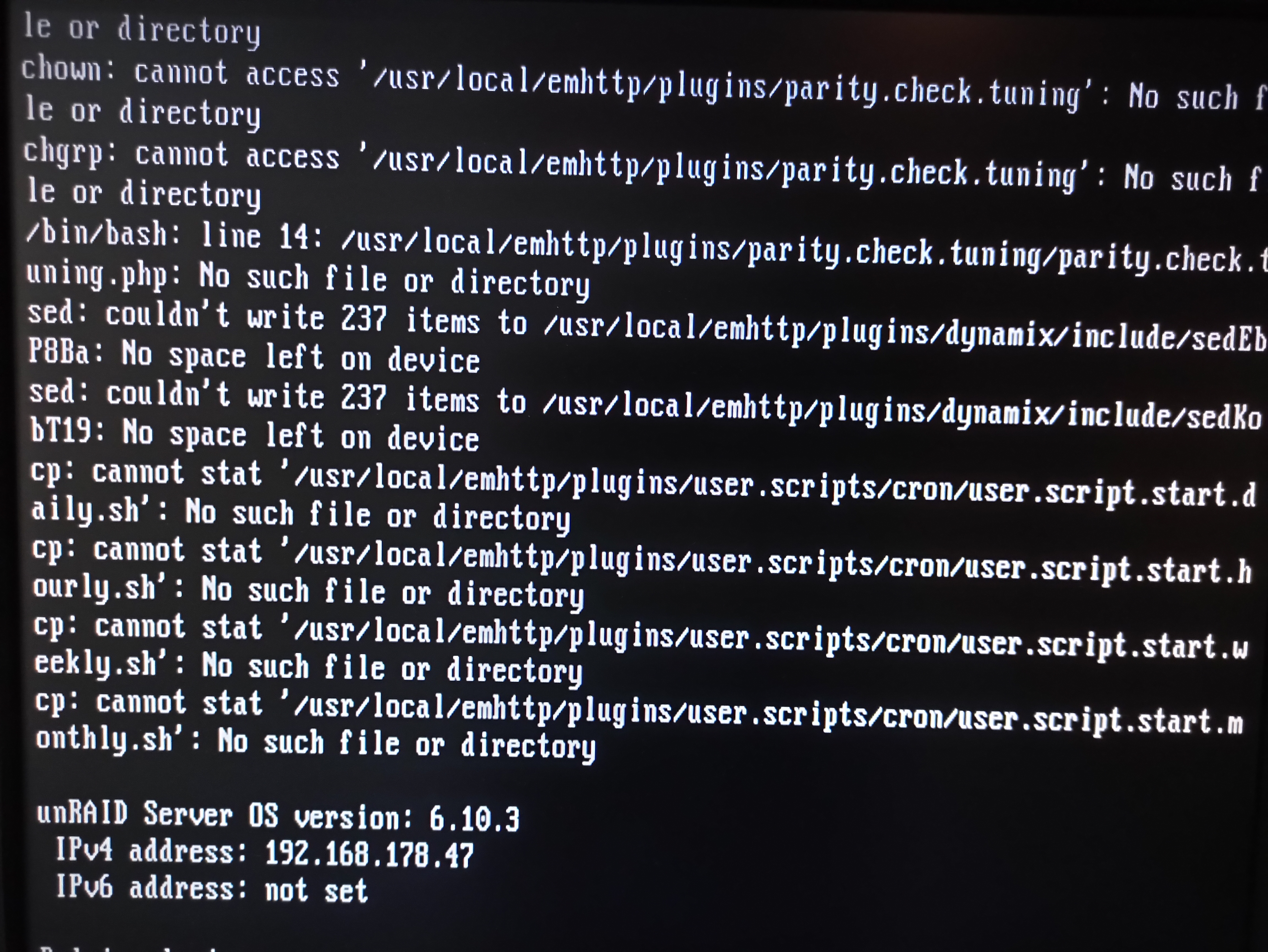

July 25, 20224 yr After testing Unraid for a while (still in trial), I restarted my server today normally and got the error messages "No such file or directory" on the monitor connected to the server. I can't access the WebUI, so I can't get any diagnostics. In safe mode, I can only see that about half of my plugins failed, but I can't understand why because they were running just fine. My server is a Dell Precision T3500 with only 2 GB of RAM (I know that's not enough, but it worked). And my flash is 1 GB. I was planning to replace my flash drive with a 16 GB drive once I got a licence.

July 25, 20224 yr Solution You're trying to run a load of plugins - they are reported as corrupt .tar files - perhaps due to lack of RAM when trying to unpack them. You are running and trying to install just about every option from the Nerdpack - that will be taking a chunk of space. They idea of Nerdpack is to only enable the features actually required. After that is installed just about everything else has problems. If you look through the text file yourself you can see this. I still think this is primarily a lack of RAM. Certainly I would not expect to run any plugins reliably when you have only half the recommended minimum RAM available. First thing I would try is to borrow a bit more RAM from somewhere just to see if that helps - and uninstall Nerdpack, or at least limit the modules that you are enabling. Edited July 25, 20224 yr by S80_UK
July 25, 20224 yr Author Just now, S80_UK said: You're trying to run a load of plugins - they are reported as corrupt .tar files - perhaps due to lack of RAM when truing to unpack them. You are running and trying to install just about every option from the Nerdpack - that will be taking a chunk of space. They idea of Nerdpack is to only enable the features actually required. After that is installed just about everything else has problems. If you look through the text file yourself you can see this, so I still think this is primarily a lack of RAM. Certainly I would not expect to run any plugins reliably when you have only half the recommended minimum RAM available. First thing I would try is to borrow a bit more RAM from somewhere just to see if that helps. I am already looking for some. I know someone who might have lots of DDR3 ECC RAM... Thank you for the quick replies. I will report here what happens after I got new RAM.

July 25, 20224 yr Author @S80_UK You were right! I t is just not enough RAM / Nerd Pack overloaded it. Runs fine now with ~80 % RAM used. Thanks again!
