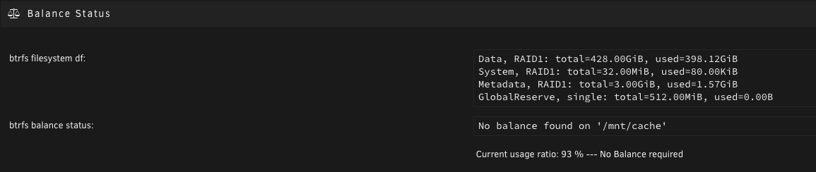

July 30, 20224 yr Author Thanks just to confirm are you referring to this? I saw that and it said Data, RAID1: total=428.00GiB, used=398.12GiB, so with those size indicators, I thought that it was still only using the old drive as that was the size of it. In this scenario though, all three drives in there now have the same data on them (RAID1) correct? Just trying to understand the working of the cache pool better, thanks!
July 31, 20224 yr Community Expert Yes, that will show the profiles in use, both data and metadata should only be using one profile, and both raid1 in this case. The old device was still part of the pool, doesn't really matter if there's data there or not to remove the device, except for the time it will take, for a more detailed view you can use in the console: btrfs fi usage -T /mnt/cache
