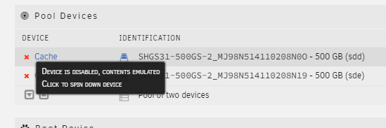

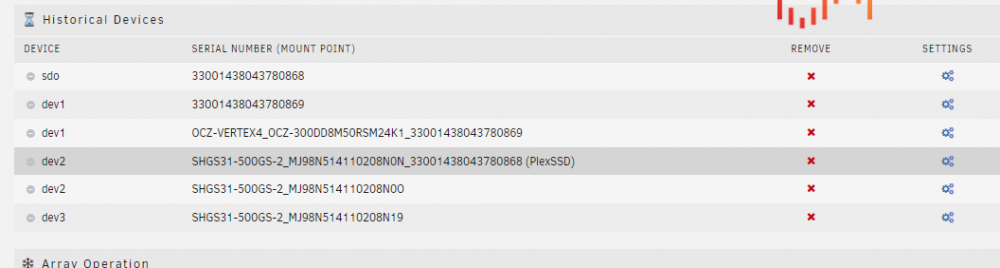

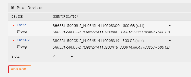

Howdy folks, this has happened to me a few times, never the cache drives though so now im a little more concerned and want to be careful. ive noticed on rare occasions, typically after an update of some kind i will boot up unraid and my disks will not be properly assigned to my array or my unassigned device will be missing, but in its place a new drive will display. it will share a common name but have what looks like a new serial number attached to its name. i managed to rename my plex SSD partition mount point to match what my docker was configured to use and that fixed that issue. i then pointed my VM to its "new device" to attached to its hard drive file and now its working but how do i recover the 2 cache disks? starting the array they become disabled and emulated.

When i hover over the device, it states its disabled and contents emulated.
would you have any suggestion on how i might be able to recover the cache drives?

25 minutes ago, Clayton said:
my main focus at this point is how i can recover the cache drives.
Unassign all pool members, start array, stop array, re-assign all pool members, start array and you're done.
btw, pool is restored after removing the pool members and adding them back in. all is well, thank you for your help!
