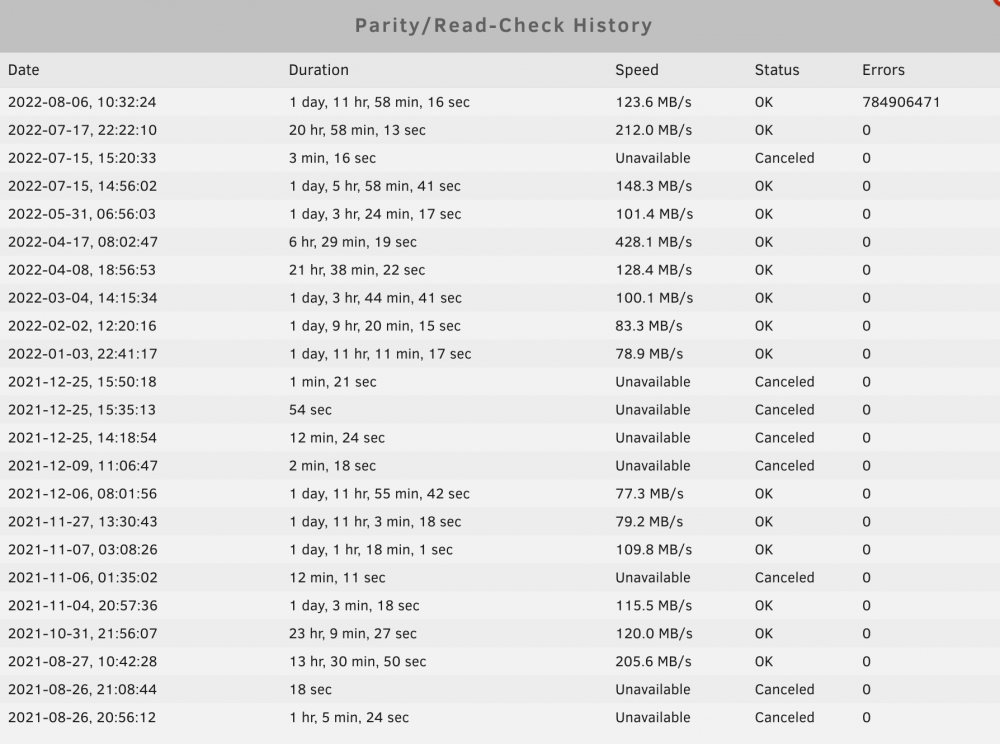

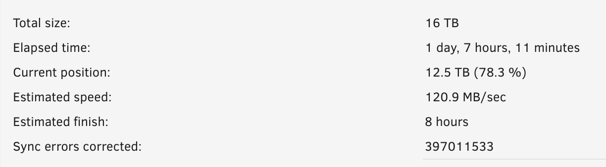

August 7, 20224 yr Had a unclean shutdown a few days ago, performed parity check and got 700m+ errors. Executed the parity check again, while expecting 0 errors, it still split out 400m+ errors at 80%. :( tower-diagnostics-20220807-2248.zip
August 7, 20224 yr Your second result is to be expected because your first one was more than likely a non-correcting check which means that the second one will give the exact same result. The question though is why on the first one you're getting the millions of errors. Did you change drives or anything between 7/17 and 8/6?
August 7, 20224 yr Author 51 minutes ago, Squid said: Your second result is to be expected because your first one was more than likely a non-correcting check which means that the second one will give the exact same result. The question though is why on the first one you're getting the millions of errors. Did you change drives or anything between 7/17 and 8/6? I did added 2 new drives on 7/15, but nothing between 7/17 ~ 8/16.
