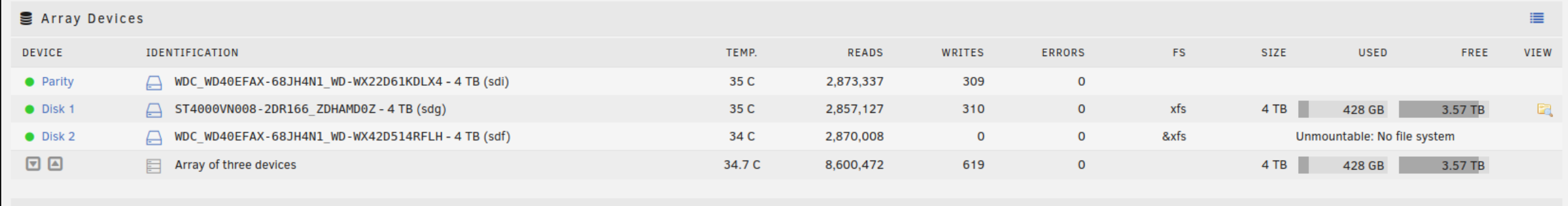

Hey all.
Our server was shut down improperly a while ago, and after some life events, cleaning out the computer case, replacing the CPU Cooler, and booting it back up, I get the message that my Disk 2 (sdf) is "Unmountable: No file system" and under FileSystem, I see "&xfs". See the screenshot I attached.
The server is running a parity check now, and won't be done for about 5 hours from now. I've looked on here before I posted, so I've attached my diagnostics report from UNRAID (v6.9.2).
Also, I'm fairly new to UNRAID, but familiar with Linux and the Command Line. Just point me in the right direction of what to do and how to do it.
Thank you great and knowledgeable people of the Internet.

16 hours ago, trurl said:
Check filesystem on disk2, be sure to capture the output so you can post it.
Okay, I'm a complete noob on this so I'll ask the question: I presume I'll have to stop the array, do a clean shut down, and then boot it up in Safe Mode GUI? Is that correct?
EDIT: I just found out how to enter maintenance mode. My apologies. I'll post the check filesystem once I get it.
Edited by TheGreenWizard
found the answer to my question.
Here's what I got (I did this with -nv):

Run it again without -n, if it asks for -L use it.
It told me to use -L. Here's what it came back with:

Should mount now, then look for a lost+found folder and any data inside.
So I stopped the array, and the started it up again. Still says it's unmountable. I tried doing a reboot of the system as well, and it still has the same message.

So I rebooted the server, and now I'm getting a message on the monitor (connected to the server), that there is no configuration file found and it has "boot:" with a cursor after it.... WTF.
EDIT: I checked the USB stick with UNRAID on it... and I get the error, "Sorry could not display all the contents of "UNRAID": error when getting information for "/media/username/UNRAID/SYSTEMz1": Input/Output error"
When it rains it pours.... gah. Did I royally eff this up?
