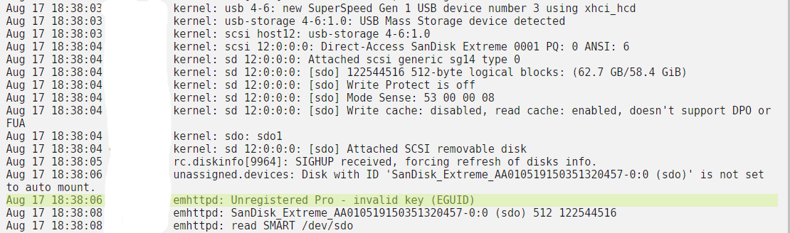

August 17, 20224 yr Hello everyone. I am trying to combine two unraid machienes I have been running. But since Unraid still does not support multiple arrays in a single install, I am trying to run the second unraid in a VM. But when i plug a new unraid USB into the already running system, the USB is not available to be assigned to a VM. As unassigned disks plugin, says the USB is "array" The Log tells me what happens: It seems like the existing unraid picks up the USB unraid, and locks the device, as it now is the active license. The USB i am using is using a new blank unraid 6.10.3 install, until i know if this would work or not. I already own the two unraid pro licenses. The host unraid system is currently running Unraid 6.9.2 I can post diagnostics, but i don't know if that would help anyway.

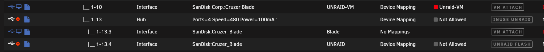

August 17, 20224 yr Author 2 minutes ago, SimonF said: How are you mapping the USB device to the VM? Using the USB Manager shown in the video. I have also tried to assign it using the normal method in the VM settings.

August 17, 20224 yr Community Expert 2 minutes ago, Struck said: Using the USB Manager shown in the video. I have also tried to assign it using the normal method in the VM settings. Are you using ovmf for the bios and have renamed the efi- directory on flash to efi?

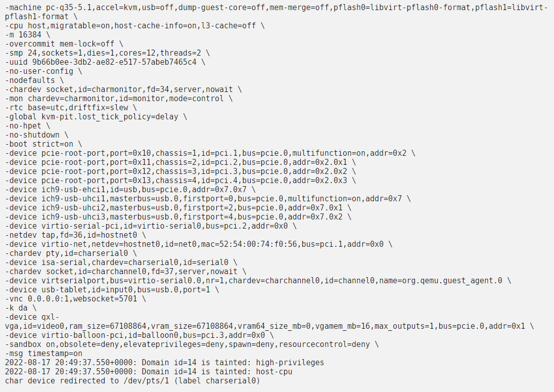

August 17, 20224 yr Author 5 minutes ago, SimonF said: What does the console show? Cant really find anything about the USB in the Logs for the VM: Unraid Host logs tells me this:

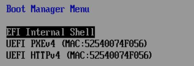

August 17, 20224 yr Community Expert 5 minutes ago, Struck said: Cant really find anything about the USB in the Logs for the VM: Unraid Host logs tells me this: What about the vnc console? does it just show the uefi boot?
August 17, 20224 yr Author 3 minutes ago, SimonF said: What about the vnc console? does it just show the uefi boot?

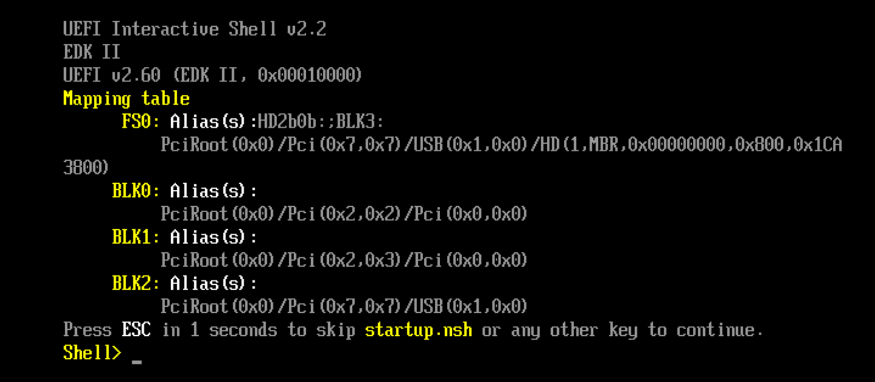

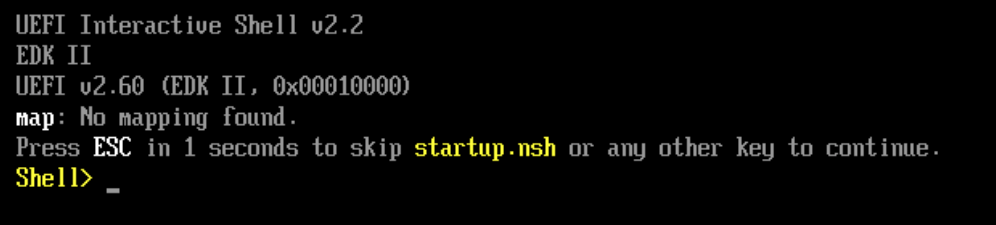

August 17, 20224 yr Community Expert 9 minutes ago, Struck said: Not sure why you are not seeing any devices.
August 18, 20224 yr Author Solution I finally got a breakthrough. I tried many different settings. But when I switched the USB Controller from 2.0 EHCI to 3.0 (qemu XHCI) It suddently appeared as a bootable device I didn't try this earlier, since i expected 2.0 to work better for boot than 3.0. Thanks for all your guys help so far
