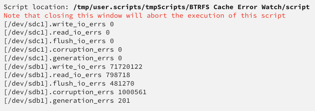

Yes, cache pool errors on one device.
Just moved everything off of the cache to the array, removed the offending disk, formatted and added back to the cache pool. Cache is still empty.
I rebooted and get the errors again.
Bad drive?
Those errors mean that device sdb dropped offline at some point in the past, but before this last boot, to reset the fs errors see here.
