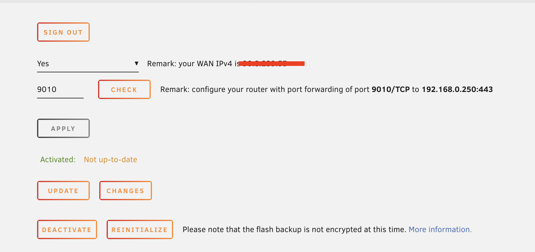

  • On the UDM Pro I have forwarded the 9010 port to the 443 port on the Unraid server.

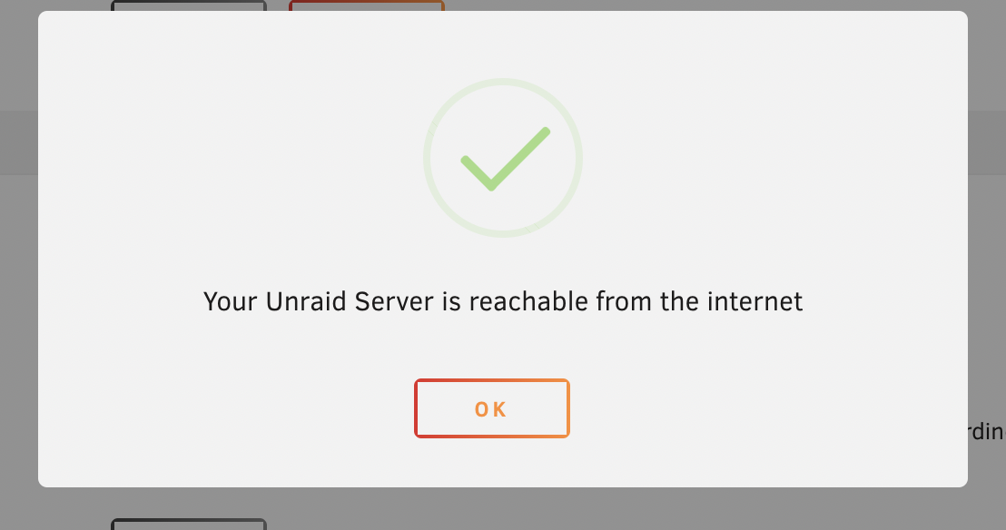

  • When I click on the CHECK wan port, I have a success message

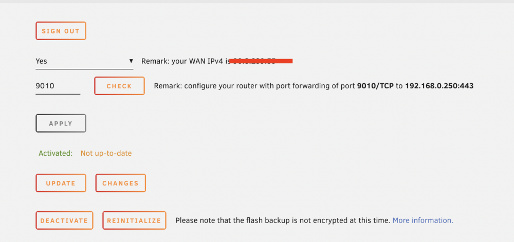

However the Flash backup stays Not up-to-date.
1444567396_Capturedecran2022-08-31a17_52_04.thumb.png.a045c92e0ebcc4ad2db69ae78ae9b0a0.png
I tried to force update, deactivate/reactivate, reinitialize but nothing works.

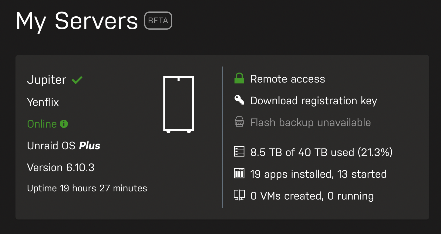

On the Unraid “My Server” page the Flash Backup appears Unavailable.
