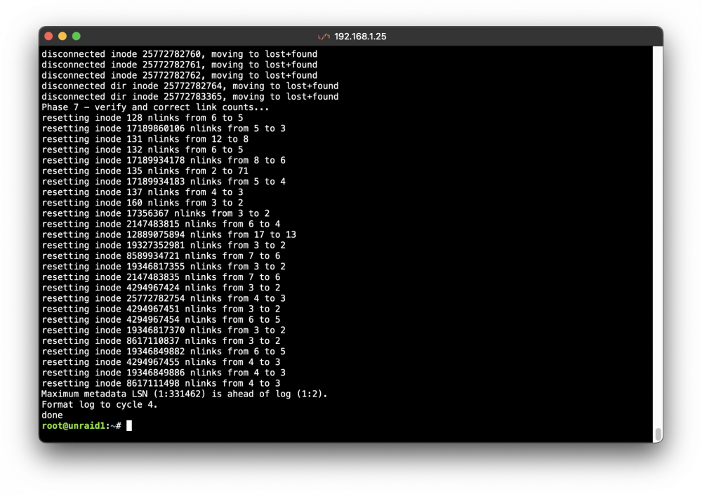

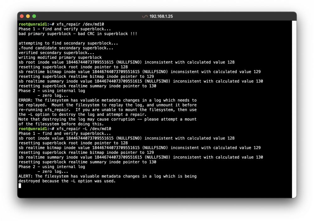

  • OK   At the command line, enter xfs_repair -L /dev/md10 Capture the output and post it

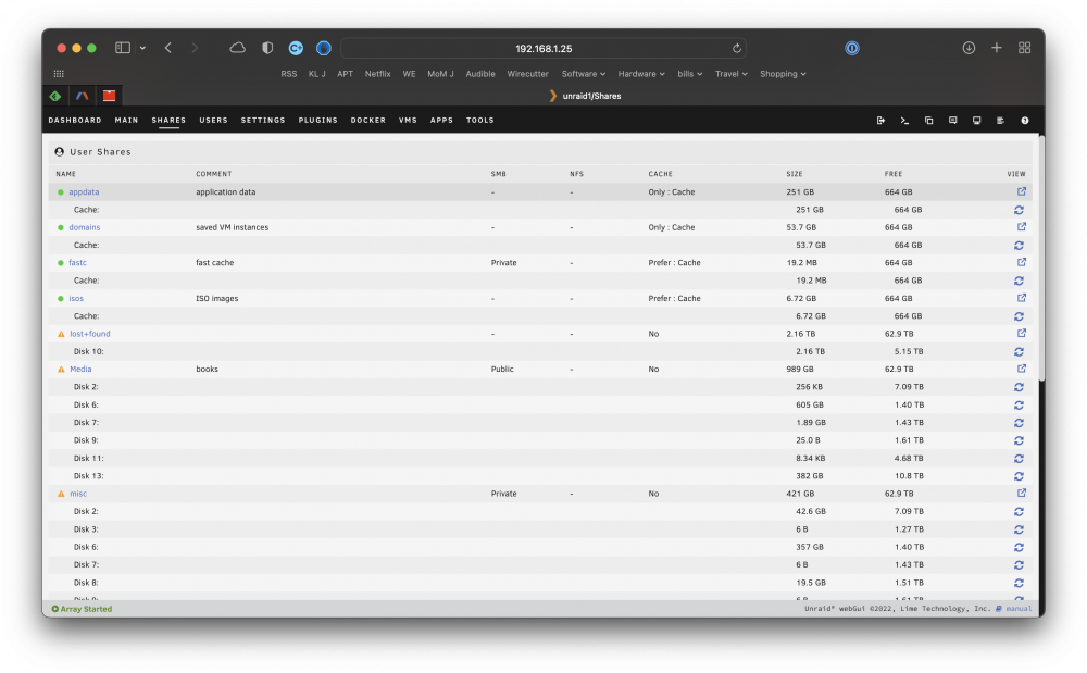

  • Now to see how much confusion there is.   Go to User Shares page, click Compute... for your new lost+found share, wait for the results. Then post a screenshot

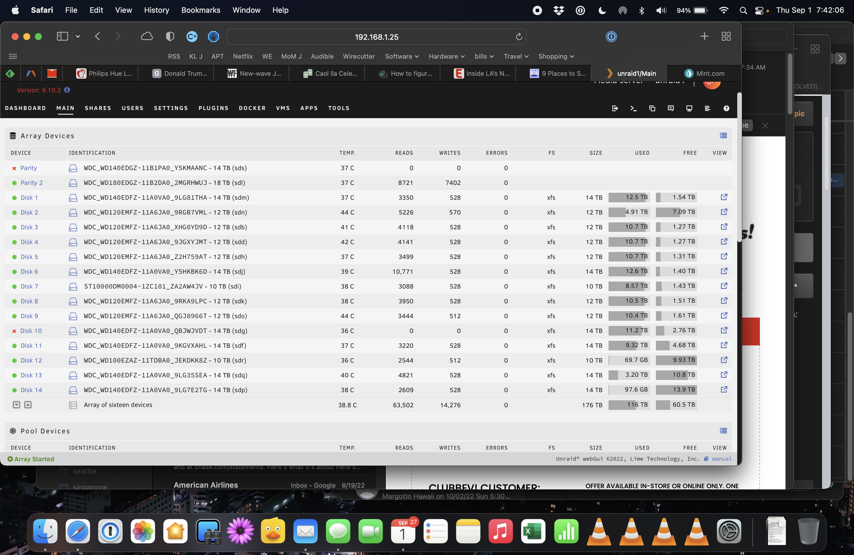

Screenshot is what is was right before replacing the 2 drives.

That screenshot shows disk10 disabled, emulated disk10 was mounted and had 11+TB
Now that you have formatted it that data is gone.

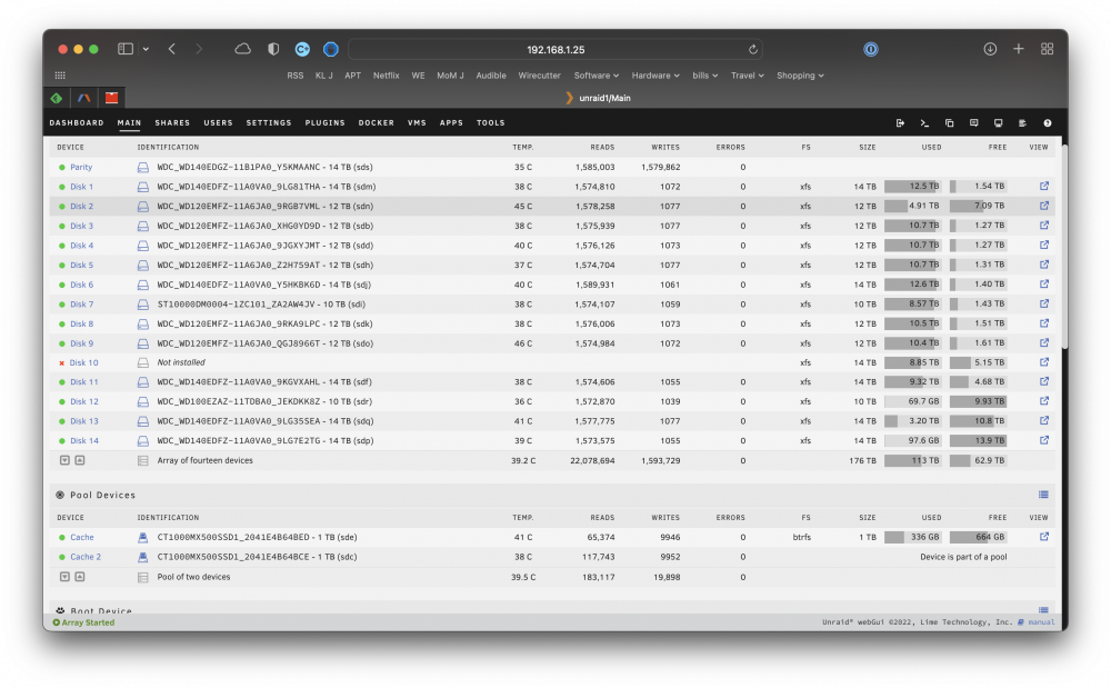

Looks like parity and disk10 aren't assigned. Post a screenshot of Array Devices, and another screenshot of Unassigned Devices. Be sure to include the full width.

Here is the current setup. I remove the new 16 tb drives
unraid1:Main.pdf
I was hoping to see everything with the array started, and whatever wasn't assigned in Unassigned Devices. What are those disks showing in Unassigned Devices?
But that's OK. Don't start the array now.  Has anything been written to your array since all this started?
The unassigned devices are the original drives.
