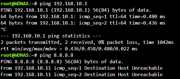

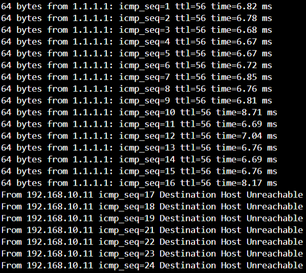

pinging the internet fails: Destination Host Unreachable  (first and second jpg)

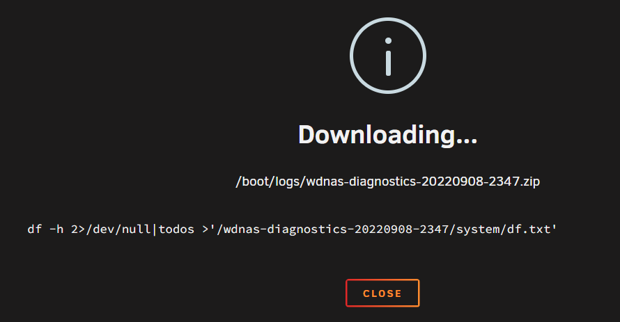

Please help me because I can't directly generate diagnostics either (keeps stuck on this screen:third jpg)
/boot/log is still the generation of diagnostics
