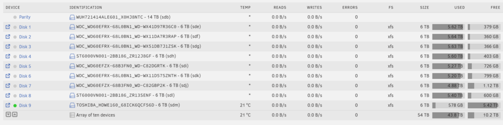

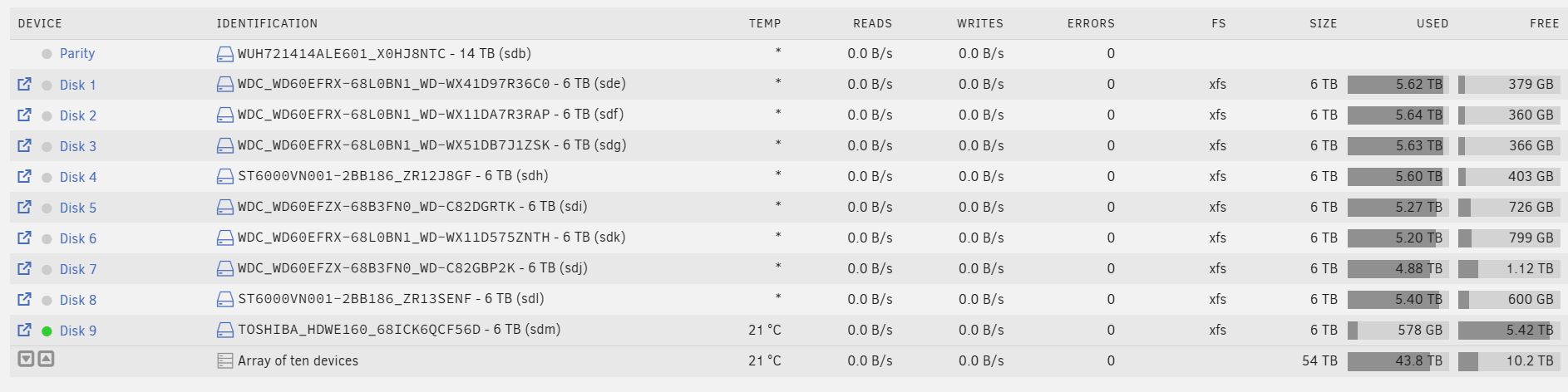

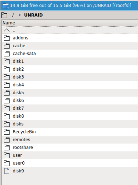

  6. I recently replaced my parity drive with a brand new, larger drive. The old parity drive hadn't missed a beat in the years it spent in that role. So, I performed a pre-clear on it and added it to my array as extra storage. Since doing that, it seems to randomly become unavailable, as in I can't read or write to it, but in Unraid's main tab, it looks to be online. I can even perform a SMART test on it, and it passes. But I can do nothing with the disk until I bounce my server. I've tried replacing the SATA cable, swapping to another SATA controller, etc. But the problem persists. The disk is always readable after a bounce, but then eventually becomes inaccessible, and I have no idea why. Physically, the disk seems fine. In Krusader, the disk (disk9) just becomes a file icon. In Unraid's main window, after trying to access it, it looks like it's spun up OK: If I run a SMART test at this point, it passes OK. I've attached my log and am keen to know what to try next. Thanks all. unr1-diagnostics-20260119-1153.zip
