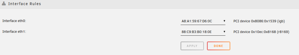

  22. If I'm reading this right, you have two NICs on the new server? In that case, the likely problem is the order of the NICs is opposite to what you think. Boot into GUI mode and swap them here:

  24. Do you have more than one NIC? Can you check that the MAC address showing for the NIC assigned to Interface eth0 actually matches the MAC address of the physical adaptor? Under interface rules, you can choose the NIC order.
