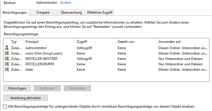

If I remove the default users and groups from the security properties of the share in Windows, these permission entries always remain:
If, for example, the AD group "Lehrer" is included in the "Lehrer" share with the "Change" authorisation, "Full access" appears instead of "Change" after "Apply". However, the teachers do not have access to the share.
