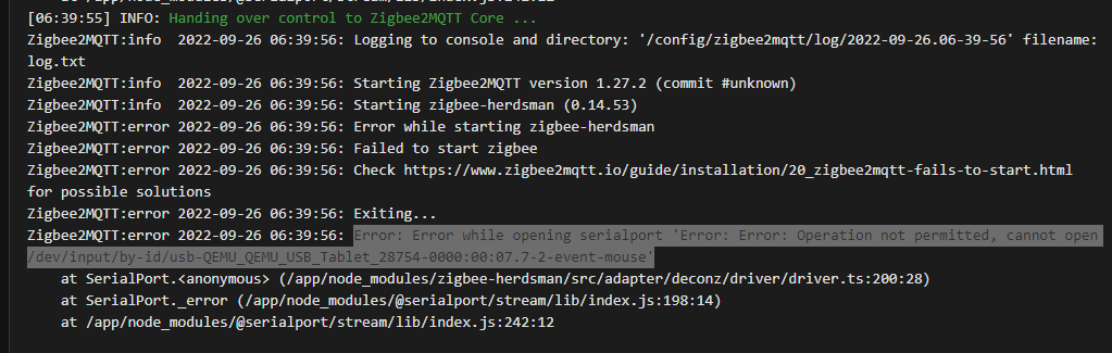

Conbee usb passthrough to an Home assistant VM

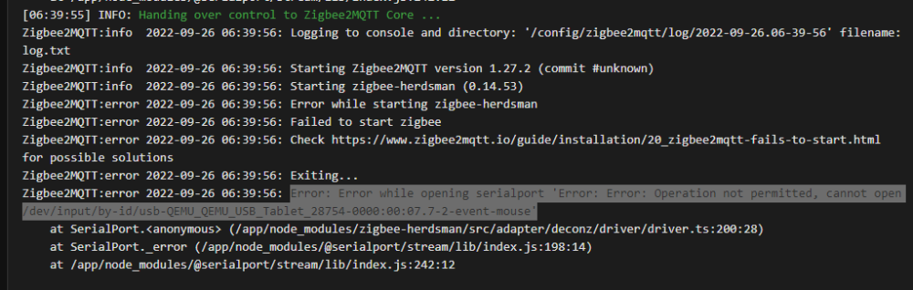

I Have an vm and i passthrough my conbee stick with usb manager plugin but i get this error on zigbee2mqtt
Error: Error while opening serialport 'Error: Error: Operation not permitted, cannot open /dev/input/by-id/usb-QEMU_QEMU_USB_Tablet_28754-0000:00:07.7-2-event-mouse'

1 hour ago, ToastWithCheeze said:
Im using Unraid version 6.11.0
It should be a device with serial not tablet.
/dev/serial/by-id/usb-QEMU_QEMU_USB_SERIAL_1-0000:00:07.7-4-if00-port0
Checkout this thread :
And this thread has the answer:

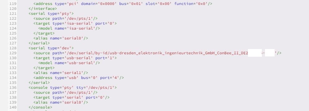

You need to hack into the vm's xml - It works as described
* I removed the old hotplug usb addon and installed the usbmanager
* copy past the xml snippet into the vm's xml devices node
<serial type='dev'>
   <source path='/dev/serial/by-id/usb-dresden_elektronik_ingenieurtechnik_GmbH_ConBee_II_***-***'/>
   <target type='usb-serial' port='1'>
      <model name='usb-serial'/>
   </target>
   <alias name='serial1'/>
   <address type='usb' bus='0' port='4'/>
</serial>
* Hassio does not see it like you are used to but has the following format now: /dev/serial/by-id/usb-QEMU_QEMU_USB_SERIAL_1-****:**:**.*-*-****-port0  (something like that). I assume zigbee2mqtt see it the same since it's how the vm (qemu) sees it now. Without the snippet Hassio detected the stick but could not connect (resulting in timeouts)
* Also - not sure, but is the user that zigbee2mqtt is user allowed to access the serial port ?

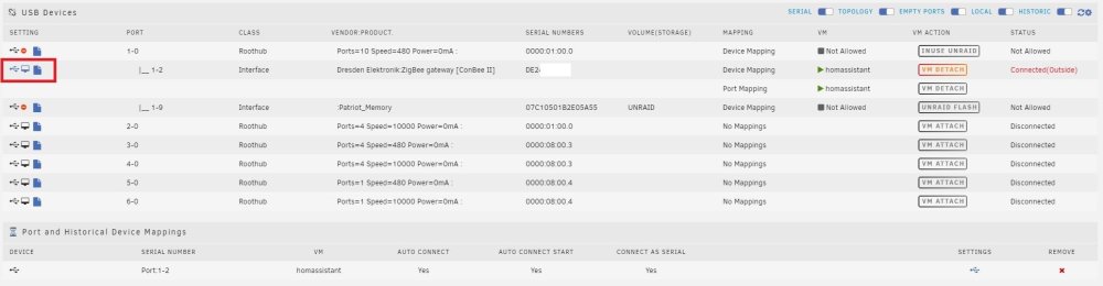

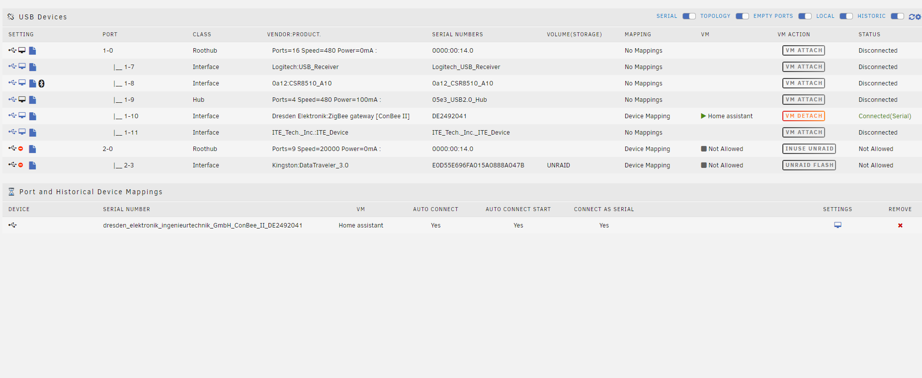

Get the plugin "USB Manager" and configure the conbee by clicking on the link in the first part of the line (marked in red).

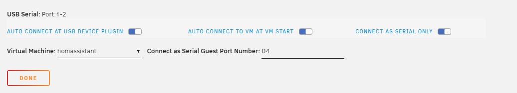

Configure it like in the next screen shot with the radio buttons toggled and assigned to the right vm.
Then you need to get the id of your device by opening the console in unraid and type cd /dev/serial/by-id/, then enter. Next type ls. The part behind the "DE" except for the "@" is your id. You will need this in the next step.
Edit your vm and toggle the xml view with the switch in the top right. Then search for the part where it says " </interface> " and after that put:
<serial type='dev'>
      <source path='/dev/serial/by-id/usb-dresden_elektronik_ingenieurtechnik_GmbH_ConBee_II_DE2XXXXXX-XXXX'/>
      </target>
    </serial>
with your device id behind the "_Conbee_II_DE".
Apply the changes and start the vm. Now you can enter the home assistant webserver and configure the deconz plugin by selecting your conbee stick and restart the plugin.

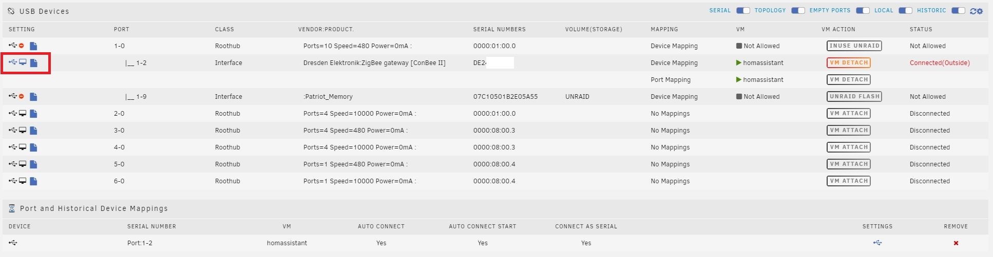

I have tried this but it still wont configure ZHA. My settings
I couldn't figure outif i should setup the usb icon or the screen icon. Both have the same values. With
Connect as Serial Guest Port Number: 4
Then vm xaml:
