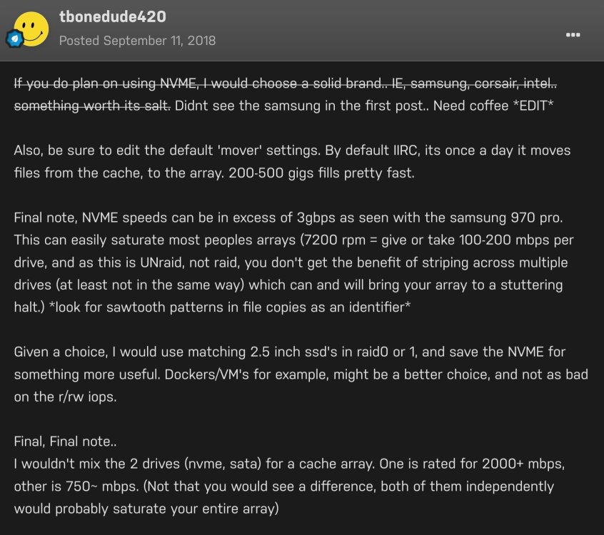

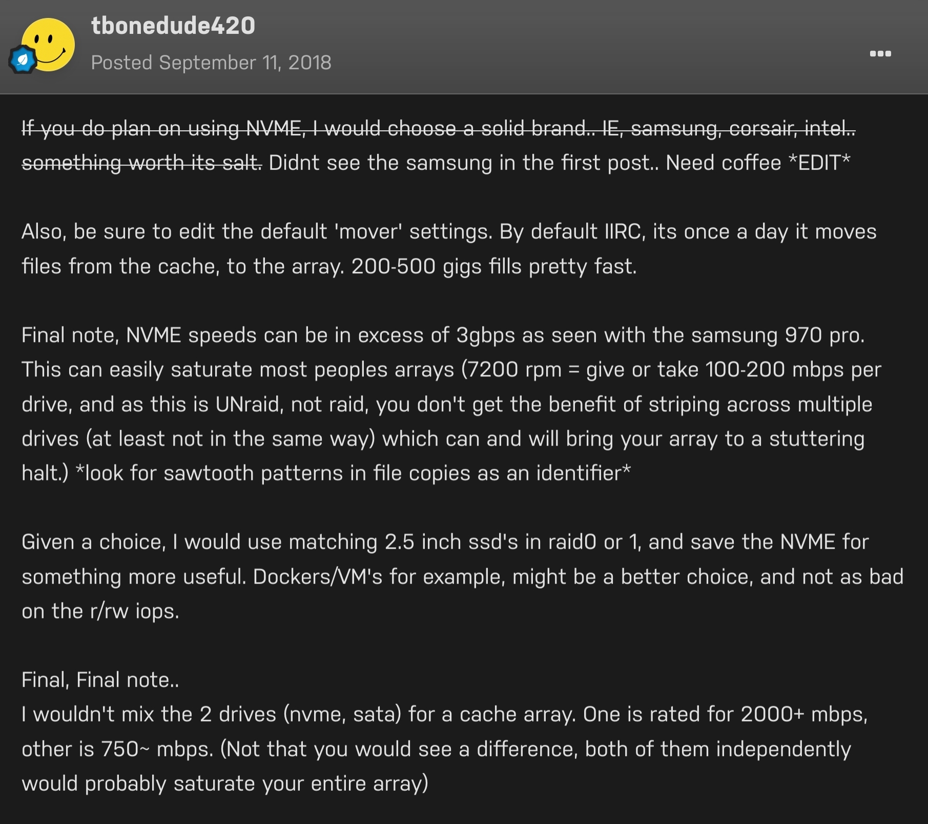

Just found a post from @tbonedude420 which may explain my issue. If this is the case would the introduction of a further "faster" drive, as part of the array be possible? That way downloads are made direct to NVME, but then when copying to the array for permanent storage (and currently bringing the system to a halt, potentially because my mechanical array HDD's can't keep up) I could have them copied to a faster SSD or something similar as a kind of bridge. I don't know if this is even possible, but at this point I'm open to any solution to remedy this issue.
