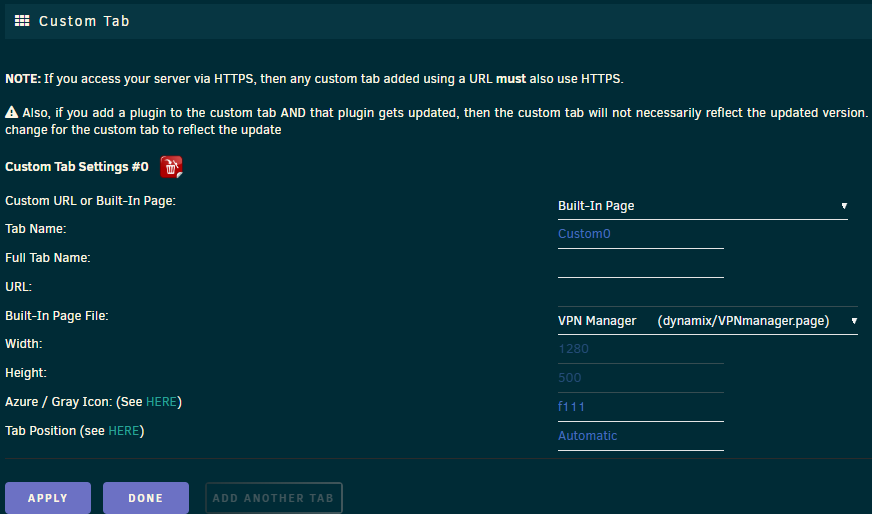

  12. Many thanks Squid! (My apologies was out at lunch) All working as intended now. I swear I looked through that list two or three times and never saw it until you pointed it out 😪
  13. Hi there and thanks for this plugin! I've got an issue however. I run wireguard plugin I would love to add a VPN-Manager tab using Custom Tab but using the built in drop down menu is proving difficult. It does detect the Dynamix stuff, but it doesnt appear to forward to the proper page. unraidip:port/VPNManager VS unraidip:port/Settings/VPNManager When I hit apply this happens Which just shows a blank page..... And it should be Now, if I hard code it using URL, it works fine (But only on LAN, not VPN due to ip's being different) Any help would be greatly appreciated!
