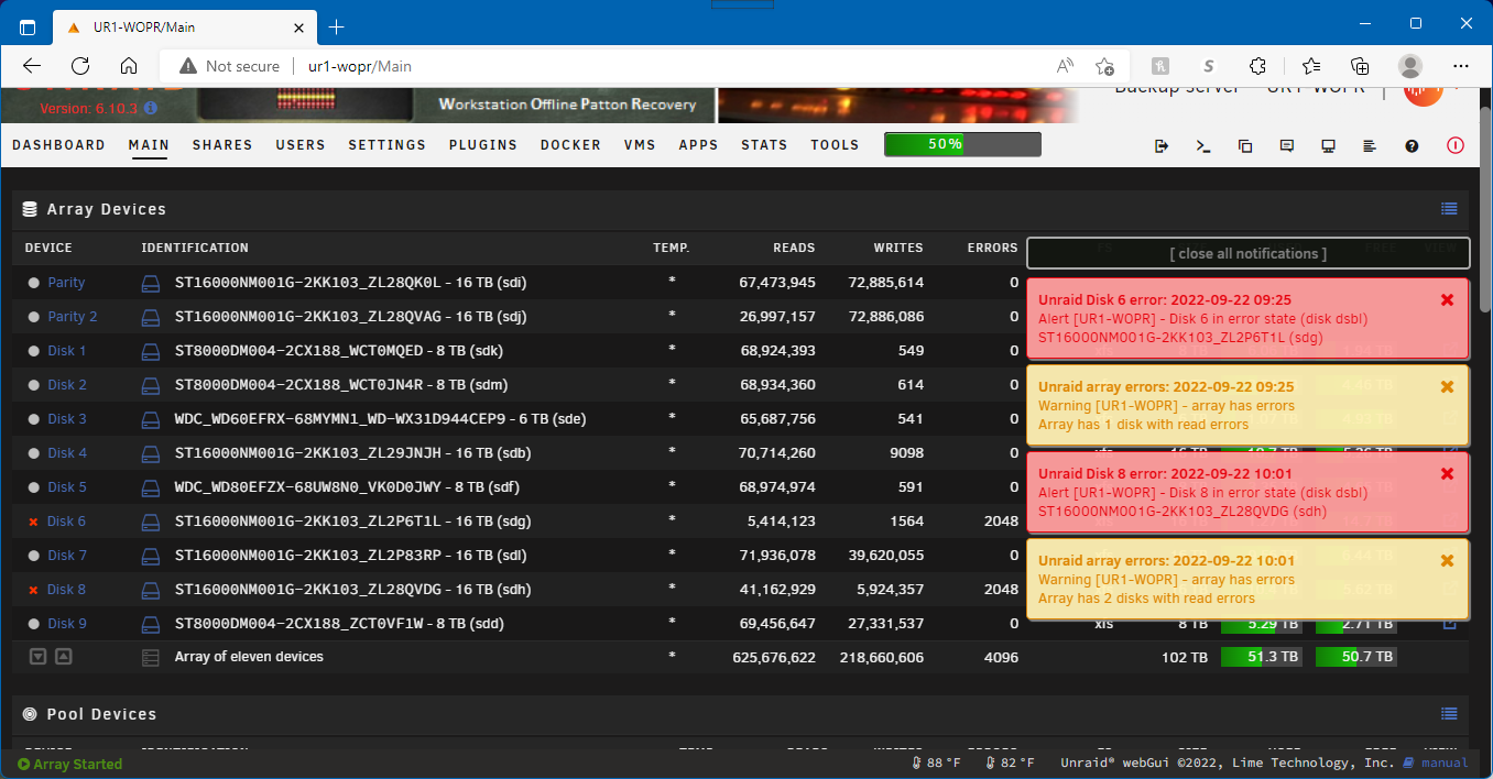

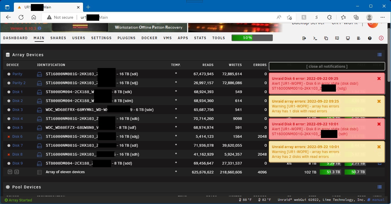

Not sure how accurate the diag will be, I've stopped and restarted system several times since the first issue.  I've also already pulled out the 2 "bad" drives  and inserted two new ones in prep for doing the rebuild.  I have already begun a PRE-CLEAR test on the two "bad" drives via my other unRAID system (so far no issues).  Attached is a screen shot taken after the 2 drives "failed" and before the parity 2 failed, the SMART reports from the two data drives, and the DIAG from this system.

Not clear which disks these SMART reports are for since you xxx the serial number. Doesn't seem to be disks 6 and 8 from the diagnostics.

I guess the serial # is not that critical/confidential?  Would it be better if I re-attached the reports w/o the blanked serial numbers?  Any security concerns w that?

Here are the reports with the serial numbers intact.  As a reminder - the sequence of events:
* Started mover, disk 6 & 8 "failed" immediately.
* Took screen shot
* Ran and downloaded Smart reports on "bad" drives
* powered down, pulled out 6 & 8, replaced w new spare drives (already pre-cleared)
* powered up, started rebuild.
* Parity 2 died right at start of rebuild.
* Canceled rebuild
* ran and downloaded smart report on parity 2
* ran diagnostics report a day(?) later (thus the two "bad" data drives were no longer in system for DIAG report).
SO - screen shot is from BEFORE parity 2 drive died.  If I were to take screen shot now, 6 & 8 would show "emulated" (triangle icon) and parity 2 would show disabled (red X).  I have NOT tried reading any data since these two issues occurred.  It does seem odd that the rebuild did not cancel itself when it was trying to rebuild 2 drives with only 1 parity drive . . .
