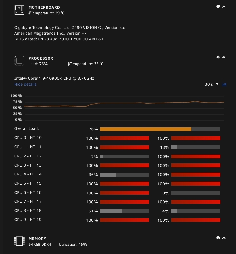

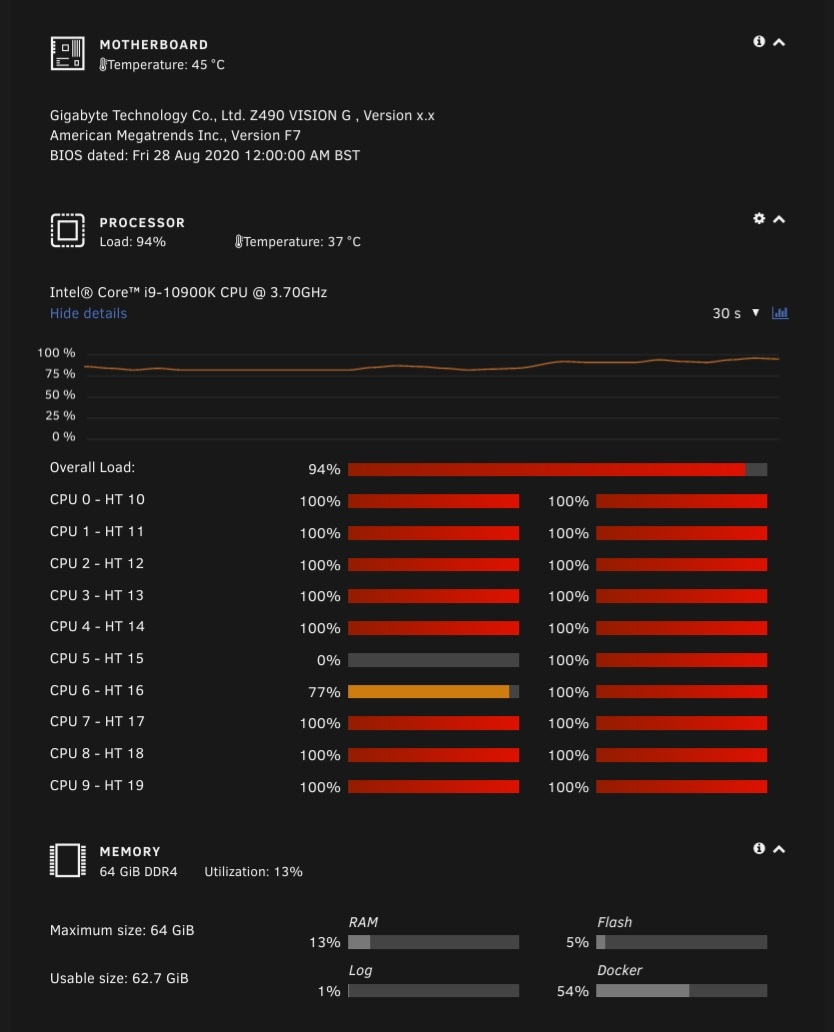

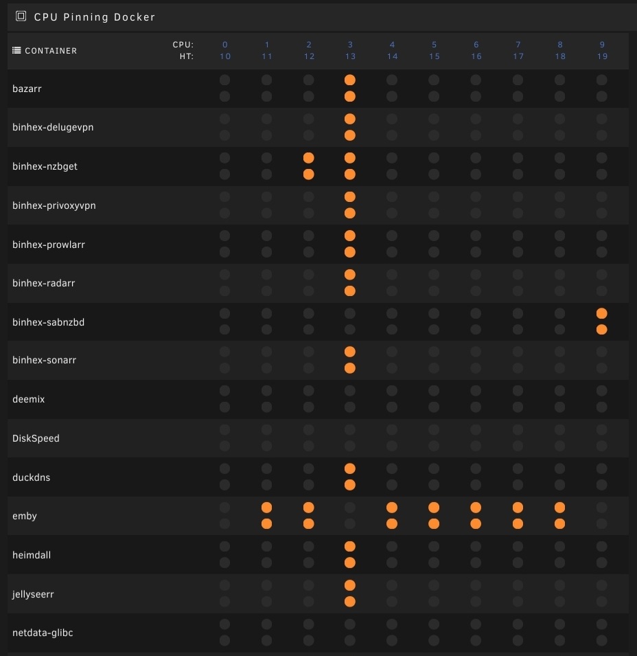

I'm backed into a corner now and don't know how to resolve this. My system is now routinely unresponsive when unpacking/moving a finished downloaded media file. I have tried pinning SABNZB to just two cores however all my CPU cores pin which makes me think the issue is something other than SAB.
For reference SAB downloaded and unpacks on a NVME drive then ultimately moves it to the array. I was of the belief my system was up to the challenge for being a media server, but I. Having second thoughts. I hope its just something simple that I've overlooked.

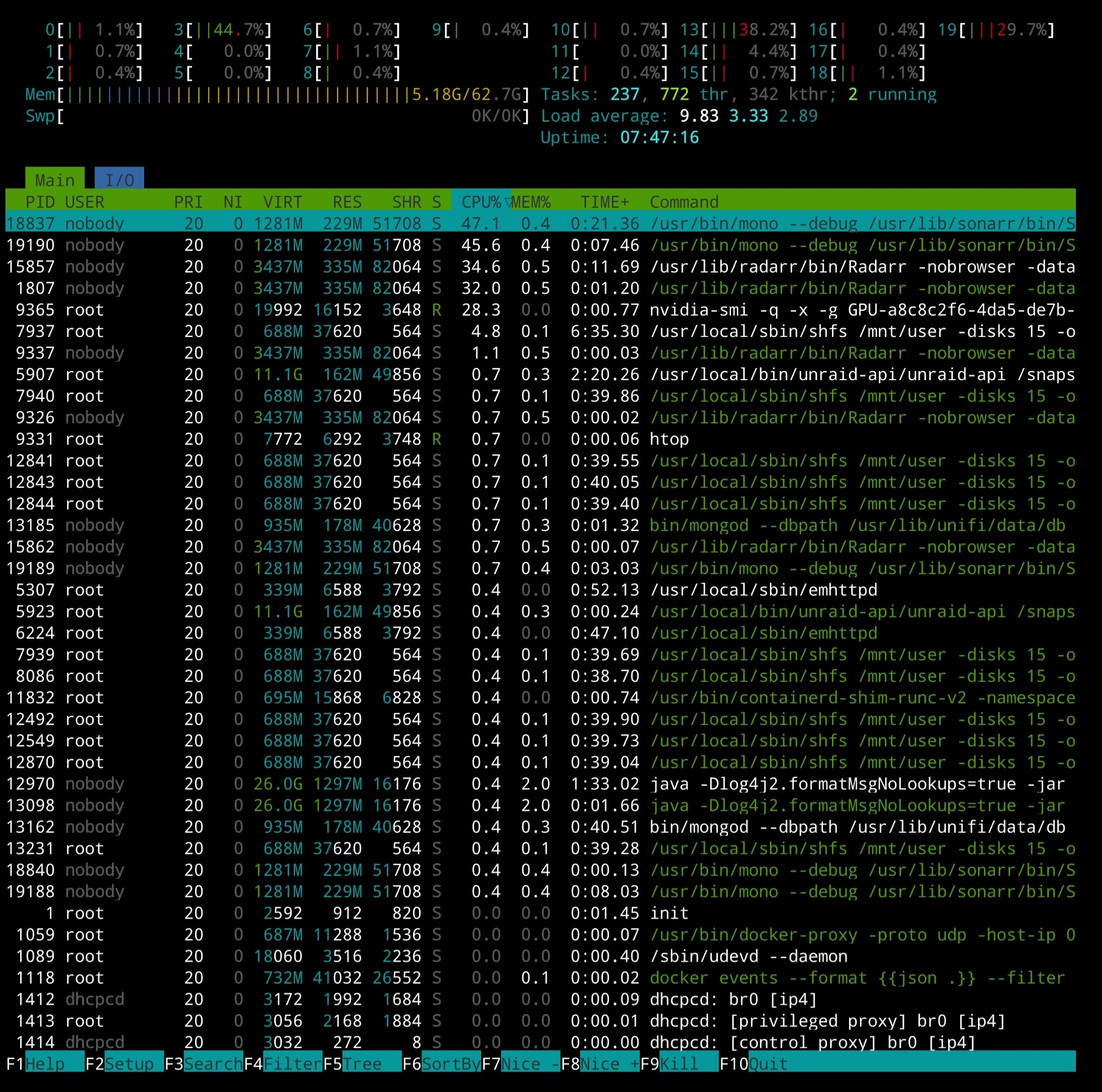

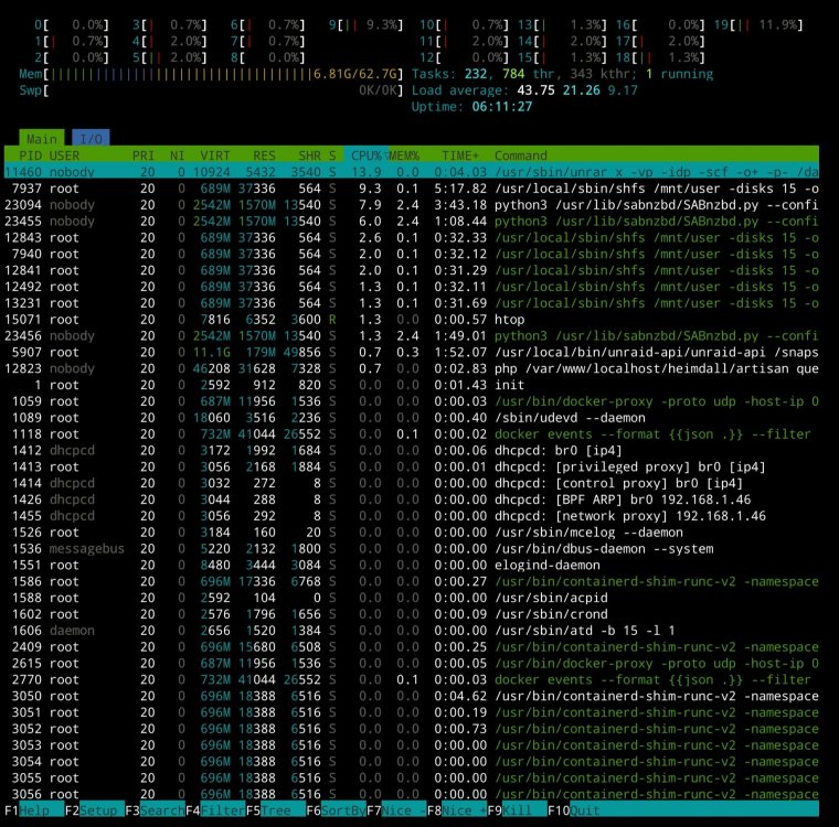

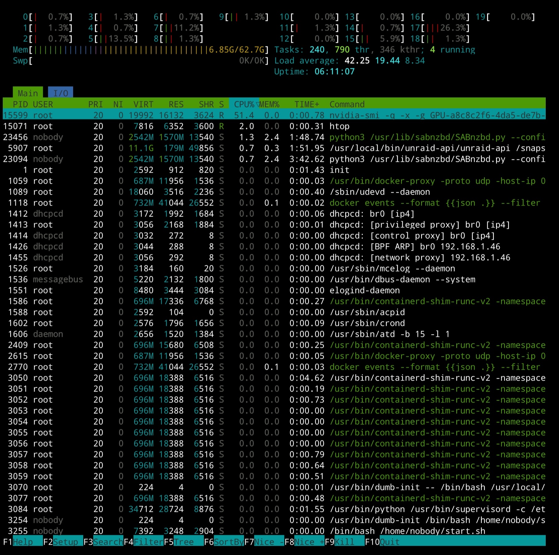

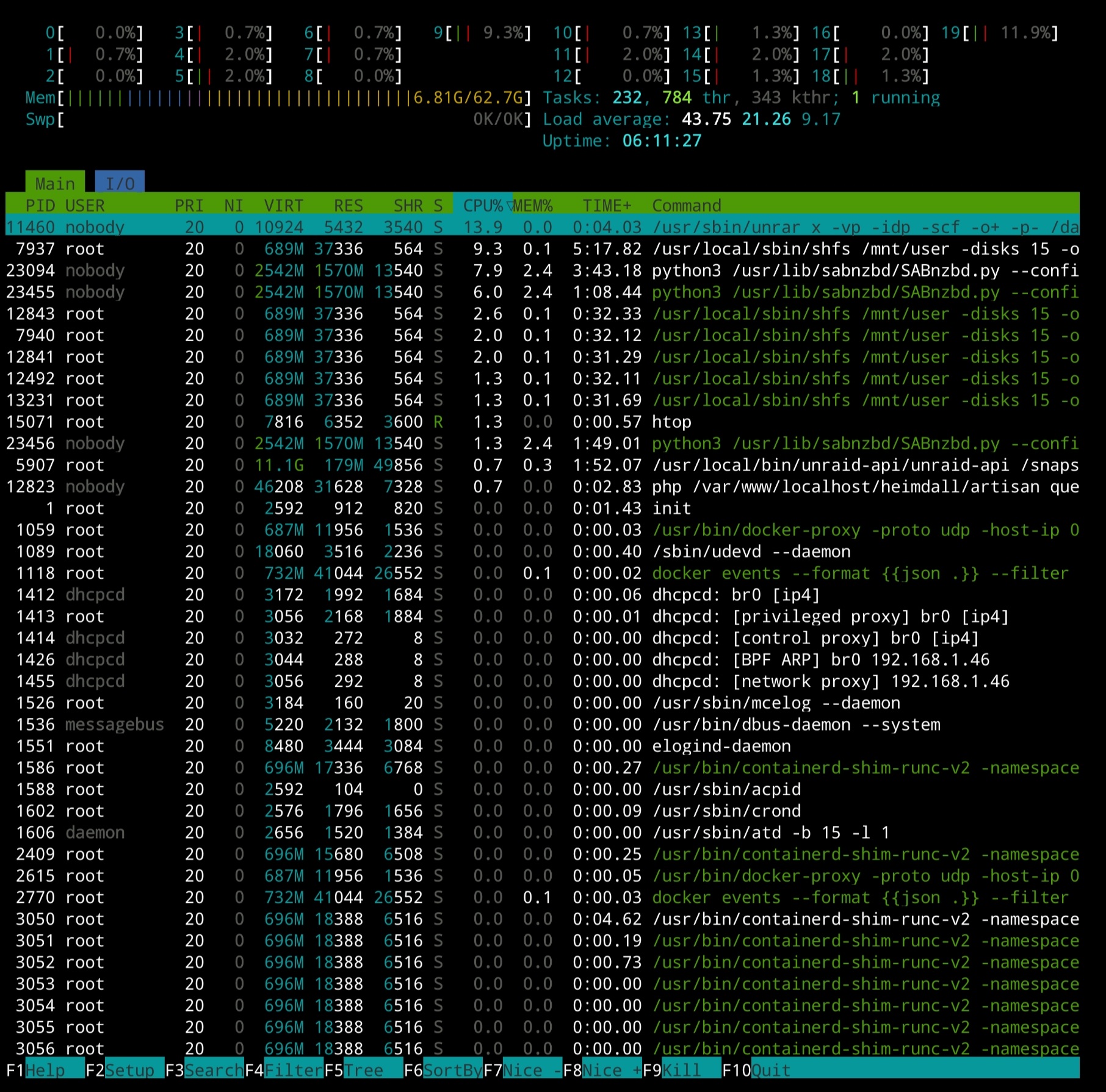

I have run htop and the results are intermittent between the two relevant screenshots below.

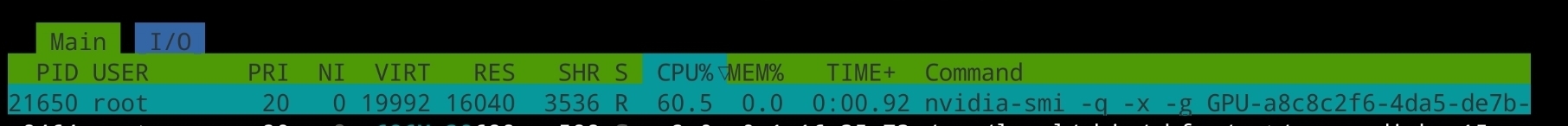

On closer inspection, does anyone know what this process is, it is always at the top of the list when my system drops to a crawl after a download.
I would assume it's from the Nvidia plugin.

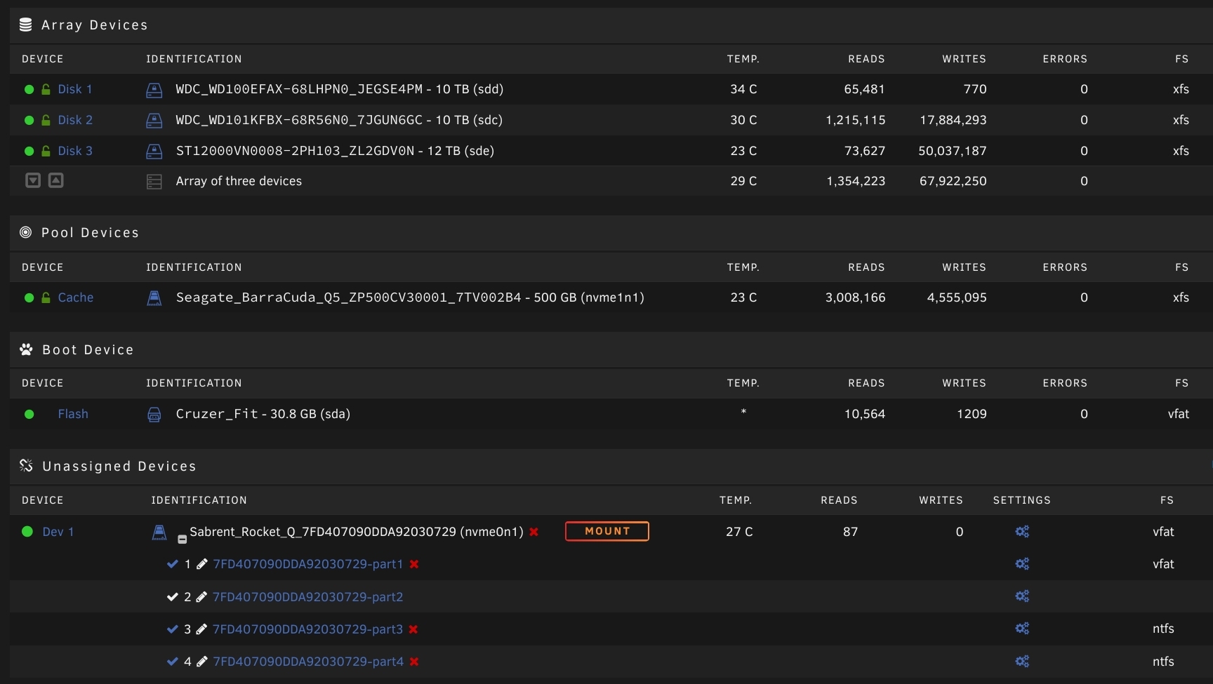

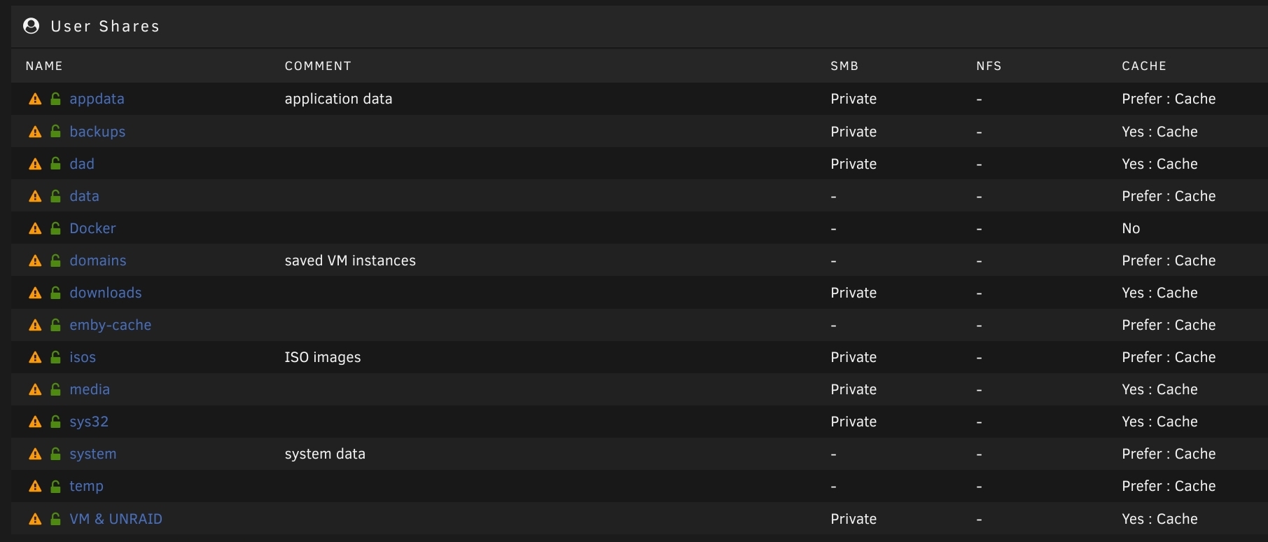

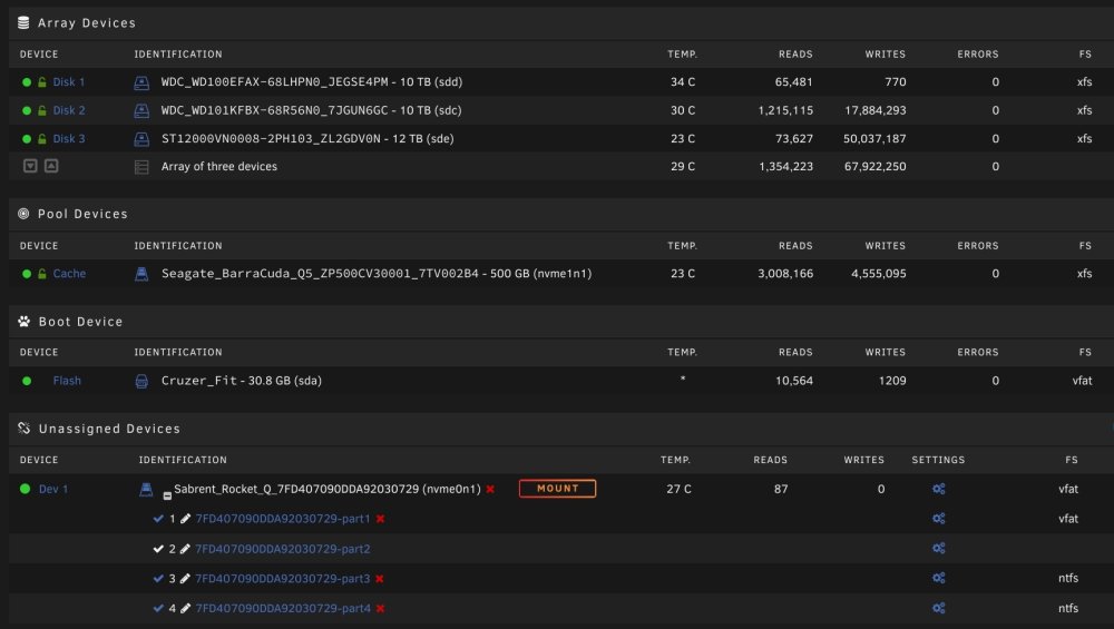

I haven't to be honest mate, but what I am going to try is moving my Windows VM from my 2tb Sabrent NVME unassigned drive to my main array (still reading up on that process so as not to lose the VM). I appreciate that the VM performance will take a big hit but I only use the VM for 30 minutes each month so the Sabrent will be much better used as a dedicated download drive. I'll then keep my app data including EMBY on my cache (500gb Barracuda NVME), so hopefully once things have downloaded, the only time it moves (from Sabrent to Array) will be during the night when MOVER activates.

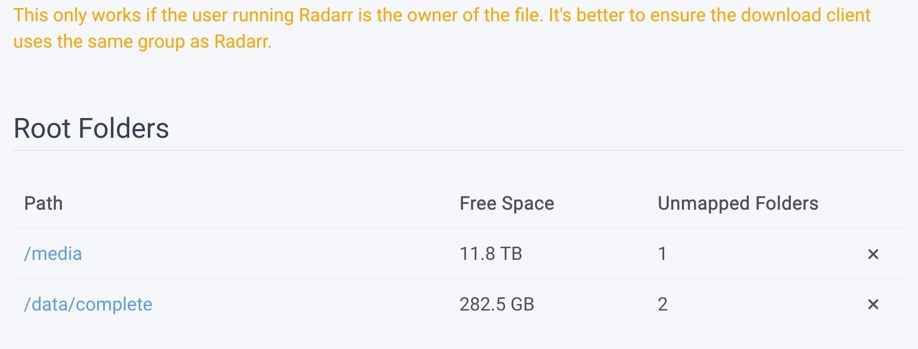

On a side note, I've noticed that my system does not get nearly as bogged down when Sonarr is turned off. When it's on, and it may just be a coincidence, but my system is unusable, even though the docker page shows that Sonarr itself is using minimal resources.
