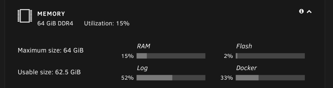

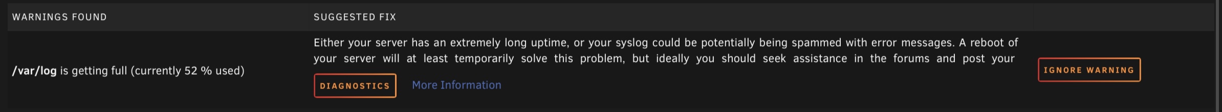

October 9, 20224 yr Hi, my servers log is getting full and I have to reboot my server after a month or so. Now the server is 17 days running and 52% fully log. How can I fix this? Pictures and Diagnostics down below. Thanks 😃 unraid-diagnostics-20221009-1857.zip
October 9, 20224 yr Solution Many things happening on your server. 1. you seem to install most / all packages from Nerdpack. Do you actually need those packages ? 2. several instance of : Sep 22 17:23:32 unraid kernel: krusader[22966]: segfault at 30 ip 000055f2bb8ac2fe sp 00007fffcd7ce100 error 4 in krusader[55f2bb731000+19a000] Sep 22 17:23:32 unraid kernel: Code: 18 4c 0b 00 48 89 ee 4c 89 f7 ff 15 54 0b 0b 00 48 89 ef e8 74 d2 e8 ff 48 8b 3c 24 80 7f 20 00 0f 85 1e 01 00 00 48 8b 43 10 <48> 8b 50 30 48 89 54 24 08 8b 02 83 c0 01 83 f8 01 0f 87 2b 01 00 3. Plenty of those too ep 23 04:40:01 unraid logrotate: ALERT - exited abnormally. Sep 23 04:40:12 unraid sSMTP[8480]: Creating SSL connection to host Sep 23 04:40:12 unraid sSMTP[8480]: SSL connection using TLS_AES_256_GCM_SHA384 Sep 23 04:40:12 unraid sSMTP[8480]: Authorization failed (535 5.7.8 https://support.google.com/mail/?p=BadCredentials m9-20020a509989000000b0043df042bfc6sm4990087edb.47 - gsmtp) 4. Tons of those at the end of the log Oct 6 19:06:47 unraid nginx: 2022/10/06 19:06:47 [alert] 24666#24666: worker process 3892 exited on signal 6 Oct 6 19:06:49 unraid nginx: 2022/10/06 19:06:49 [alert] 24666#24666: worker process 3907 exited on signal 6 Oct 6 19:06:50 unraid nginx: 2022/10/06 19:06:50 [alert] 24666#24666: worker process 3922 exited on signal 6 Oct 6 19:06:51 unraid nginx: 2022/10/06 19:06:51 [alert] 24666#24666: worker process 3937 exited on signal 6 Oct 6 19:06:52 unraid nginx: 2022/10/06 19:06:52 [alert] 24666#24666: worker process 3969 exited on signal 6 Oct 6 19:06:53 unraid nginx: 2022/10/06 19:06:53 [alert] 24666#24666: worker process 3988 exited on signal 6 Oct 6 19:06:54 unraid nginx: 2022/10/06 19:06:54 [alert] 24666#24666: worker process 4003 exited on signal 6 Oct 6 19:06:55 unraid nginx: 2022/10/06 19:06:55 [alert] 24666#24666: worker process 4021 exited on signal 6 Oct 6 19:06:56 unraid nginx: 2022/10/06 19:06:56 [alert] 24666#24666: worker process 4036 exited on signal 6 Oct 6 19:06:57 unraid nginx: 2022/10/06 19:06:57 [alert] 24666#24666: worker process 4051 exited on signal 6 Oct 6 19:06:58 unraid nginx: 2022/10/06 19:06:58 [alert] 24666#24666: worker process 4073 exited on signal 6 Oct 6 19:06:59 unraid nginx: 2022/10/06 19:06:59 [alert] 24666#24666: worker process 4143 exited on signal 6
October 10, 20224 yr Author 1. Installed all, because a YouTube Guide said, better to install them all…I will Deinstall them all and select those I need. Had that once, know I must research, wich I need 🤷♂️ 2-4. Ok, I See. And what does that mean? Maybe because of the nerdpack thing? EDIT: Removed all packs except of Perl & Powertop and rebooted. Hopefully there wasn’t something I needed essentially 🥲 I will see how the log is doing over time and report. Should I upload the diagnostics again now or then? Edited October 10, 20224 yr by p5lukas

October 10, 20224 yr Community Expert The logs in your diagnostics aren't large. 17 hours ago, ChatNoir said: all packages from Nerdpack atop is notorious for filling logspace with its own logs
