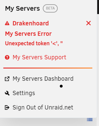

October 10, 20224 yr Community Expert Try typing in the console: unraid-api restart If that doesn't do it best to repost that error in the MyServers support subforum.
