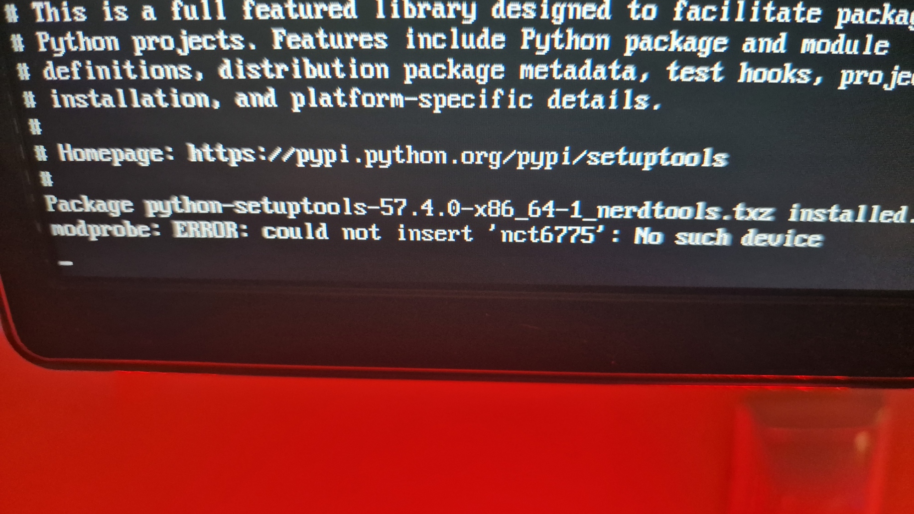

Huge delay during boot (that I didn't have *I think* before 6.11)
I am talking maybe even 5 minutes waiting.
Even though I know that it takes time, it is so much, that I start thinking every time that something is wrong this time. :D And then it proceeds.
Here is where the long pause takes place:
Also, I am not sure why it looks for nct6775 (don't know if it is related to the long pause), as I don't have that plugin in UNRAID (it was in my previous motherboard, but I removed it and I have ITE driver now).
But I don't know if it comes from that removed plugin either.
So:
- Any idea how to find what makes the huge pause?
- Any idea how to remove this modprobe for nct6775? (or is it part of the boot process anyway?)
Likely to be system temps tryinb to access. post diagnostics for long boot question.
As I said, I removed that addin driver when I changed motherboard.
Anyway, here are my diags...

Looks like myservers plugin is.creating the delay. Checking dns or maybe a network
Oct  8 23:49:35 quasar-ultima root: Installing dynamix.unraid.net.plg 2022.09.28.1258 with Unraid API 2.52.1
Oct  8 23:49:35 quasar-ultima root: plugin: running: anonymous
Oct  8 23:49:35 quasar-ultima root: Checking DNS...
Oct  8 23:52:07 quasar-ultima root: Validating /boot/config/plugins/dynamix.my.servers/dynamix.unraid.net.txz...  ok.
Edited by SimonF
Well DNS is on a VM inside UNRAID, so it is not there while booting.
The secondary one (in UNRAID settings) is my router, so that should work.
So... if that is the issue probably it should skip to secondary DNS much faster OR use maybe a hardcoded "boot time" DNS or (third possible solution) revert to a (list of?) hard-coded name resolution entries (which is the best option probably).
It was working faster somehow before a few weeks probably (not sure, I rarely reboot).
