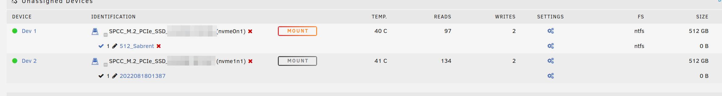

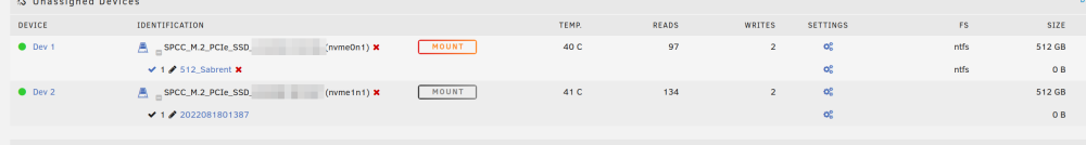

Oh thanks for this solution, I've been getting similar issue where I replaced/upgraded my NVME cache with a larger drive, and reassigned the existing cache disk to an Unassigned disk. As a result, for some reason the "old" cache disk (now 2nd NVME) would show up with the option to FORMAT, but after that would only present the option to Preclear, which I did, but then I cannot utilise it as an Unassigned disk because the MOUNT option never becomes usable:
After formatting it and Preclearing it a few times, nothing seemed to be working.
I also cleared the disk a few times, deleting all partitions.
After clearing the disk a final time and performing a full system reboot, it seemed to become usable again:
Seems like a odd bug somewhere, maybe?
