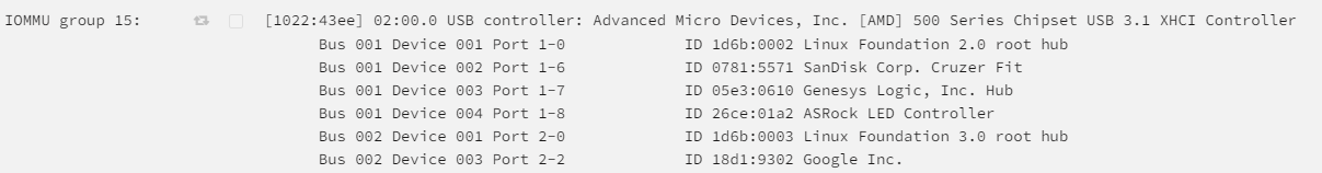

This controller:
02:00.0 USB controller [0c03]: Advanced Micro Devices, Inc. [AMD] 500 Series Chipset USB 3.1 XHCI Controller [1022:43ee]
    Subsystem: ASMedia Technology Inc. ASM1042A USB 3.0 Host Controller [1b21:1142]
    Kernel driver in use: xhci_hcd
So I thought the same because the crash log from June was similar and had the 02:00.0 USB controller. At the time, I unplugged the USB cable from the CyberPower UPS and it seemed to keep the server alive for several months but maybe that's not it. Starting to wonder if it's the Google Coral paired with the frigate-nvidia docker that's causing server crashes.

Or maybe try to relocate my Google Coral to another usb hub?
Worth trying.

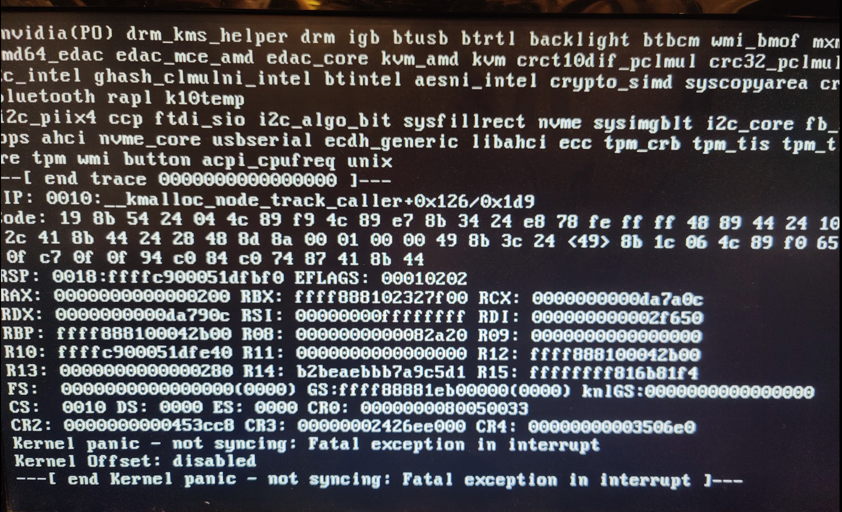

Hi, yes same issue here. I connected a screen and it showed the attached.
have you found a way to fix this?
If "the same" is crashing, it's uncertain that it is the same root cause as the OP.
Your screenshot do not show the same messages.
You should create a new post and attach your diagnostics.
Probably also set up a syslog server and post the output file after a crash.
