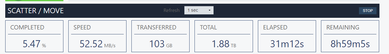

Quick one, I have 10 x 6tb disks & 10 x 2TB disks and i'd like to remove ALL the 2TB disks from my array which are now surplus and not needed. However i need to get the data off the 2TB disks and over to the 6TB disks.. .
I'm using unBalance to move the contents of the 2tb disks over to the newer 6tb disk however each disk looks to be taking around 12 hours and i have 10 to do. It seems unBalance is locked to only doing 1 disk at a time... is there a faster way for me to get all these disks going simultaneously to save on time that my array parity is down.... I thought about just opening up 10 terminal sessions and manually copying the contents over simultaneously. But was wondering if there's a nicer solution? I'd assume i'd probably bewilder my parity disks bandwidth if i had multiple whole disk copies going at the same time? Would turbo write help in this situation?

I'm following the "remove drives then rebuild parity" Method for the removal of multiple disks. As i can only run unbalance on a single disk at a time and have 10 to do, i was initially assuming my parity would be invalid until i've finished the last disk and rebuilt it. However i think after a re-read the only time my parity is at risk is at the end of the process when i run 'new config' to finish removing the drives and unraid runs a parity rebuild when the disks are finally removed.
In regards to the disks I've tried Moving and Copying and both transfer at around 54mb/s with unbalance. Wondering whether it's because the 2TB disks are 99% full. The disks are very old (2010) but the SMART reports for all the 2tb disks all pass so no issue with the disks.

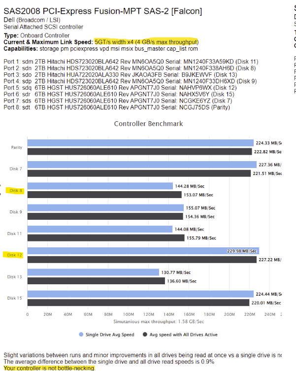

I have the disk speed plugin and it shows no bottlenecks with the disk or controller config. I'm currently copying from Disk8 > Disk12 and as per the screenshot it seems there's lots more bandwidth between the 2 disks than unbalance is using. I know i'll lose some from running dual parity but it does seem a little slow regardless.
Current Unbalance Copy Disk8 > Disk12
Disk Speed Plugin screenshot showing Disk8 and Disk 12 and the bandwidth available

Parity protected array to array copy will always be slow, since you're are going to rebuild parity you could disable it now so it would move the data much faster, of course array will not be protected once you do that.

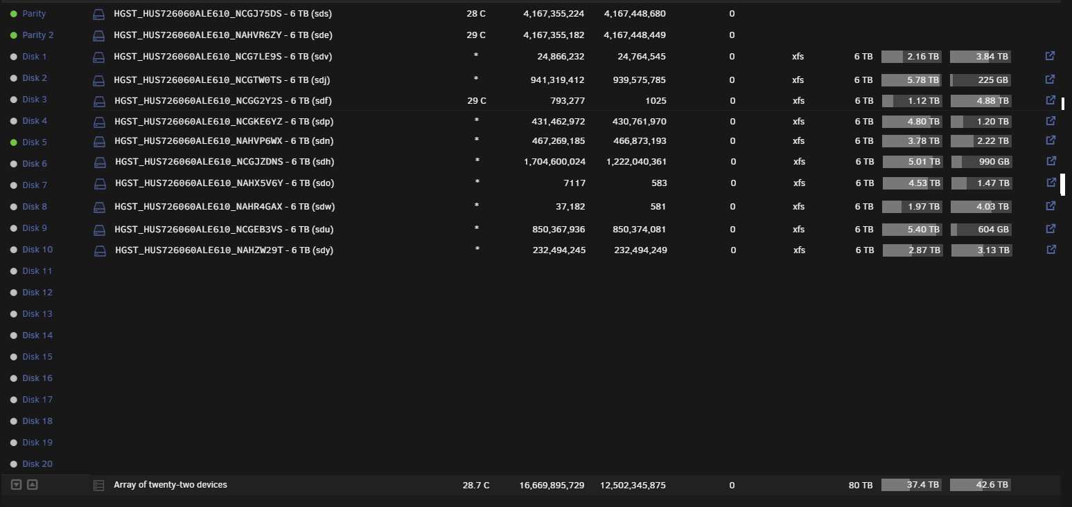

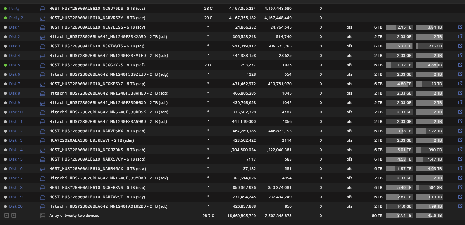

I'm just about to remove 10 x 2tb disks from my array which will leave the disk numbering all over the place... in escense it'll go from this:

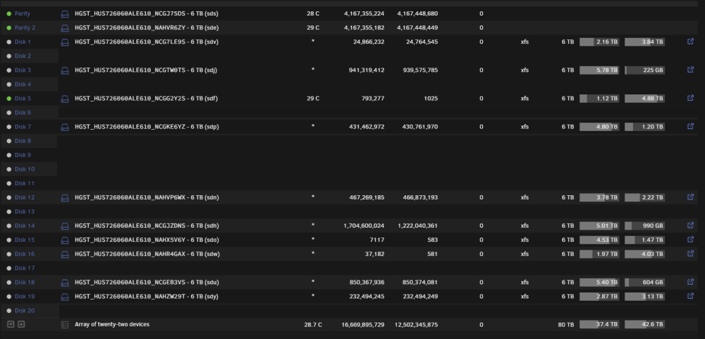

To this:
Is it possible for me to assign my 10 x 6tb remaining disks to disk slots 1 > 10 without losing any data (obviously i would reassign the new disk slot number in my shares if they were previously explicitly set.)

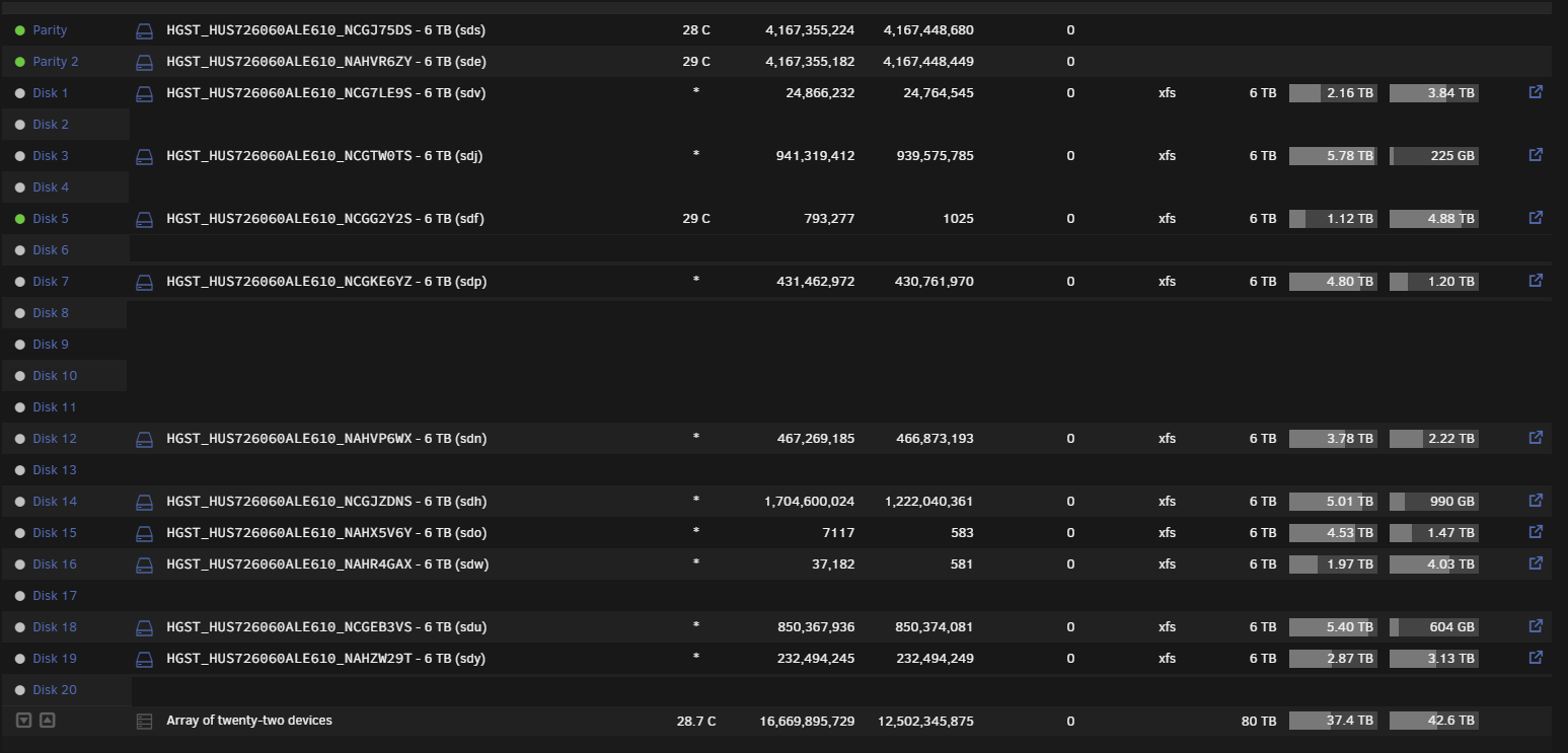

Would that work? Want it to like this after reassignment:

Yes, after the new config you can assign the disks in any order you want, just make sure you don't assign a previous data disk as parity.
