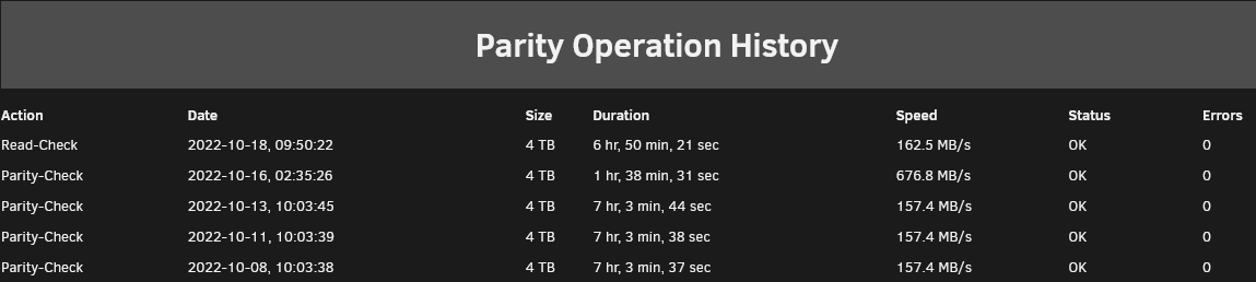

Were these correcting parity checks? Why were you running parity checks anyway?
I don't think it can even do a parity check if you have a disabled disk unless you have dual parity. Are you sure it wasn't doing a read check instead?

Indeed it was, but my confusion came from the terminology used until Unraid OS v6.10 (see attached picture).
Diagnostics are attached. Thank you for your time and answers!
