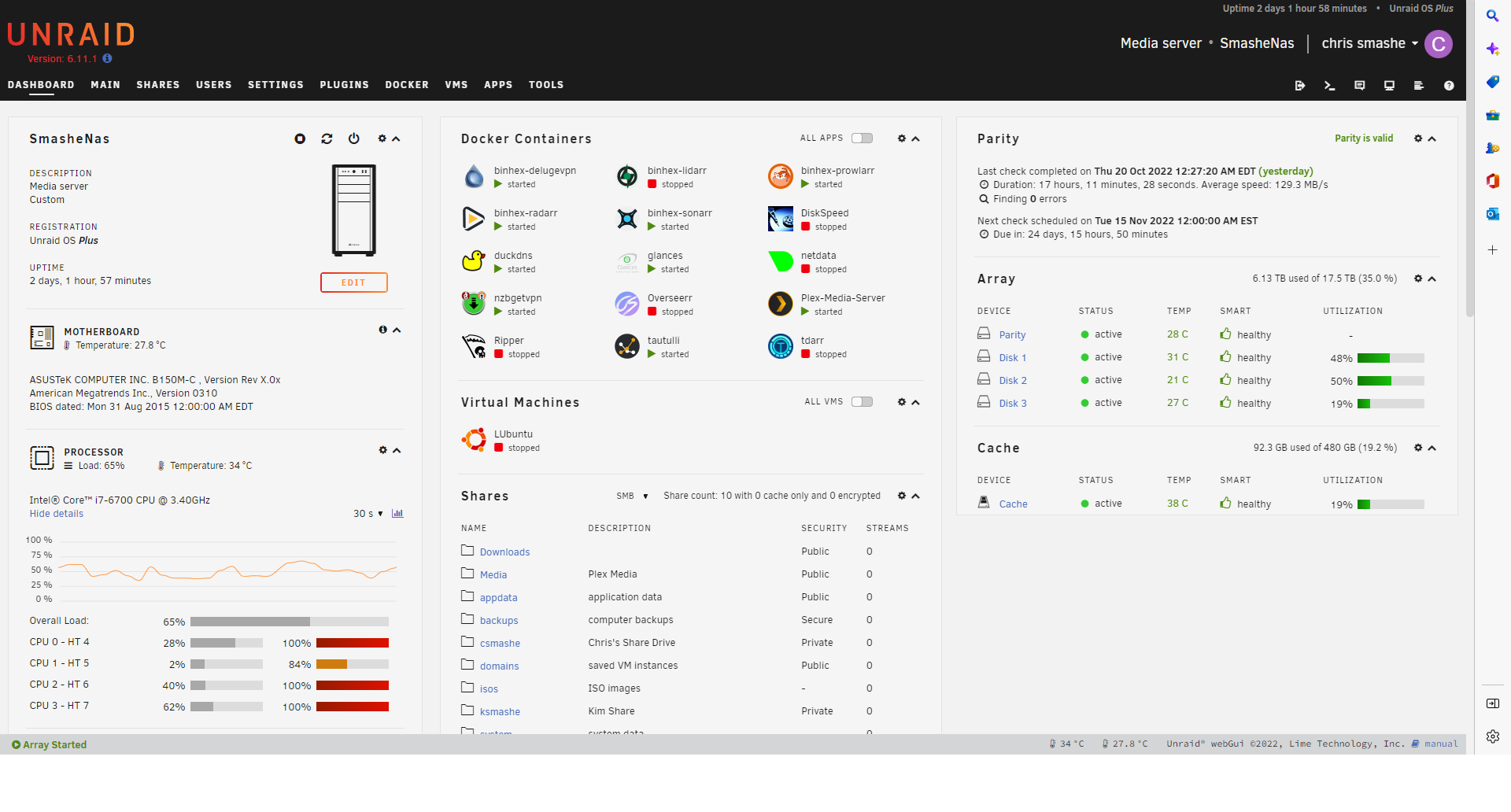

October 21, 20224 yr Latest information at the bottom. System Mother Board: ASUSTeK COMPUTER INC. B150M-C , Version Rev X.0x CPU: Intel® Core™ i7-6700 CPU @ 3.40GHz Memory: 32GB DDR4 GPU: NVIDIA GeForce GTX 1070 Hard Drives Cache: Crucial/Micron Client SSDs 480 GB SATA 3.3 Parity: WD-Plus 12 tb 7200 rpm Sata 3.1 Array Disk 1: WD-Plus 8 tb 5640 rpm Sata 3.1 Array Disk 2: Seagate Barracuda 1.5 tb 7200 rpm SATA 2.6, 3.0 Gb/s (only holds music) Array Disk 3: WD-Plus 8 tb 5640 rpm Sata 3.1 I'm having an issue with iowait locking up the system with high cpu usage. I have turned everything off one by one and figured out its deluge. Once i stopped that the io wait went to 0 and stayed there. While this was going on things were downloading but nothing finished so there was no unpacking being done (that I am aware of). Deluge is set up to download to the downloads share which is set to cache pool = yes. Once the file is done, the rrr's are set to move the files to the array. This was not being done during this test. My questions are How do I tell what disk is causing the io to wait? At first, I was thinking that there is a problem with my cache drive (or deluge), but while typing this out, I also figured out that most of the files being downloaded by deluge have been doing so for long enough that least part of the download has been moved off of the cache drive to the array by the mover. Is this part of my problem? Do I need to change the downloads cache pool to be only, so it never moves that to the array until one of the rrr's does it? smashenas-diagnostics-20221021-0909.zip Edited October 22, 20224 yr by chris smashe

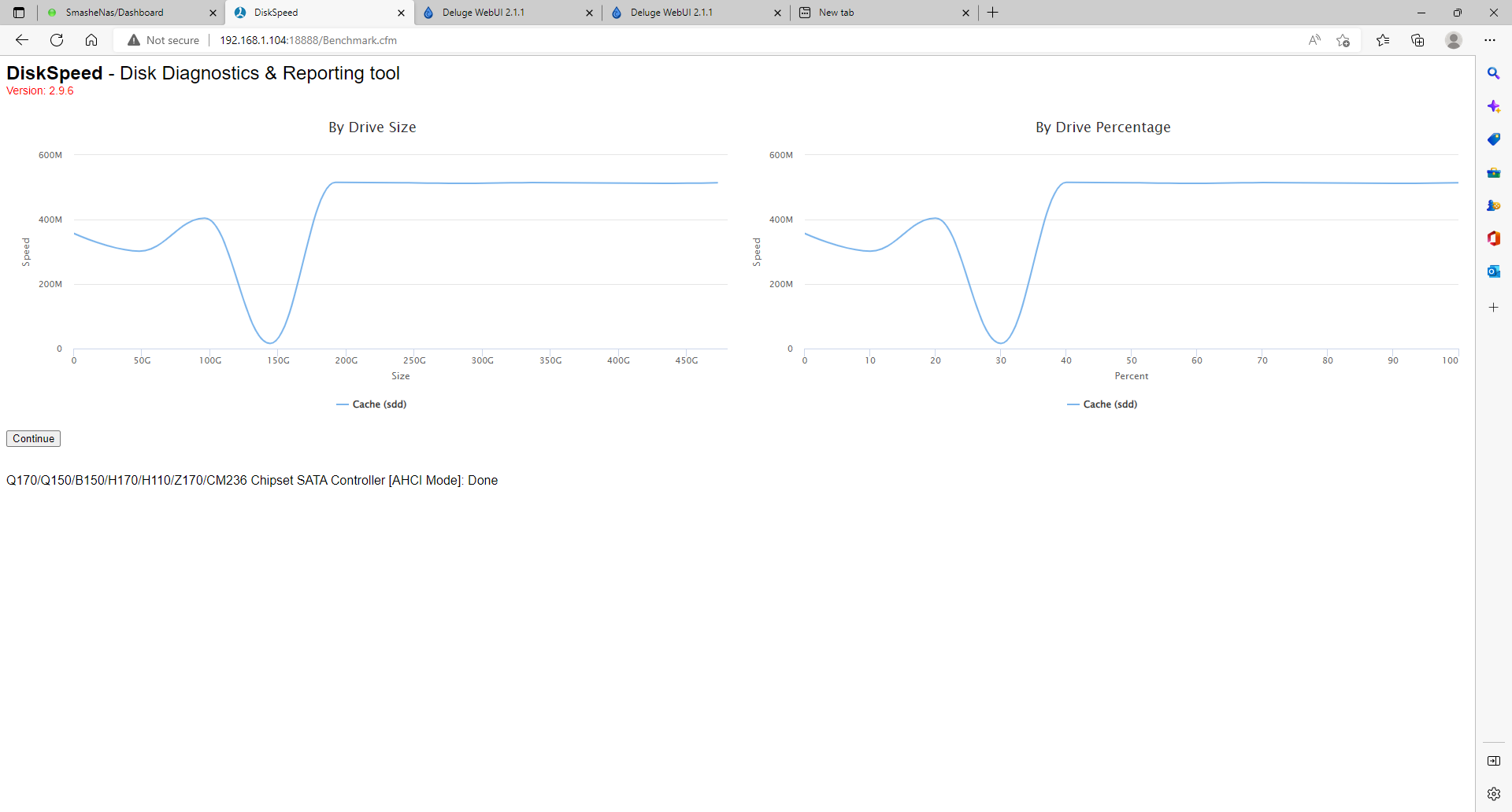

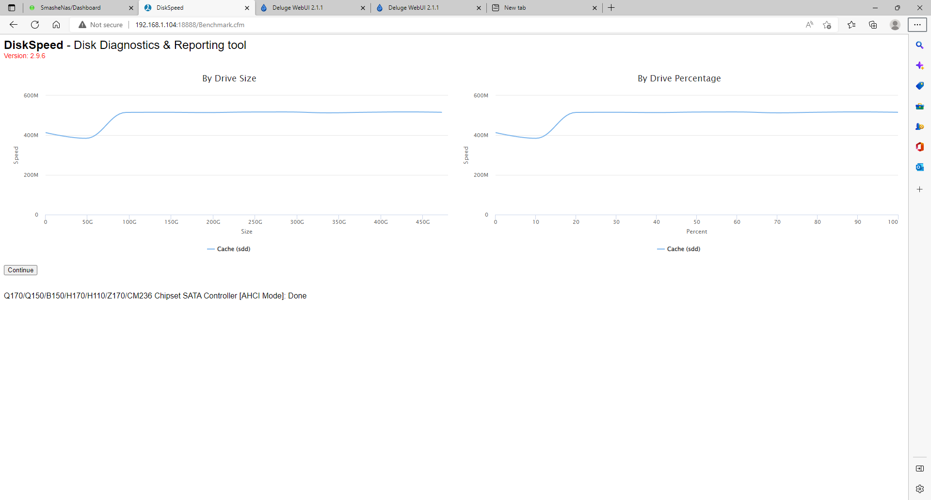

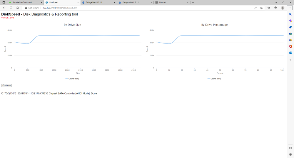

October 21, 20224 yr Author Additional note 3 ok its not deluge specific. I copied a 23 GB file from my computer to a share that saves to the cach drive. It was fine for a bit but then started to have an ongoing iowait for the last 3/4(ish) of the file. The max transfer was 113MB/s. 13% complete was where it started to have iowait issues. It would go down to a transfer of 7mbs. Closing the VM had no impact on this. I ran disk speed against this and while it was scanning it would have IO wait issues. It also had a strange drop off then rise. I ran it again and it was even stranger. I ran disk speed against one of the 8tb spinning drives. max io wait of 12.3% This is all of the tests that i can think of to run to give data to you. Thanks for any help you can give me.

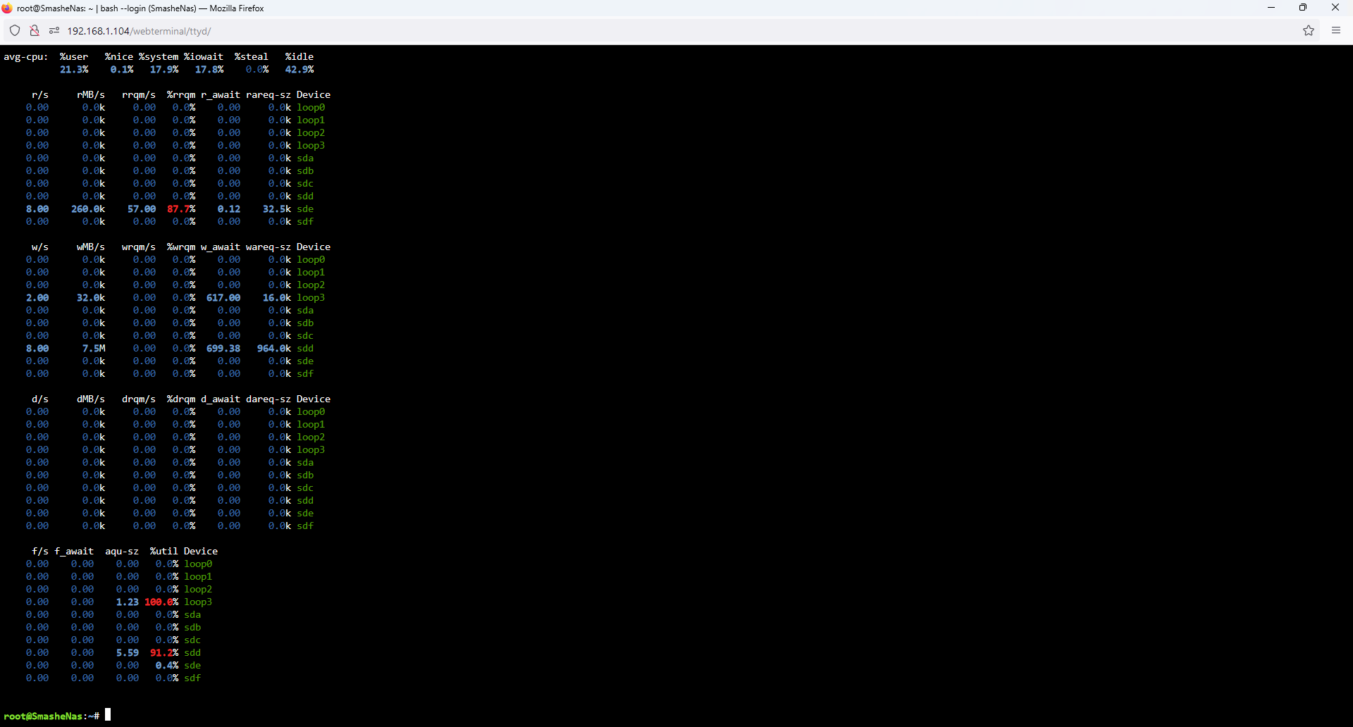

October 22, 20224 yr Author So it is definitely an issue with the cache drive or butter fs. I ran iotop and here is a video of it running while I do a transfer and deluge is running. A good portion of the time btrfs worker is 99% io but has no read or writes being listed. Then when you get to 31 seconds it is the only thing showing ( i used the -o flag to only show processes that have io) since it looks like its blocking everything else from running and causing the wait. I have also seen nothing listed at all for a couple seconds in my tests but that is not shown in this video. Also attached is an iostat image My next steps are to change out the drive with another drive and if that does not work, change the drive from btfs to xfs and see if that works. That will be later so if anyone has any ideas before i start that it would be helpful.
