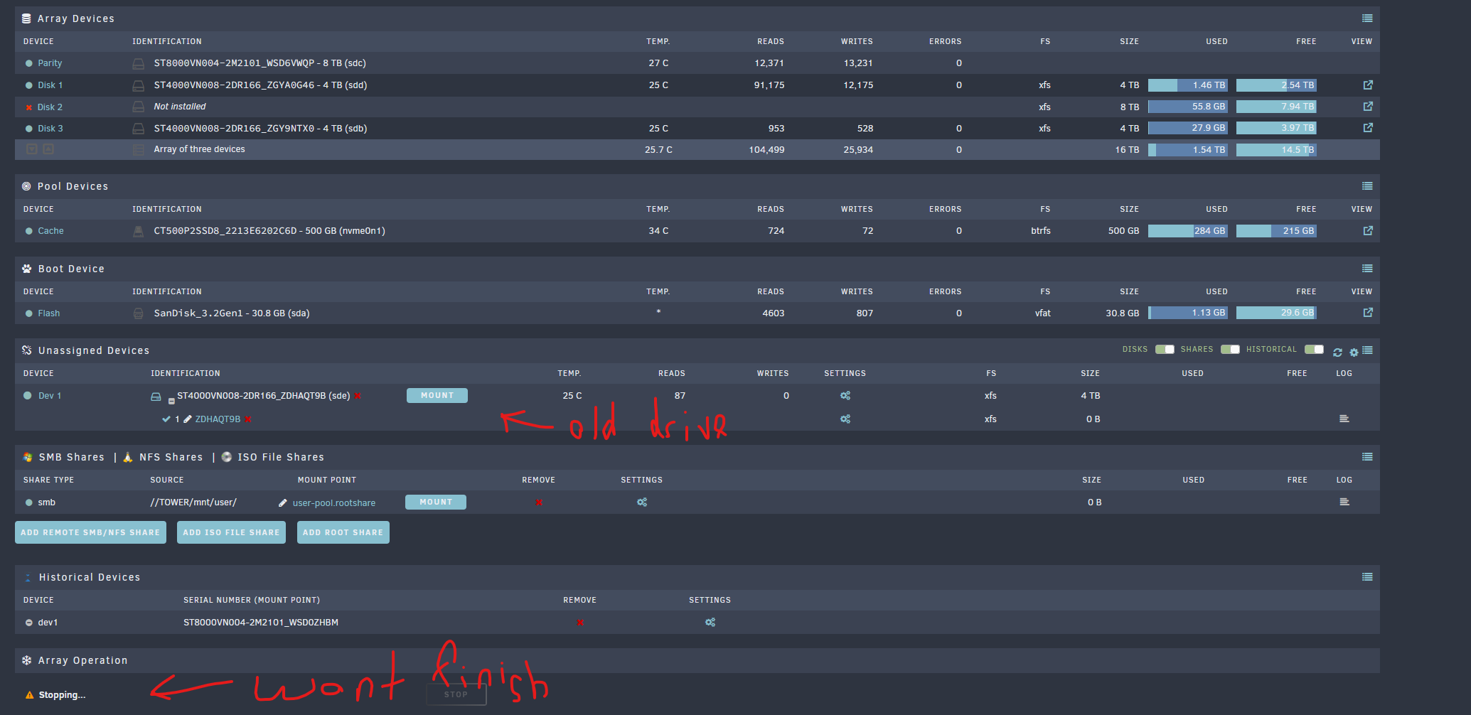

Unraid won't allow me to stop the array to re-add the 4TB drive.
It is in stopping mode forever.
Diagnostics attached and screenshot attached.

Oct 30 21:25:43 Tower root: umount: /mnt/disk1: target is busy.
Something is preventing disk1 from unmounting, make sure there's not an SSH connection open to that disk for example.

I did have a parity tuner scheduled to run around this time.
I disabled it and also turned off all dockers and it has allowed me to stop the array! Cheers.
