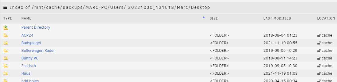

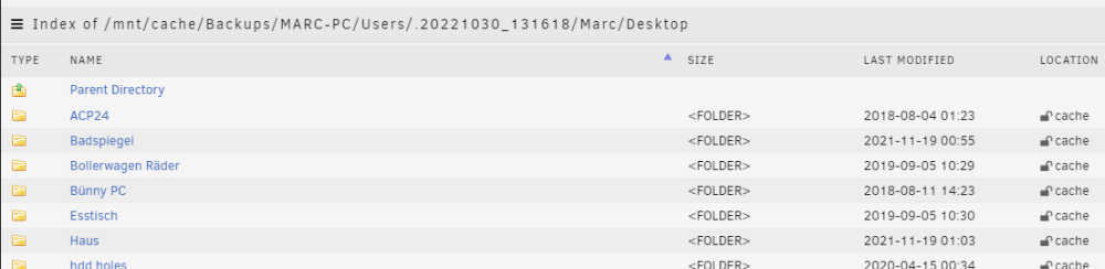

Example-Backup
This is how it looks on my server:
As you can see, the folder is named "MARC-PC", which is the name of my PC. Of course it depends on your used backup command how backups are created.
Note: The Unraid share "Backups" shouldn't be available through the network (this respect the pc owners privacy and protects it against ransomware!).
