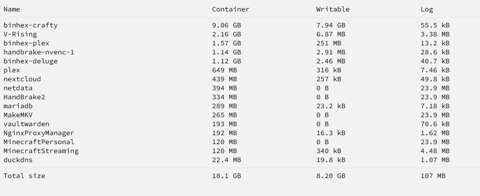

This is what I see when clicking Container Size, this does still lead me to think that it's crafty that's causing the issues, but all paths are okay as far as I can work out, so can't figure out what's causing it to bloat so often. When I thought I fixed the issue, my docker image size went back down considerably, but it's been slowly filling up again and it's at 93% at present.
Thanks, - Myles
I would install ncdu in the container and use it to find what's taking that much, and either fix that if possible or add a separate mapping for it.
