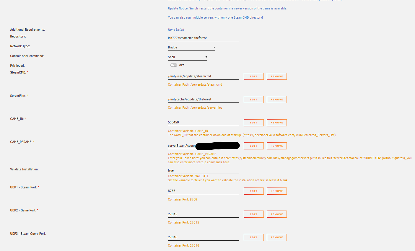

  11. I've turned off validation. So some progress, after resetting the server, the world data has come back, so structures that were build have returned, the next issue we have is that when people disconnect from the server, and connect again, they spawn in the plane with no inventory/armour/etc. So having my appdata set to Prefer: Cache, is this setting okay?
  12. Hi Ich, My app data is set to Prefer: Cache. And here is my template
