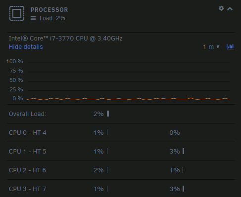

I can't see, if Hyperthreading is activated on my unraid server or not. HT is activated in the bios, but I can't see if HT is activated on unraid or not.
HT is supported by the CPU.
My Specs (I know it's an old CPU, but it's enough for the beginning):
Or is Hyperthreading already activated? Because I don't quite understand what "CPU Thread Pairings" are...
Thanks for any help!

If it was disabled you wouldn't see the HT cores.
Looks like it IS activated.   Thread pairings relate to a core that has an associated hyperthread so it appears as 2 logical cores.   If you are assigning cores to a specific task you normally want both the master core and its associated hyperthread for optimum performance.
Oh, okay. I guess, HT is activated then. Because the processor has only 4 cores, and with HT enabled, it should have 8 total Threads. And that seems to be true.
Thank you for your help!

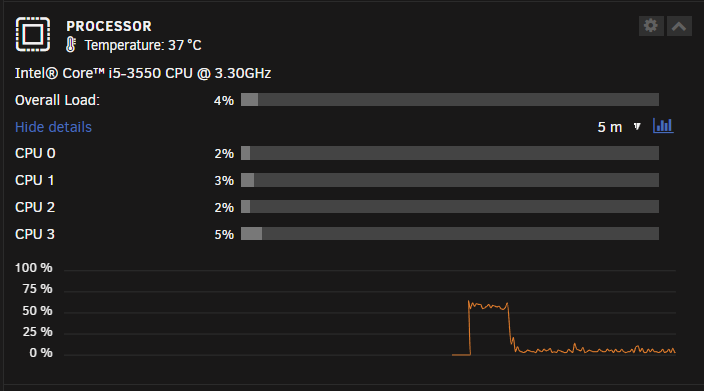

Although this thread is old, I think my issue is related. On my dashboard, I only see for cores but I should see the threads as well. Yet, here is what I see:
Is this an Unraid issue? Or a BIOS issue?
PS: Never mind. This cpu does not support HyperThreading. My bad haha (old piece of garbage...)
