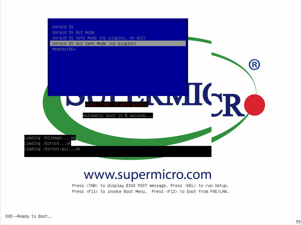

So I should have a console after booting up normally? My console has always looked like this after booting. Maybe it's my ILO then or something idk. I don't have any issues accessing the BIOS or the boot menu but I've never been able to see a CLI console, even on 6.9.
Edit: I rolled back to 6.9 and I am actually able to see a console now. I guess I only ever log on to this thing when the system fails to boot entirely, thus my confusion around the console situation. So, I logged in via the console and I still don't have any network. In the rollback, I replaced the bzroot, bzroot-gui, and bzimage files. I'm guessing the drivers are still on the newer version. I'll see if I can figure out how to get a diag off the system and attach it here.

When attempting to boot 6.11.3, I tried the normal boot, GUI mode, and GUI safe mode. All with the same results as the screenshot above. After rolling back to 6.9, the system was able to boot but I had to go in and manually repair my network config. That is when I realized that 6.11 wasn't booting at all. I had assumed it was an issue rendering the console in my ILO but now I believe that the system just isn't booting at all.
