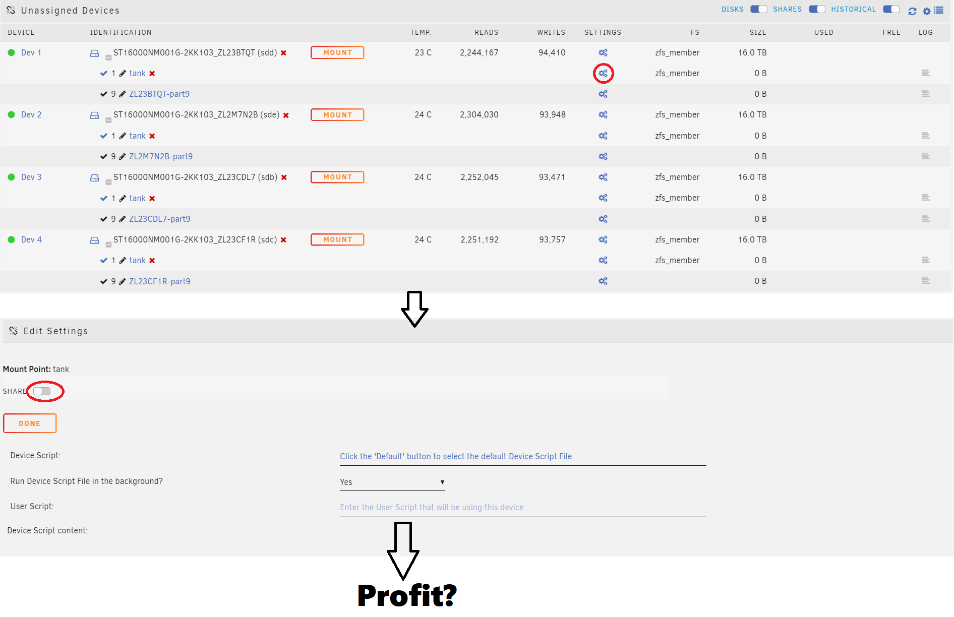

To clarify, are you talking about going to Unassigned Devices in the Main tab, selecting the gear icon next to the ZFS device and enabling the SMB toggle?
If so, will this apply to the whole zpool or just the one disk or will I have to go into each device and enable that toggle? Also, will that enable smb for my windows machines to access the data already stored on them?

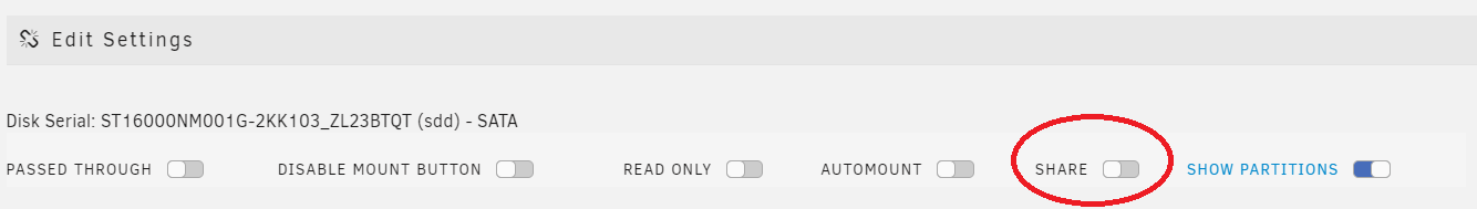

As a follow-up, I also see that if I select the gear toggle for the tank partition on the device I get a "share" toggle for that as well..
you got the idea 🙂
Was this what you were looking for ?
(never had a zfs pool to share, so I don't know if it means the whole pool or only part. give it a try, you can't break anything with these experiments (unless you format the drive). But I think it means ALL zfs member disks at once)
On the face of it all, yes! This is what I was looking for. However, I enabled share on both the disk itself as well as the tank partition and applied the same for each disk but they still do not show up in the network share. I also restarted the array as well as rebooted and it is the same thing.
I also read through the Unassigned Devices topic about the plugin itself and I THINK that should have done it, but well, nah
hmm, i'm not sure but I guess, you should only share the "tank" thing. Sharing the Disk may result in security problems. Usually you only address a disk directly if you try to pass it on to a VM or so
One note: I don't think that unassigned devices uses the same "share" folder than the unraid os. I don't have an unassigned disk currently to play with. But I guess I remember that for each filesystem you can switch on automount at boot time seperately too.
I've set the array to autostart. I removed the disk share as well. Seems you are correct, unraid doesn't use the share tab for zfs. Interestingly, when I share the tank partition the disk itself updates to shared as well. I'll continue looking through things and report back if I find something else or other odd behavior. Thanks for the help :)
