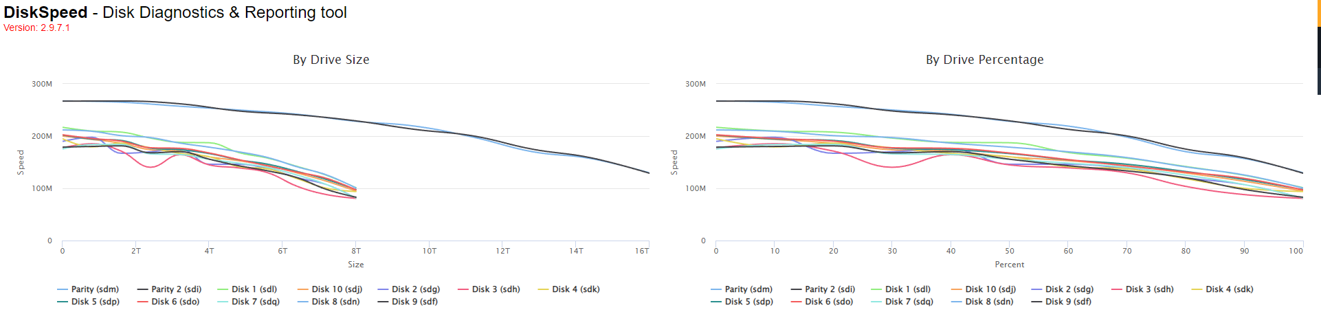

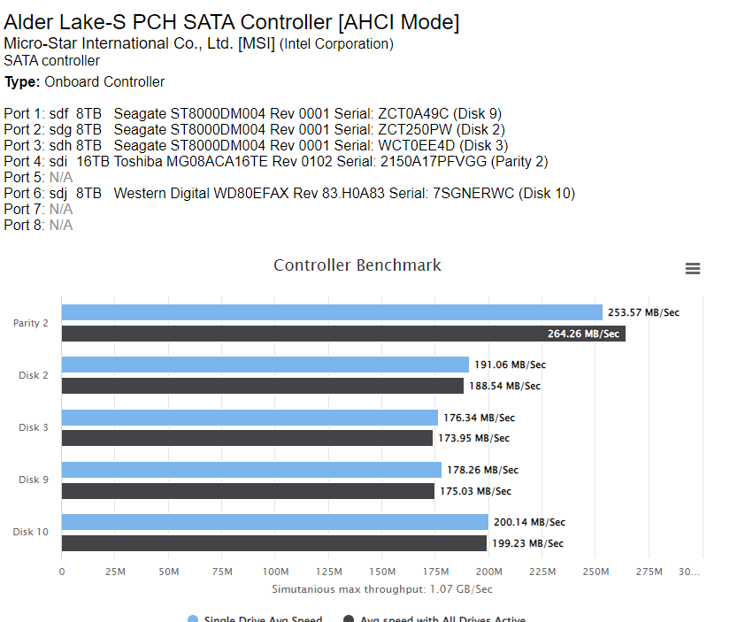

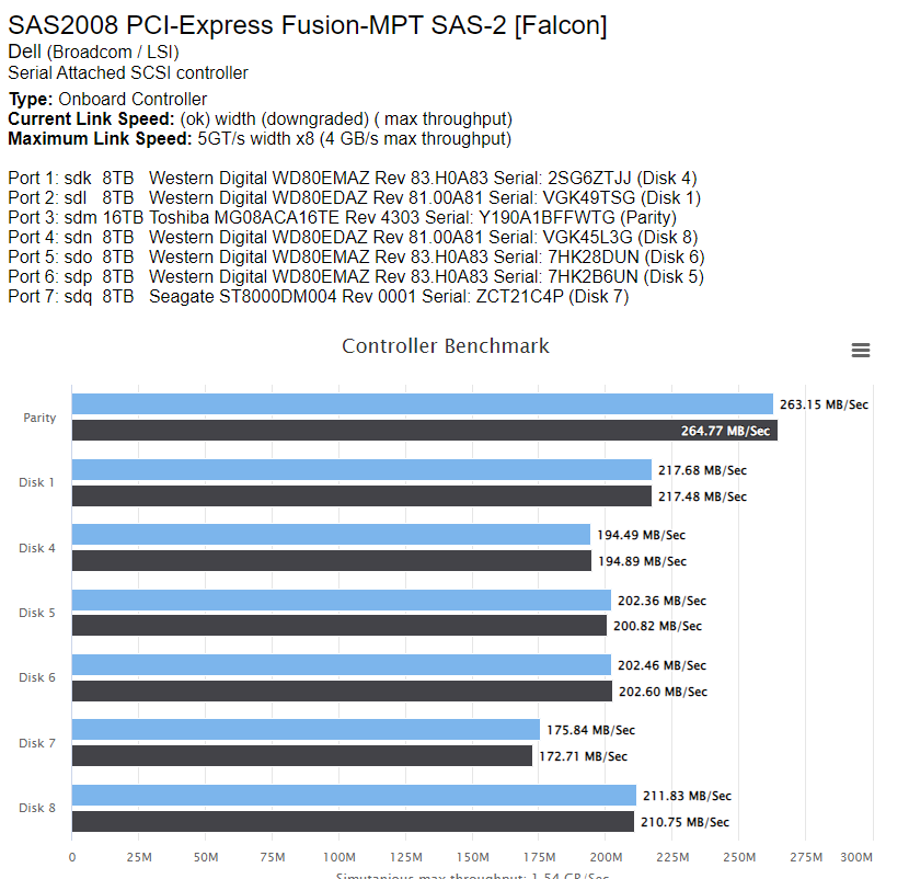

Run the diskpeed controller benchmark, to rule out any bottlenecks there.
Everything there looks good. The only thing it seems I can't test is an external USB 3.2 enclosure with a couple of drives in it. While that might sound crazy, I tested it extensively when adding it about 6 months ago and it's seemingly working fine. Unless maybe there were some USB changes in one of the latest point releases?
