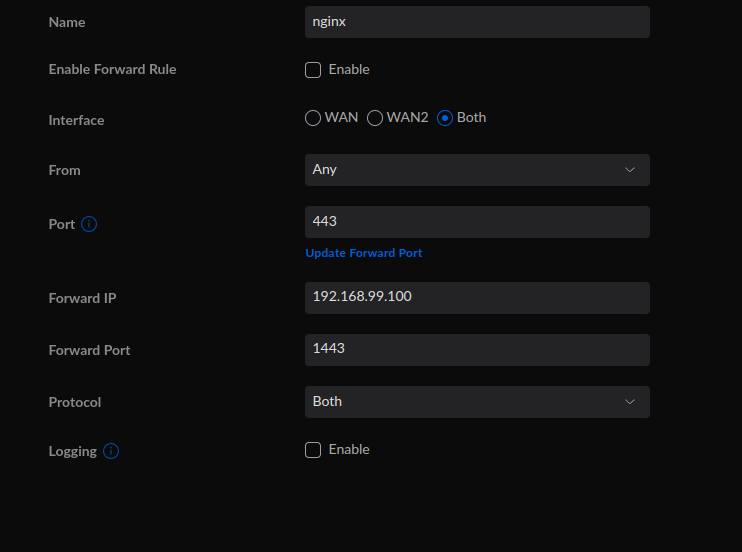

On 12/3/2022 at 1:49 AM, juan11perez said:
@aymanibousi
I just noticed your unifi port forwarding is wrong.  Should be like this:
You forward 443 to the port on your server, in your case 18443
