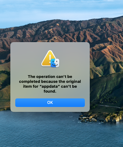

Hi , I have unRaid running and seems to be running fine , however when i try to go to the appdata , i receive the attached error. Therefore i am only able to amend  or look at any of the folders.  I am unsure what i done as dockers seems to be running fine.
Any help or advice would be appreciated.

See if you can access it locally, usually due to many different permissions inside appdata you might not be able to access it over SMB.

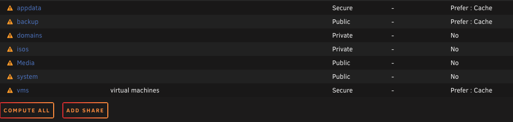

  Hi, Thank you  for your reply I can connect locally  , I was able a few weeks ago , however i did notice  a warning sign which  i am unsure what it means ( please see below) I was
wondering if this has something to do with it. Could you advise as i newbie.
Thanks
946473007_Screenshot2022-12-09at09_08_40.thumb.png.3cad92de1bc4d70c7b287e0b6a0774e8.png
That just means at least part of that share is not on protected storage, normal if you have a single pool cache.
It probably means that there are files in an unprotected Pool or Array.
Your diagnostics could confirm this.
