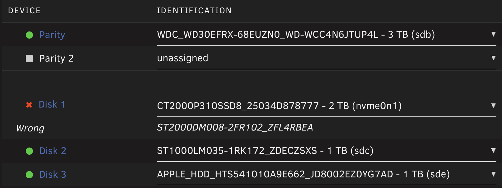

How to replace 2TB HD with a 2TB NVME SSD
OK so i will get a new 3.5 3 TB to replace the seagate 2TB would be the best option? I have attached the diagnostics . pine-diagnostics-20250522-2017.zip
Hi I ma tryimg to replace an error strewn Seagate 2TB with Critial P310 2TB . The NVME SSD appears in the dropdown when i select and reboot i recever a message that it The replacement disk must be as big or bigger than the original. I am trying to replace the original. I assume that i cannot install like for like size 2TB it must be larger ? I currently have Parity Drive 3 TB , 3.5 2TB , 2 x 2.5 1TB which is sufficeient for my needs at the moment . Do i have to remove the Seagate 2TB ? Any advice would be appreciated
