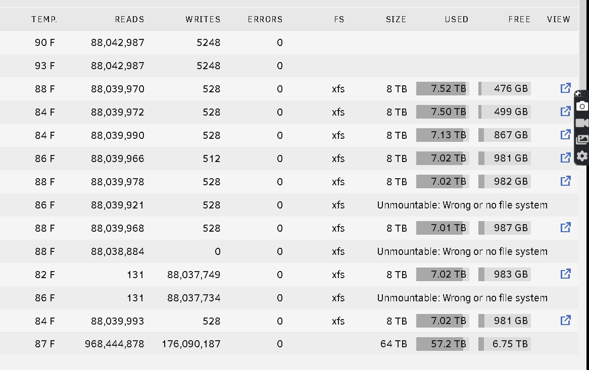

had a nvme ssd short out on mother board.  so i removed it so now i start up computer everything works except for three drives 6 8 10 now i rebuild  6 and 8 thinking its a issue with the power failure then getting a bunch of read errors from all three drives i think hba may have gotten bad cable or shorted out not sure how to figure out which one it is so i plugged those three drives into the mother board and now only drive ten is having issues so i replaced drive 10 but now all three drives   are uncountable how should i proceed

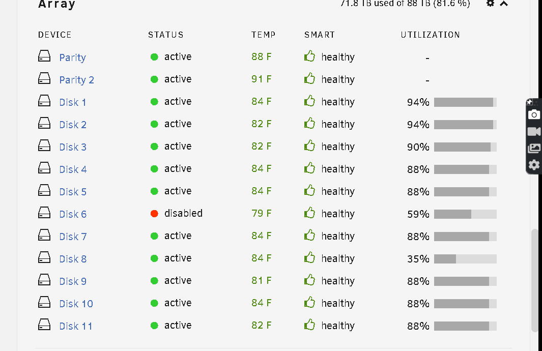

so checked filesystem lost some data not worried about that. and everything was fine then i did party check and now drive 6 is disabled so not sure what changed maybe  i have a bad cable or a bad hba card here is smart log for drive 6 thanks for the help
tower-smart-20221211-1922.zip
Looks more like a power/connection issue, check/replace cables and if the emulated disk still mounts and contents look correct you can rebuild on top.

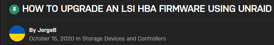

Is there a way to do that in unraid. The last time i firmware upgrade on lsi card  i bricked it somehow it won't boot anymore is there a utility or bookable software to do it any guides would be helpful as this card is expensive.
That's literally the title of the thread linked by JorgeB :
yeah i forgot underline is link cant find the right firmware for my LSI 9300-16i 16-Port and the one i did find isn't new its from 2019
