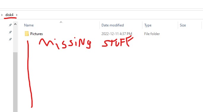

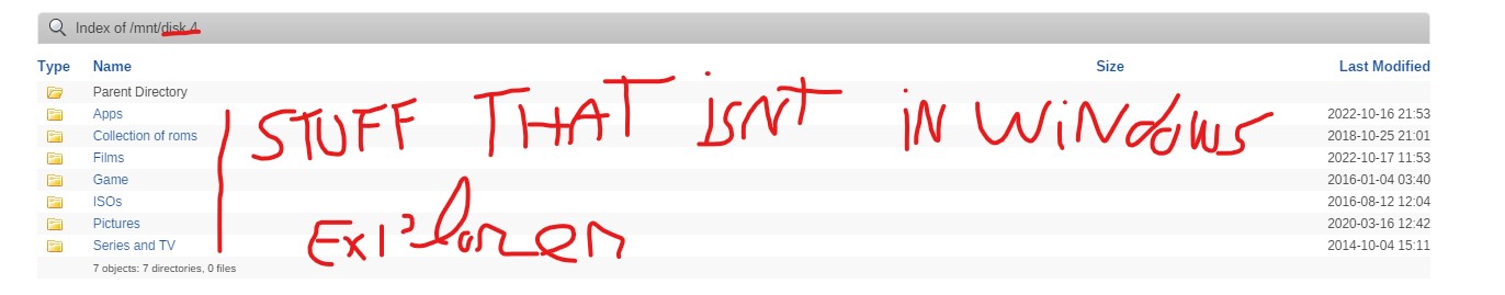

The problem is that the missing files aren't visible in windows explorer but are "visible" through the webui. They are accessible via the Shares but not the disks. I want to transfer all the data from disk 4 to another because I'll be shrinking the array.

OK, I think I see the problem, you have a disk4 share, that means there's a folder called disk4 as a top level share in one of your disks, you can find find out where by going to Shares -> Disk4 (in user shares, not disk shares) -> Compute

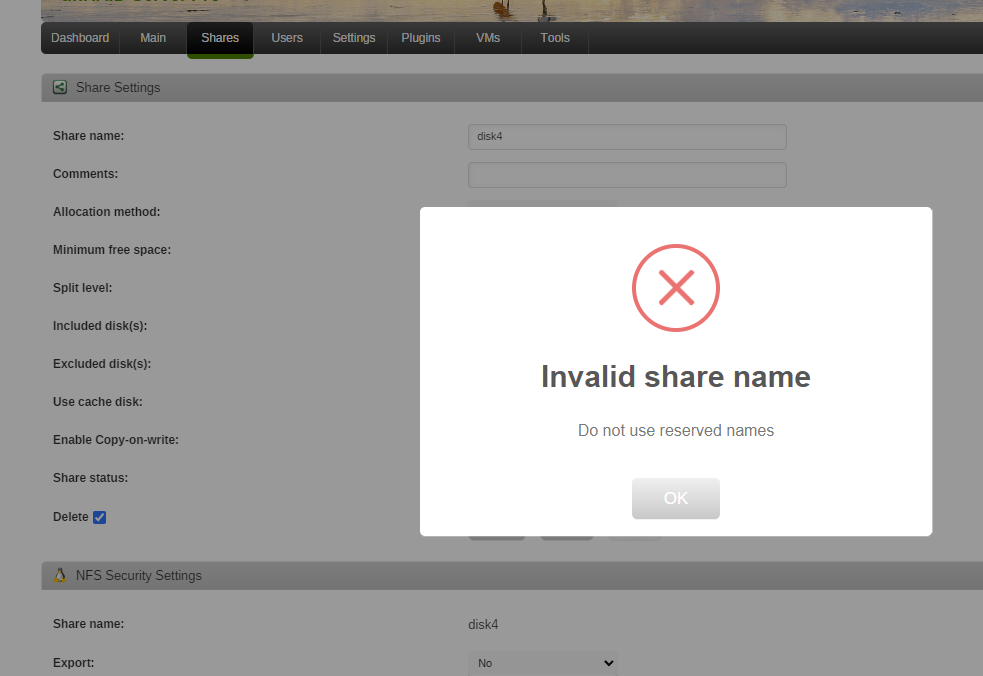

Ahah, thanks! Now I'run into another problem, when I go to the share page to delete the share, it does this when I press apply to delete:
Nevermind, I simply renamed the share before deleting it and that seems to have worked
