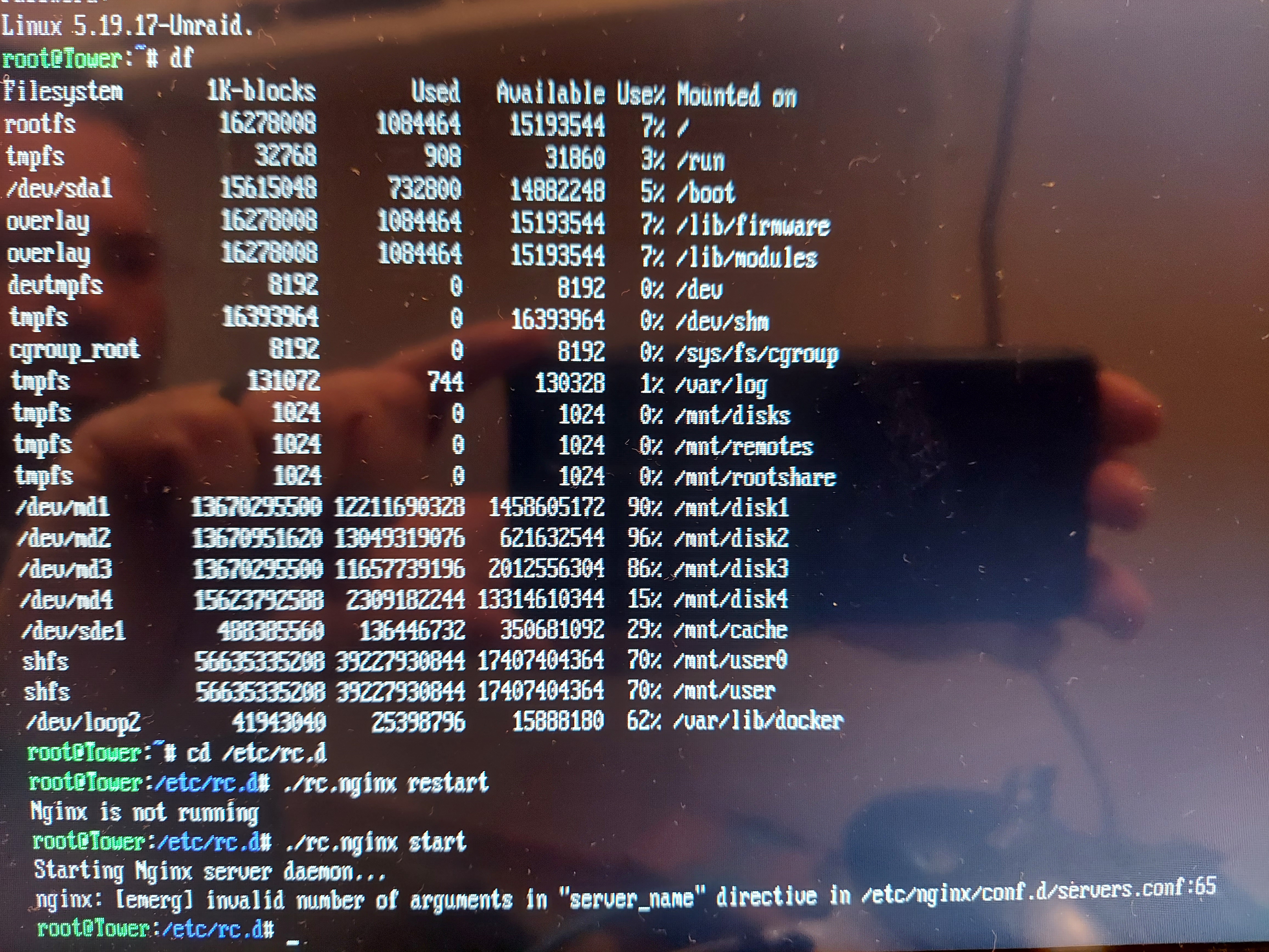

I've been scouring the web trying to find how to manually start the webui and I found a thread on here about someone else's struggle and things that worked for them (

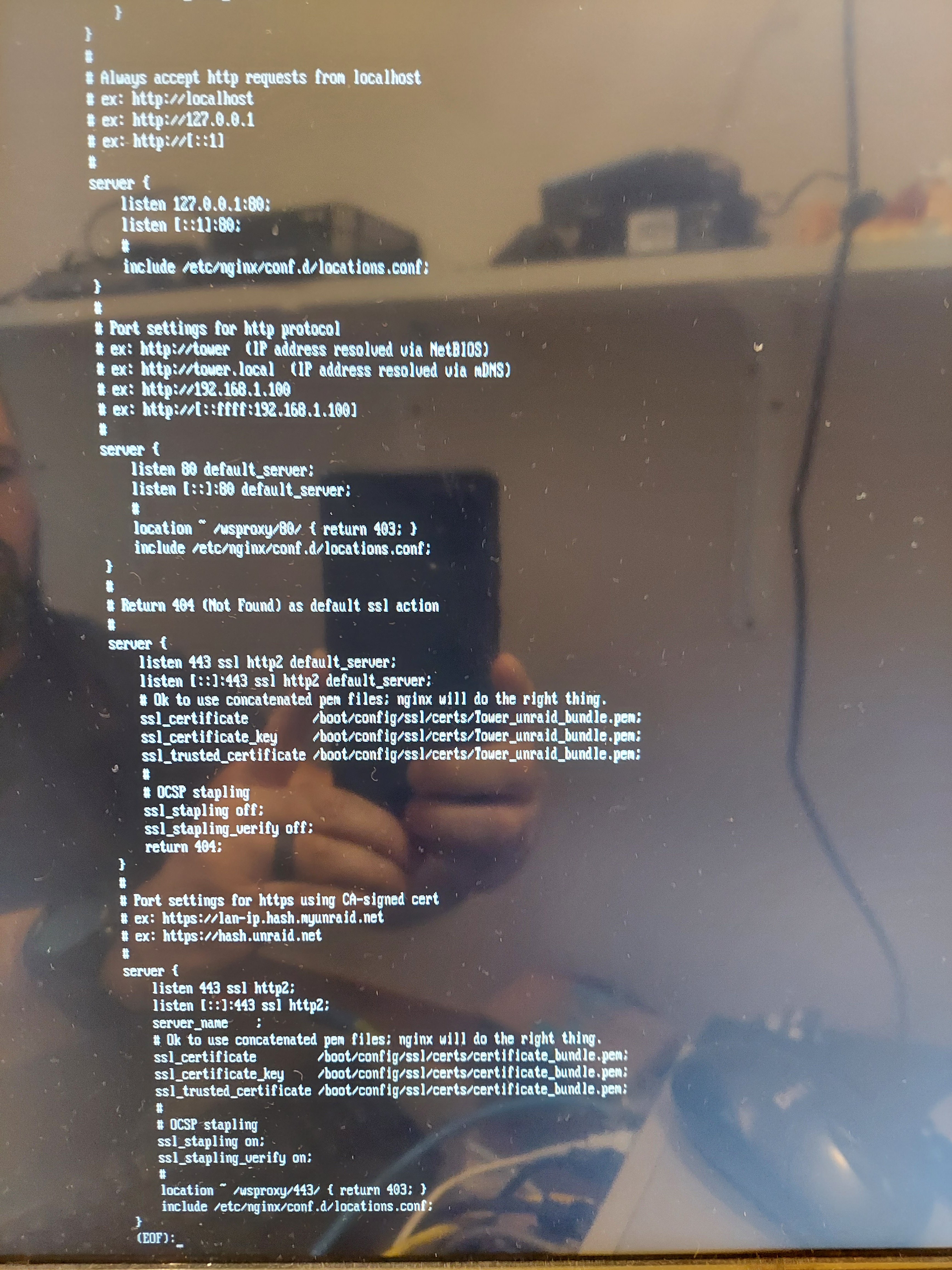

I tried to perform the command /etc/rc.d/rc.nginx restart but my results were "Nginx is not running".  So I tried Nginx start which told me  'invalid number of options in "server_name" directive in /etc/nginx/conf.d/server.conf:65".
So I took a look at the file but I find there is nothing in the server_name.  It is just a [tab] followed by a semicolon?
What should I edit this line to be?  Is that my only problem?  How did it get messed up to begin with?

I had a look at your Diagnostics file.  I noticed that you have two NICs on your setup.  You have a Cable connected to eth1 and no cable to eth0.  I am no Guru but back in the 'olden days', the primary GUI port for Unraid was eth0.  I would try switching the cable to the other port.    (You could also try a second cable to the NIC port...)
Yeah the issue is that eth0 doesn't have an ip address and that is needed in order to use a myunraid.net cert. If you don't want to swap the cables around...
At the console, type:
rm /boot/config/ssl/certs/certificate_bundle.pem
use_ssl no
Or if ssl is already disabled, do:
/etc/rc.d/rc.nginx reload
Hopefully that should get the webgui to load again.
Then go to Settings -> Network Settings -> Interface rules and reassign things so that the nic that has an ip address is recognized as eth0. Once you have an ip on eth0 you should be able to provision a cert.
