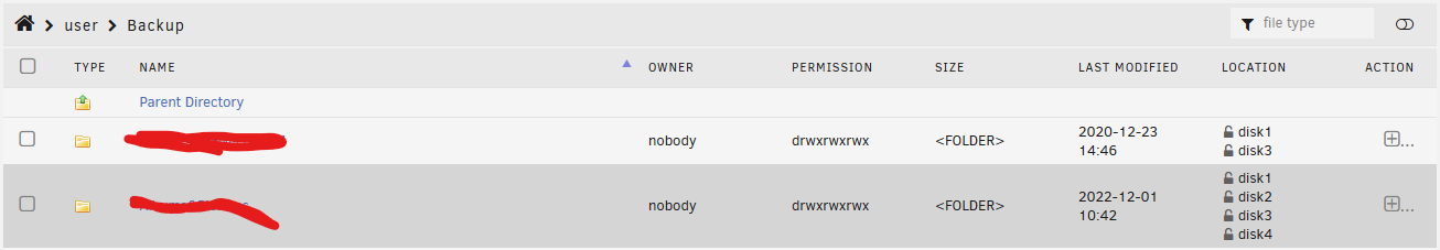

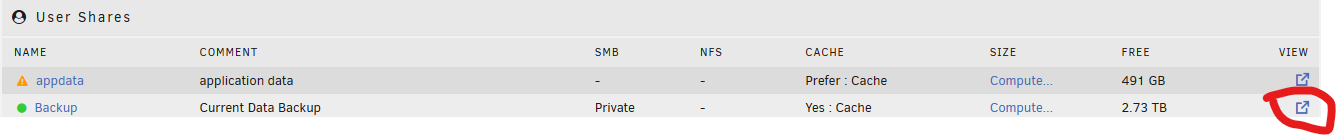

  2. You can actually see where which disks have information stored on your server for each share.  You can get to it on the Shares tab by clicking where shown below:
    That will give you this:
    (I have the 'Dynamix File Manager' installed and this may well be a functionality provided by that plugin.)  You can see where  each directory has data stored and which disk each file is on.
