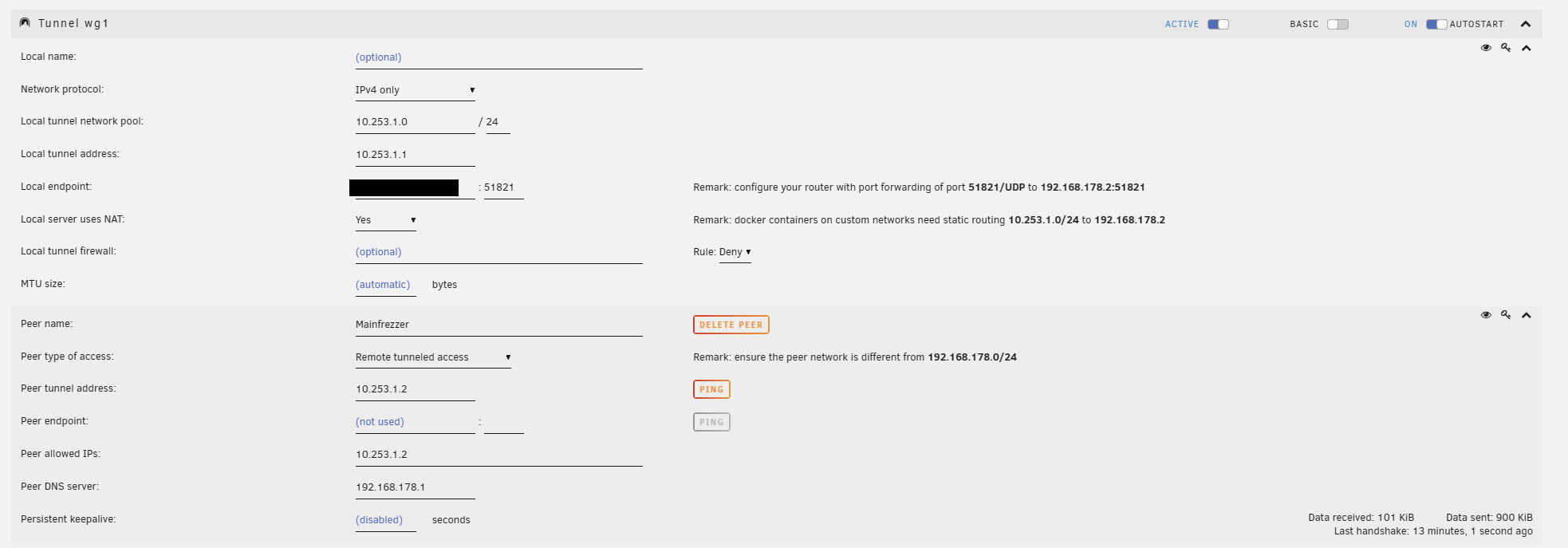

Here is my solution to that Problem.

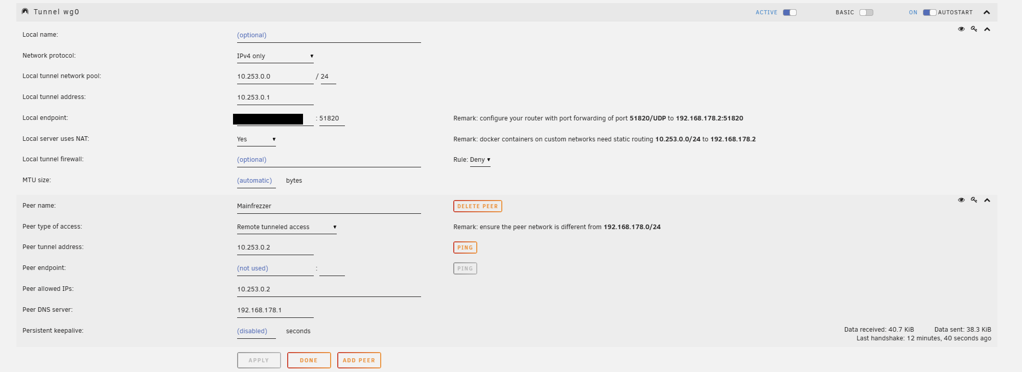

First, the "standard" tunnel access. No further steps on that.
This just guarantees access via the tunnel in case the Array/Docker-Server didnt start at all. !IMPORTANT!
Secondly. We gonna add another tunneled access to the Server. The recommended options are fine.

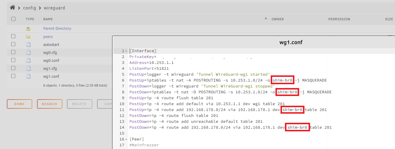

Now we need to manually edit the wg*.conf, in my case wg1 and change the adapter from br0 to shim-br0.
And thats it. Now you always got 1 tunneled access to the Server incl. all Docker-Container and access to the internet. The tunnel, that got modified to the shim-br0 network is the one that has all access while Docker is running. The wg0 interface is in this example is the "oh shit, something is wrong" connection.

I havent tested ipvlan since, well, my router cant handle it. But since ipvlan still uses the old method (having 2 tunnel just in case), you have to do it manually. Dont use the VPN Manager to make changes, because they alway overwrite the file. Stop the tunnel, navigate to the flashdrive, edit the file with the "Dynamix File Manager", save it, switch back to the vpn manager and just start the tunnel without saving anything.

Setup the first, "Emergency tunnel" which always works when the array is offline (That you can do completely over the vpn manager interface)
then setup a second one "Normal tunnel" which only works when the array is running. (Apart from the initial setup, never save changes in the vpn manager in there, only manually with the file manager plugin, since it removes the shim- from the interface)

I assume you mean that you can reach your pi-hole from your vpn client? Absolutely, if you have the "Host access to custom networks" enabled. The wireguard file for that tunnel just needs to be changed from the default br0 to the shim-br0 as mentioned in the first post.
I tried enabling host access to custom networks and confirmed i have shim-bro in the config file. And i still cant access the custom ip docker containers nor the internet. Also im running Pi-Hole in a container on unraid so when i manually change the dns entry on my iphone to 1.1.1.1 i can get to internet and unraid server / some containers but cant access the custom ipvlan containers still.
It looks like every time i add a new peer to try different config that shim-br0 gets reset...
yep. everytime you do something in the gui, it resets to the "default". You would have to create your clients etc beforehand and then stop the tunnel, edit the file to the shim network, start the tunnel.
