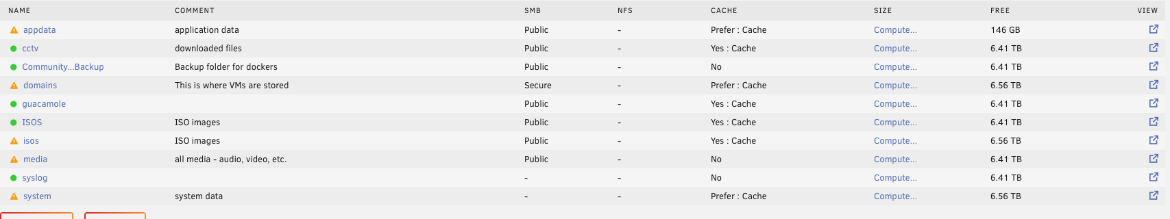

Here are my cache settings:
This is similar to this post but the resolution involves changing cache settings (based on advice in 2018) and I can't find this in my current version settings to see if this is the issue.

But looking again at your first screenshot it seems your domains share is set to cache:prefer. How much stuff is in there? Prefer will make mover try to move everything in that share onto the cache everytime it runs, likely your cache is too small to fit your VMs and it fails each time.
Click the "Compute" on the domains line (or better yet, "Compute All" button at the bottom) on the shares page and post a screenshot.

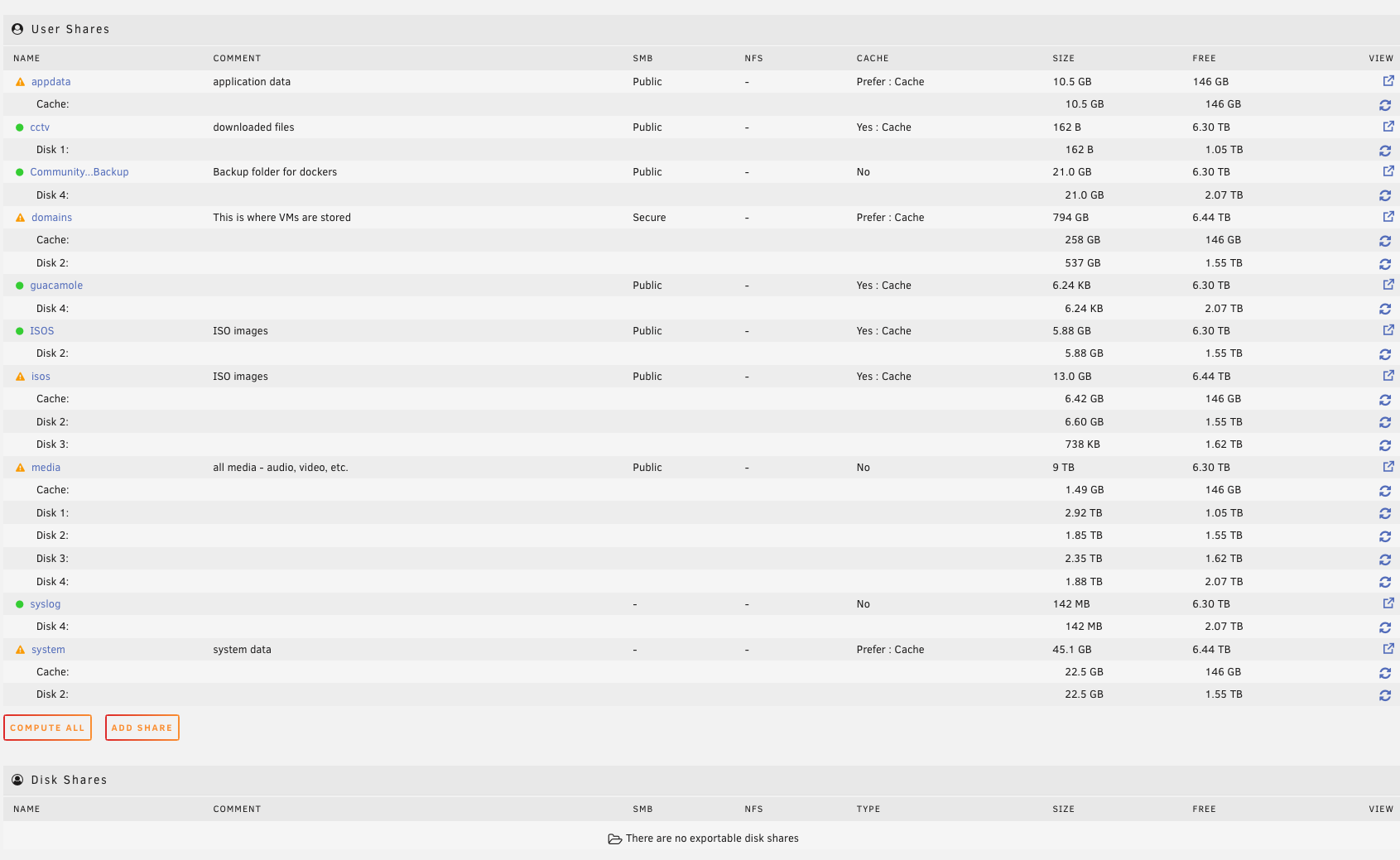

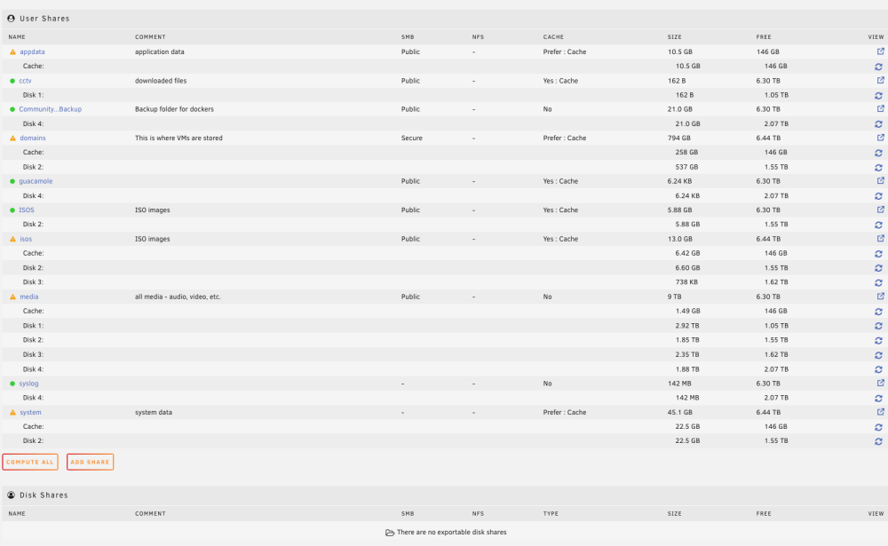

@Kilrah Thanks, I clicked the compute all and the results are attached.  Also, don't know if it is useful but I have a spare SSD (249GB) connected but currently unassigned.
So yes, the domains share has 537GB on disk2, and your choice of Cache:Prefer causes the mover to try to move that to the SSD that only has 146GB free.
Set it to cache:no so it leaves things as is if that's how you want them.
Your system share likely also has duplicate files on both the cache and disk2, if the files on disk2 are older you'll want to delete them.

In your screenshot above that shows disk usage for system share.
