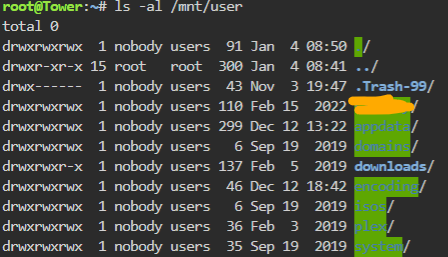

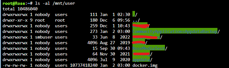

Run the following command from the terminal  that is a part of the GUI:
ls -al /mnt/user
This will give an output that looks like this:
You then push the <UP-ARROW> on the keyboard.  Edit (by adding to) the path and navigate down to the directory which has the problem.  (Capitalization is important with Linux.  IF you have a <SPACE> in a directory, you must type a      \           before the space!!!)
Do a screen capture of the directory with the problem.  (Screen captures are preferred.  If you must capture text, be sure to format it as Code---   The   </>     on the reply format toolbar.)

downloads it he one that I'm having issues with and it does look like there's something different with it!
OK.  Now run that command on the downloads directory. Post up the screen capture of that command.   Let's see what the permissions for its contents.
