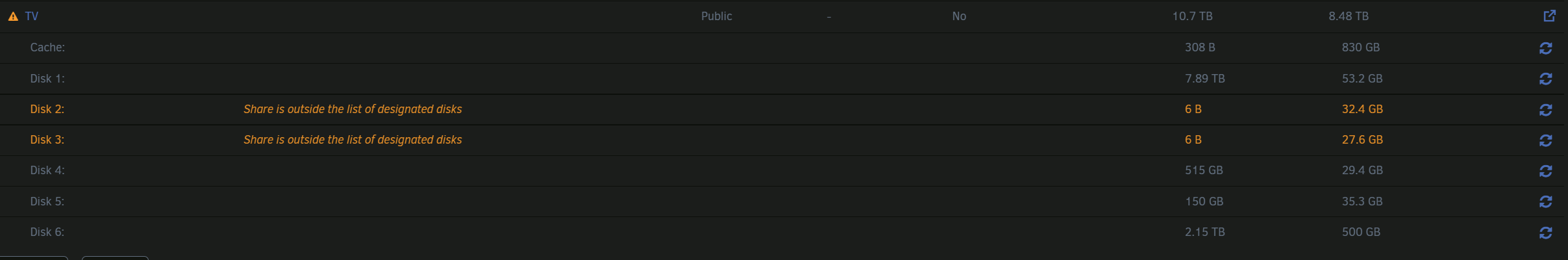

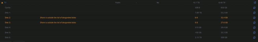

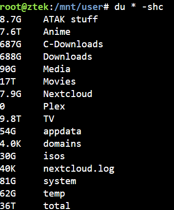

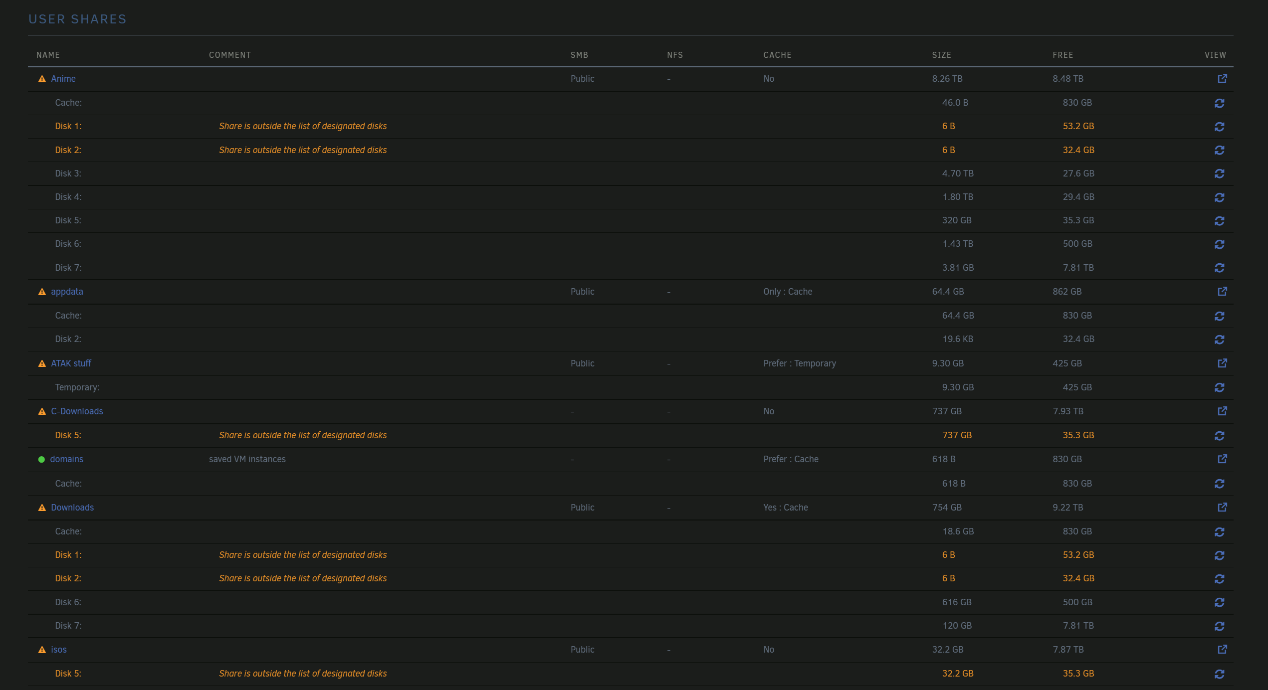

zorvok Posted January 6, 2023 Share Posted January 6, 2023 Need some help or advice. I've noticed that the Unraid GUI shows my drive space being more used than what I see running DU -shc through the CLI. Disk 1 Entire Array If I'm reading this correctly I should have 3.5TB more free space than what Is being shown. Or is there something else going on that I can't see with DU? Quote Link to comment

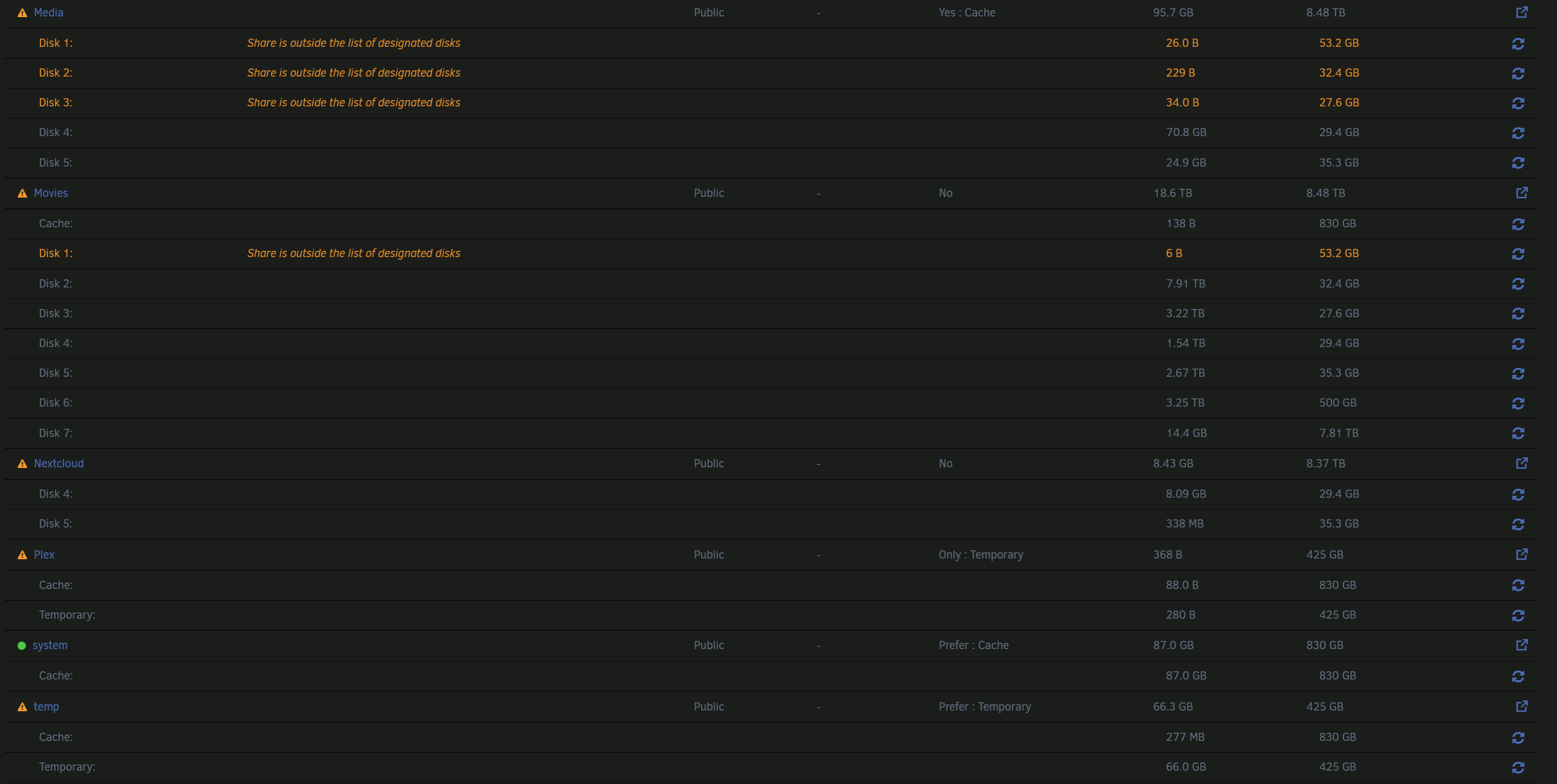

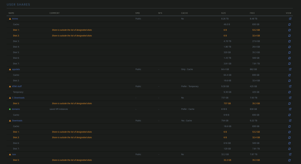

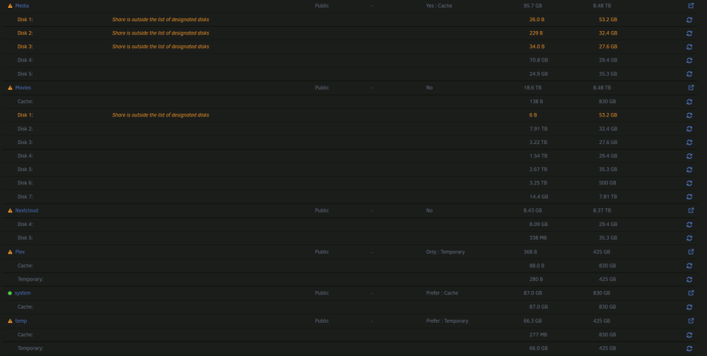

itimpi Posted January 6, 2023 Share Posted January 6, 2023 Not quite sure what we are meant to glean from your screenshots? A more useful screenshot would be to go to the Shares tab and then press the Compute All button so we can see what is on the various drives. Quote Link to comment
zorvok Posted January 6, 2023 Author Share Posted January 6, 2023 The screen shots show, that if I run a du -shc on disk 1. It shows there's 7.2 TBs used, while the GUI shows 7.85tb used. like wise, for the entire array du -shc shows only 36tbs used while the gui shows 39.5tbs but here's the other screen shots you've request3e Quote Link to comment
Solution Kilrah Posted January 6, 2023 Solution Share Posted January 6, 2023 (edited) 5 minutes ago, zorvok said: like wise, for the entire array du -shc shows only 36tbs used while the gui shows 39.5tbs du shows TiB, GUI shows TB. 36TiB=39.5TB. Edited January 6, 2023 by Kilrah Quote Link to comment
zorvok Posted January 6, 2023 Author Share Posted January 6, 2023 3 minutes ago, Kilrah said: du shows TiB, GUI shows TB. 36TiB=39.5TB. Thanks! It all makes sense now. Quote Link to comment
