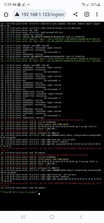

Hello! I woke up to 22 read errors. I think it may be a bad setting on my end but could I get someones input? Extended smart test passed with 0 error (attached)
I believe the screen shot of the actual errors are attached. Otherwise I dont know where to locate the logs for those disk error (I am new to unraid)
I should also note. On this same drive I received a UDMA_CRC_Error_Count 1 while pre clearing it on different computer and different sata cable.

SMART for disk1 looks fine. UDMA CRC error means the drive received inconsistent data based on checksum. This is almost always a connection problem, and the data is usually resent.
The SMART attributes are recorded by the drive firmware in the drive firmware, and can't be reset. This particular SMART attribute is almost never a disk problem, just something you need to take care of with the connections if you get a lot of them frequently.
You can click on the SMART warning on the Dashboard page to Acknowledge it and it will warn again if it increases.
Tools - Syslog, or the logs button on the main bar. This is only the current syslog (since reboot) since all of the OS is in RAM. Also, diagnostics includes current syslog, so I can see those errors there. Looks like parity sync had already completed before these.

Maybe it is set up then. Parity check still has a bit to go but I woke up with 19 errors on the same disk. I swapped both the power and sata cables between disk 1 and 2. So either the physical connector on the hdd is bad. Or I am guessing something else is bad. Im leaning towards trying to get it replaced.

20 minutes ago, JorgeB said:
It's logged as a disk problem.
Aka. Needs replaced?
Most likely, you can run an extended SMART test, though these errors can sometimes be intermittent.

Just rebuild the disk to a new disk, preclear optional.
