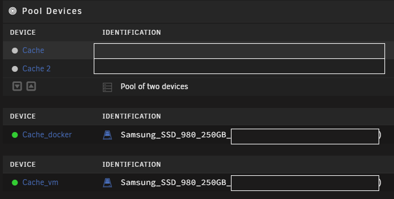

I'm pretty new to UNRAID. I have chosen this system because of its versatility. I'm very satisfied so far, but I'm still in the discovery phase. Therefore I would need some help and an optimal solution for converting my two nvme pool devices into RAID1. The main purpose of this is keeping my appdata safe(r).
Currently one drive is used for docker appdata, the other one is dedicated to VM (attached please see the structure of devices).

Are you current pools btrfs or xfs?
They are both xfs
1 hour ago, zoller said:
They are both xfs
XFS does not support multiple drives in the same pool - you have to be using BTRFS to do this.    Switching to BTRFS would involve first copying the existing contents elsewhere (e.g. the main array) and then copying it back after setting up the multi-drive pool as btrfs and formatting the pool drives.
Note that if you have a single drive pool already set up as btrfs you can add additional drives to it and/or change the RAID level without reformatting.
Clear, I'll do a backup and convert drives to btrfs, then change to RAID1 and restore. Thanks for your prompt replies.
